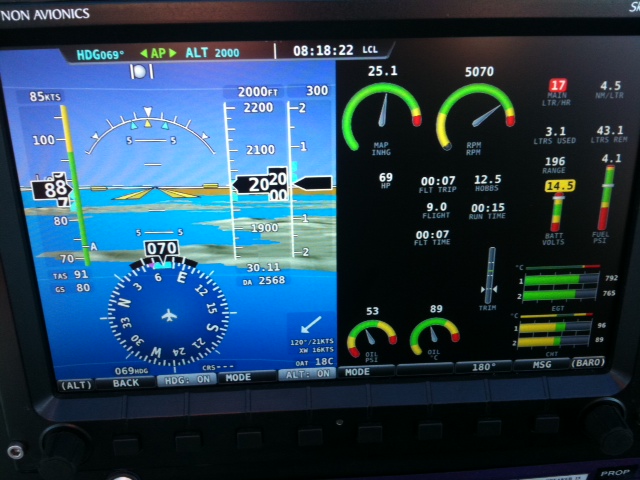

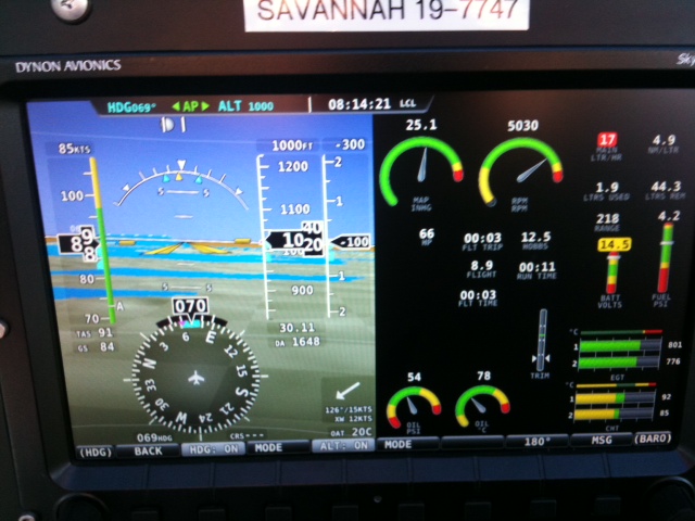

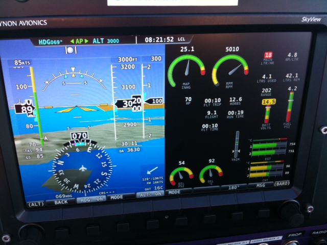

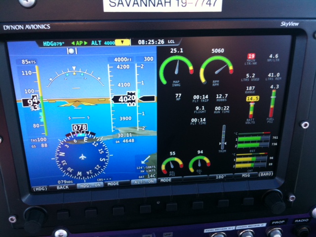

Gundy Posted June 28, 2011 Author Posted June 28, 2011 Here are some photo's of the performance through the Skyview. What I was trying to achieve was to see if the altitude compensating Carbs actually work. looking at the EGT. Now what I did was to fly at 1000ft at 25.1 inches of power level off take a photo then do the same at 2000, 3000 & 4000 ft. Have a look and maybe the experts can tell me a few answers. Why is the air speed at 88/89 from 1000 to 3000 but in the 4000 photo it's 93? some one said it is the constant speed prop doing a better job at altitude. Talking about the constant speed prop I set the pitch to do 5780 rpm straight and level and the plane was pulling hard through to when it hit the wall at 100 knots, wouldn't go any faster. So I thought throw the prop into auto and it should go a bit quicker, but all it did was change the fuel burn. At 5780 it was burning 26 lph then at 5000 rpm it went down to 22 lph. Another thing have a look at the horse power at each altitude.

Yenn Posted July 3, 2011 Posted July 3, 2011 Greg. I don't know how you have it set up but if you are reading TAS, you would expect speed to go up with height. The gear I have for my new plane will read TAS. Reckom I would like to have a fly in it.
winsor68 Posted July 3, 2011 Posted July 3, 2011 That is a beautiful Sav Gundy... I reckon 100knots would be plenty fast enough for a Sav... are there Savanah's that do more than 100knots flat out?
Kyle Communications Posted July 3, 2011 Posted July 3, 2011 Greg The dynon shows TAS 100 knots at 4000 ft GS at 88 knots...The centre of the waterfall display shows about 94 knots....what is this value represent? Mark
winsor68 Posted July 3, 2011 Posted July 3, 2011 Just had another look Grundy... so will say it again. Beeeeeautiful!!!!
Ultralights Posted July 3, 2011 Posted July 3, 2011 94 Kts is the INDICATED airspeed, True airspeed is taking altitude and temp into consideration, GS is speed over the ground.
cherk Posted July 3, 2011 Posted July 3, 2011 Quote Here are some photo's of the performance through the Skyview. What I was trying to achieve was to see if the altitude compensating Carbs actually work. looking at the EGT. Now what I did was to fly at 1000ft at 25.1 inches of power level off take a photo then do the same at 2000, 3000 & 4000 ft. Have a look and maybe the experts can tell me a few answers. Why is the air speed at 88/89 from 1000 to 3000 but in the 4000 photo it's 93? some one said it is the constant speed prop doing a better job at altitude. Talking about the constant speed prop I set the pitch to do 5780 rpm straight and level and the plane was pulling hard through to when it hit the wall at 100 knots, wouldn't go any faster. So I thought throw the prop into auto and it should go a bit quicker, but all it did was change the fuel burn. At 5780 it was burning 26 lph then at 5000 rpm it went down to 22 lph. Another thing have a look at the horse power at each altitude.[ATTACH=full]14284[/ATTACH][ATTACH=full]14285[/ATTACH][ATTACH=full]14286[/ATTACH][ATTACH=full]14287[/ATTACH] also check the X-wind and temp readings also!!!

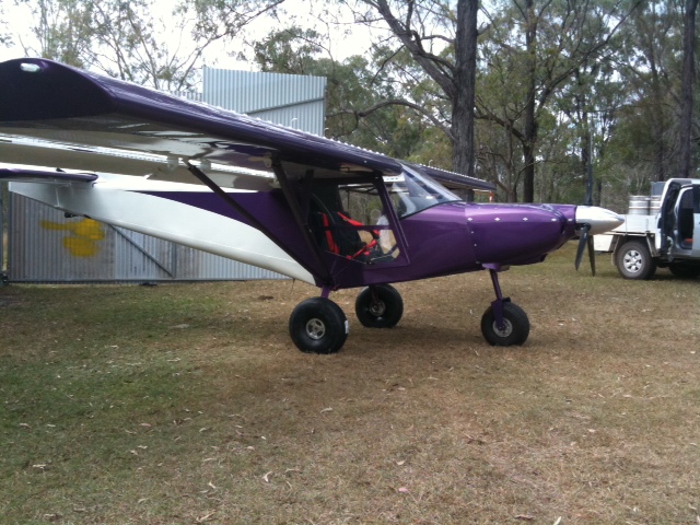

Gundy Posted July 5, 2011 Author Posted July 5, 2011 Would like to thank everyone for there encouraging comments on my plane. I've installed my HUGE 8.50x6 tyres the other day and couldn't resist a test fly. The 8.50's lift the hole plane up 2" so getting into the cockpit you have to lift your but a little higher, this gives a lot more visibility over the nose while taxiing. I have let the front tyre down flat and measured between the prop and ground which I still have 4" of clearance so I'm happy with that. Ground handling is superb, it is a little smoother while taxiing over rougher ground as the tyres soak up the bumps. In the air you can not tell the difference in handling, other than a loss of 2-3 knots of air speed. Here are a couple of photos.
Kyle Communications Posted July 5, 2011 Posted July 5, 2011 Hi Greg I would think the landings feel softer as well on touchdown. You have a proper tundra tyre and fork on the front dont you? The tundra front tyre is it the same diameter as the 600:6? Mark
Kyle Communications Posted July 5, 2011 Posted July 5, 2011 Greg Earlier you said the sav wouldnt go past 00 knots was that indicated or TAS
Gundy Posted July 5, 2011 Author Posted July 5, 2011 Indicated. It felt as though it was still increasing speed till it hit 100 then just stopped. Others might go faster mine is a little draggy with wheels. Yes I do have a Tundra and fork on the front. The landings are soft but that could be the pilot. hehe
