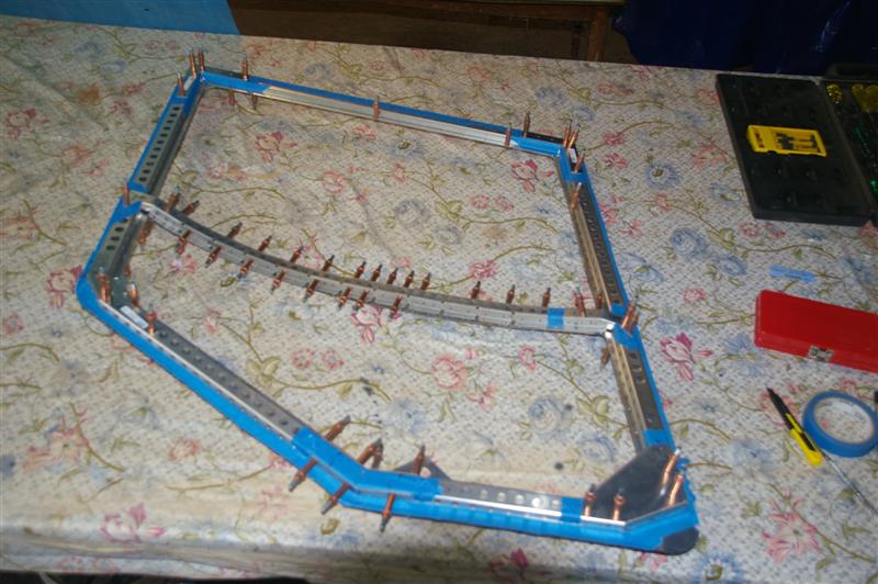

Got a door assembled and masked ready to dismantle and apply black goo. Masking is tedious but less so than cleaning the excess off afterwards.

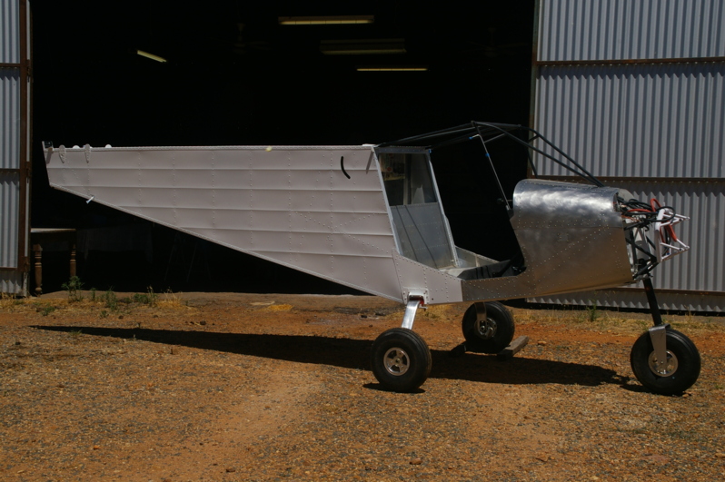

After a long absence ( or so it seemed) helping my son harvest those crops I reported helping him sow back in May, I am at last back to some savannah building. Have got the rear fuselage painted, mostly quite satisfied with the result, except for one small area which means one portion I will probably do again.Fitted the main undercarraige and then the wheels and eventually it was time to get it off the bench and onto its wheels. I've now got a bench to start constructing the wings on, in between more painting. All the other components are made. Some jobs like fitting the windscreen and fitting a fuel system into the wings are keeping me awake at night, but I suppose it will just be a matter of time and patience,lots of both probably.

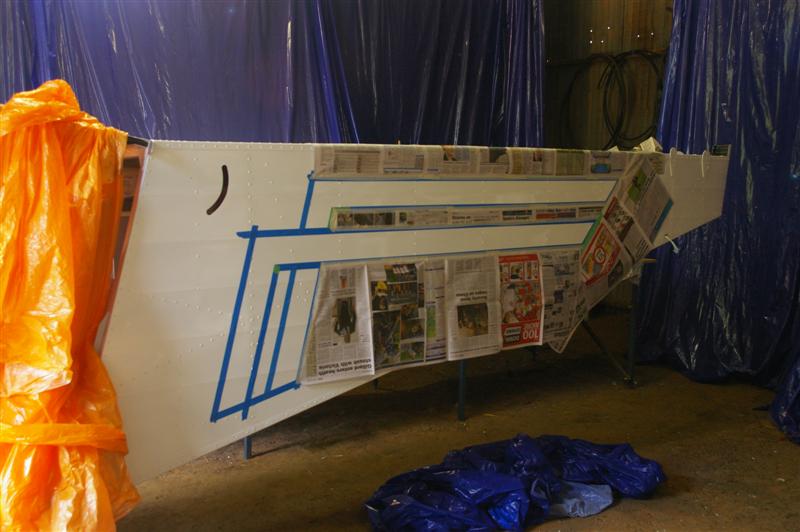

Well, a lot more work and a little more progress.Made up my mind on a design to break up that slab side a bit. Have to admit that it is not an original on my part but I didn't mind it, it was within my capabilities and I can live with the outcome. Quite a bit of work masking it up though; takes almost as long as the painting. Then to the right wing.All relatively straightforward until I decided to be a bit adventureous with the covers on the fuel tanks. I wanted to be able to remove the covers completely by screws/rivnuts rather than to have the forward edge riveted to the main spar. Decided to install a support along the front to carry the cover after cutting the front edge off the cover. This support goes between the lower skin and the spar. Then it required fitting rivnuts to the support and drilling the cover to match.(the original front holes having been removed), as well as installing rivnuts around the perimeter of both openings. Whilst the front edge does face the airflow it will be shielded by the nose skin which will sit a little further out. Took heaps of time but I am satisfied with the result. The fuel system will be quite simple. The two tanks are connected together and will operate as one and be serviced by one sight gauge, the other wing being set up the same. The two sides will feed to a tap junction where it will be possible to switch to left, right, or both. Hope the pics go some way to explaining my ramblings.Would love to be able to post the pics in a sequence of my choosing but is not the case.I'm sure you will sort them out. I can't even start a new paragraph tonight. Computors! I hate 'em. Now it's off over to the coast for a couple of weeks.Regards, Bob 1262424_IMGP3500(Medium).JPG.ae9c2067b4b11186a7e72ea47baa1224.JPG

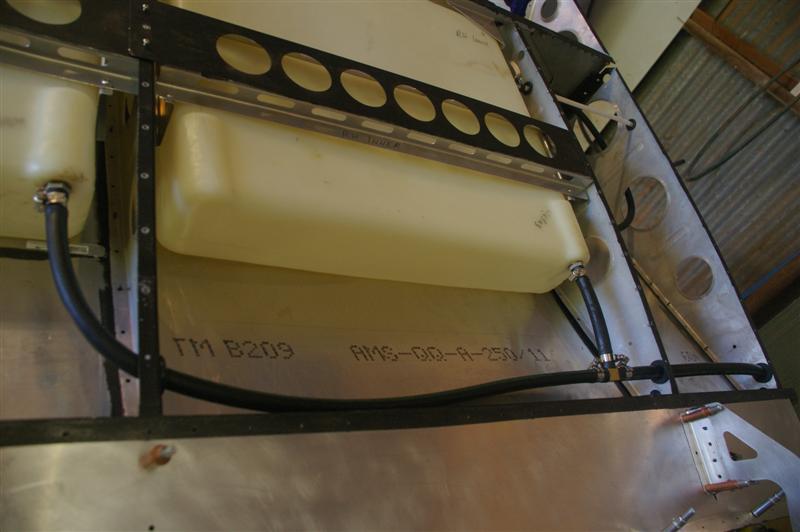

Apparently the newer factory planes with double tanks have a double width tank cover which probrably makes more sense, and may find it's way into the kits in future, pity they don't also have the second opening already cut in the skin too.
