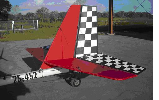

Guest Maj Millard Posted May 4, 2012 Share Posted May 4, 2012 USADrifter, I flew a 582 WB Drifter for 11 years. I am familiar with the bolt you mention. A friend of mine years ago had a similiar bolt fail right under the head once, (Eipper GT 400 aircraft) which allowed the foward section of the fin to lean to one side. He did make it down ok but certainly was in no hurry to repeat the experience !... There is some movement on the Drifter tail, and I also saw the potential for it to happen on the bolt you mention. What I did was to manufacture two cables with tangs each end. One tang went under the short -4 bolt on the U bracket, the other under the head of an adjacent bolt on the bottom of the boom. I covered the 1/8' cables with clear plastic tubing so they wouldn't damage the boom. This gave me a suitable backup should the bolt head fail. It never did of course , but better safe than sorry !...A real easy way to cover your arxx.........Sorry i don't have any photos......................................................................Maj... Link to comment Share on other sites More sharing options...
Guest Maj Millard Posted May 4, 2012 Share Posted May 4, 2012 Actually I do have a photo...you can see the cable clearly in the attached photo of my old Drifter..... Link to comment Share on other sites More sharing options...

Guest Maj Millard Posted May 12, 2012 Share Posted May 12, 2012 Great idea but I don't seem to see a photo here, am I missing something? Sorry USA Drifter, I have tried to upload the photo but it will not load, I'll continue to work on it though.............................Maj... Link to comment Share on other sites More sharing options...
Guest Maj Millard Posted May 12, 2012 Share Posted May 12, 2012 Finally here it is....................you can just see the cable below the fwd fin attach......the photo distortion is because I had to reduce the original photo size. Link to comment Share on other sites More sharing options...
