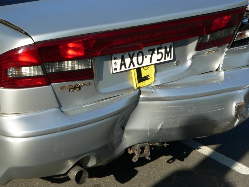

I can get a 2.5gen3 engine, just had 100,000 service done (runs smooth) Daughters car was rearended ,make an offer before the greedy insurance takes it away

Subaru Heritage My02 ,2001 build date,2.5 ltr, gen 3,106,000 klms on the clock, very well maintained as her son{senior Subi technician} does it at cost at work.
Only boot and bumper, it still drives straight. Her youngest sons 3rd driving lesson, and he was stopped at the time.
spacesailor
