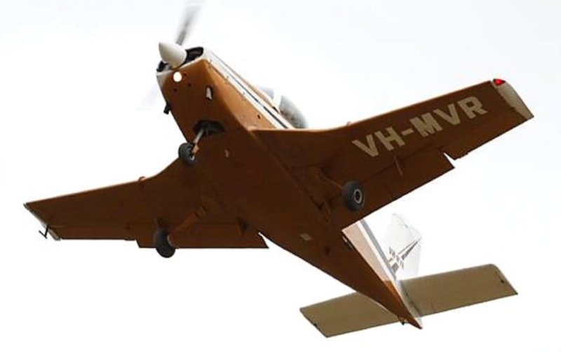

Old Koreelah Posted October 27, 2016 Posted October 27, 2016 Thanks for your efforts DJ, but perhaps there's been some miscommunication. Your post #35 implied the wing root cuff fixed the violent wing stall and wing drop. Your post #50 says the wing fence fixed it. Sounds like both posts are talking about the same feature. I'm interested in the aerodynamic effects of the triangular leading edge extension seen on the 4-seat Victa. (It's also seen on the P-51 Mustang and some larger Jodels.) 1

Old Koreelah Posted October 27, 2016 Posted October 27, 2016 Thanks for trying Bex, but no, I'm NOT talking about cuffs or stall strips (both of which I have fitted to my Jodel). As I have been trying to explain, I'm interested in the aerodynamic effects of the triangular extensions to the leading edges of several aircraft, including larger Jodels, the P-51 Mustang and the 4-seat Victa:

djpacro Posted October 27, 2016 Posted October 27, 2016 Quote Thanks for your efforts DJ, but perhaps there's been some miscommunication. definitely was, sorry Quote Your post #50 says the wing fence fixed it. Sounds like both posts are talking about the same feature.I'm interested in the aerodynamic effects of the triangular leading edge extension seen on the 4-seat Victa. (It's also seen on the P-51 Mustang and some larger Jodels.) Yes, my old memory mixed two data sets. The Aircruiser WT test report I have is the same wing configuration as the prototype - both wind tunnel model and flight test of the prototype displayed the same sudden stall of one wing. Fixed by the wing fence on the prototype.That triangular LE extension I call the wing root cuff. The one on the Aircruiser is bigger than the one on the T-34C - somewhere there is data on a wing like the T-34C with and without cuff - perhaps I will find it before long. My recollection is that this data shows the benefits in stall behaviour of the wing root leading edge cuff as used on the Nash Petrel here http://aviadejavu.ru/Images6/JS/Janes75/1/296-1.jpg this was based on the Kittiwake which had a straight wing https://doc8643.com/static/img/aircrafts/3D/KITI.jpg Prototypes of both flew so must be data on them somewhere too ..... https://www.flightglobal.com/FlightPDFArchive/1981/1981%20-%203419.PDF ...... https://www.flightglobal.com/FlightPDFArchive/1967/1967%20-%201297.PDF The root LE cuff is fairly common http://www.zlinaircraft.eu/galerie/slider/slider-26.jpg wish I could find the data The following link for wing design, generic and specific to T-34C is relevant but doesn't fully address your interest so I will keep looking. https://www.google.com.au/url?sa=t&rct=j&q=&esrc=s&source=web&cd=7&cad=rja&uact=8&ved=0ahUKEwiK9JWs8_rPAhXGp5QKHY12AnYQFggwMAY&url=http%3A%2F%2Fwww.public.navy.mil%2Fnavsafecen%2FDocuments%2Faviation%2FSAS%2Faero%2FCH4-Stal.doc%3FMobile%3D1%26Source%3D%252Fnavsafecen%252F_layouts%252Fmobile%252Fview.aspx%253FList%253D8006e81c-b3d9-4e6f-a528-d2944db57cae%2526View%253D24fea1bc-5ae2-4542-a47b-901dc8d264d2%2526RootFolder%253D%25252Fnavsafecen%25252FDocuments%25252Faviation%25252FSAS%25252Faero%2526CurrentPage%253D1&usg=AFQjCNGir6y6kRJW7_CdV23m9Gkqq_69yg&sig2=5l_XF3_XD2SwoVGDRha41A All of the above was a generation before this stuff that you see on some modern wings Leading-edge extension - Wikipedia 1

JEM Posted October 27, 2016 Posted October 27, 2016 Wasn't MVR registered thus to recognise Mervyn Victor Richardson.

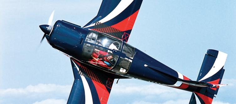

djpacro Posted October 29, 2016 Posted October 29, 2016 Quote I'll look at a Victa 115 wing to see what I can learn. You should see that it is a copy of the Provost wing. Different aerofoil sections root to tip combined with washout designed to give good stall behaviour - didn't quite work as inboard leading edge stall strips were required. The Model T-6 doesn't have those stall strips and, in my opinion, is stretching FAR 23 requirements for uncommanded roll at the stall.See page 13 of http://airtourer.asn.au/airtourer/images/Newsletter/Newsletter%20153.pdf (from memory, not quite right - it is a 23012 not a 2312) 1 1

djpacro Posted October 29, 2016 Posted October 29, 2016 Quote .... but I thought they were just fuel tanks. that's also my recollection - Henry wanted basically the same wing as the Airtourer but some more wing area and space for fuel in the Aircruiser.Regardless, I'd been looking for some sensible info on these cuffs wrt aerodynamic design of the wing/fuselage junction and effect on stall characteristics. Ideally, the local lift coefficient would be maximum at the outboard end of the cuff so stalls there first. But interference from the fuselage is significant and simple theory not really applicable. 1
