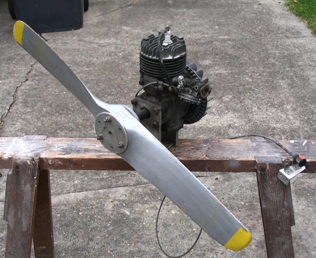

An update: Got the beast mounted, costing more time and money than it did to get the engine complete and of course, it doesn't run. I am now gonna try kitting the carby but I suspect the problem is in the piston/bore fit. I took the cylinders and heads off to see if the rings were free and they are but the compression still feels soft. Doesn't appear to have any cylinder base or head gaskets but it's not leaking either. I will make and fit some anyway just to be sure. No obvious bore wear or damage however. It may just be that the tolerances were bad to start with?
The pull start worked very well! As suspected the inertia of the prop carried the engine past compression - albeit not great compression. The cord has since broken though. It was a bit shabby to begin with. The engine would run for a second or two if I dried the plugs. Fuel is getting into the cylinders (and dribbling out the exhausts) but not wanting to fire. The spark is good.
A spot of crankcase porosity was found and subsequently sealed. Doing so has made no difference.

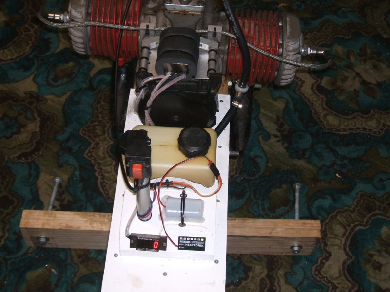

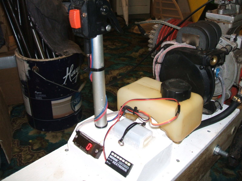

Pics shown use of whipper snipper fuel tank and throttle and model plane tacho and battery voltage meter.
Throttle assembly was useful for having a fail "safe-ish" spring loaded throttle lever. That is when released it goes to idle and not flat out as a simple friction system might. Also the stop switch is used. The "run" and "stop" positions are in fact reversed as the switch is used to close and complete the circuit to run instead of closing only to short out what would have been magneto ignition. Another feature I hoped would be useful is the throttle lock that hold the throttle at about 1/4 throttle for starting. All these things have been quite useless so far, time will tell though.
If it doesn't run after carby kitting and gaskets a rebore/piston/rings may be needed. Not sure I want to spend that kinda money and the cylinder walls look pretty thin to me already.
I haven't looked at the reeds recently but when I did previously they looked ok - no cracks, stting flat. Having said this I had chats with a mate of mine and he told me of a 125 moto-x/trailbike he had years ago. He said that when it came time for a rebore he did this and it of course ran great afterwards, much better than before as expected. When asked if he had replaced the reeds too he said "no, they looked fine". They were fine in that they worked but that is all they did. At someone's insistence he replaced the apparently "ok" reeds and the bike was again massively improved.
Makes sense to me now that I know this. I guess reeds by their very nature and the job they do in their working enviroment are going to fatigue and change with age/use. This is what I like about projects like this, especially this Skylark twin that I'm messing about with. I have been wrong about several aspects of it already and have learned a great deal about engines from it. It's probably better that this engine continues to throw challenges at me. If it had worked and run properly from the outset I would have learned little or nothing.
Now to source new reeds. If I can't find any I can make them.

Thanks for the info! Yes mine has cast iron cylinders (with steel liners?) and a Tillotson carby. Some time back I kitted the carby with genuine parts still being made (in Ireland now). It also had the disgusting (useless) Victa twin ignition that I have removed including the fin-less Victa flywheel.
Previous attempts to get this engine running have failed to produce more than a few consecutive coughs - the compression felt pretty low as I recall. When the weather improves I hope to re-visit it to get it running. I have got new head gaskets to fit (Victa 160cc same bolt spacing) and need to make and fit some lower cylinder gaskets and fix the pull start that died. Also need to replace at least one of the reed sets as some bored f*#kwit thought it would be good to make origami out of one of it when I had them out of the engine to try to find replacements - I am reliably informed that new reeds work much better than old ones even if they aren't damaged in any way.
I don't like my chances but I will try to get it going anyway. If none of this sees it running I may get it off to someone more knowledgeable it may need a bore/pistons/rings rebuild? It is such a simple engine there really so little in it to prevent it from running otherwise. The notion of fitting a "Scout" propeller to it and having it work is encouraging though as that is the propeller I have been using and the only "loose" propeller I have!
