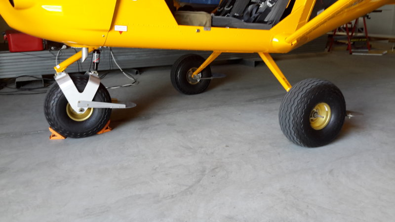

Downunder Posted May 21, 2015 Posted May 21, 2015 You were asking about the tundra tyres. Here's a pic. Don't get the impression they're massive, but I recon perfect for the aircraft size. Use the search function on this forum. Many threads about the Foxbat.   1

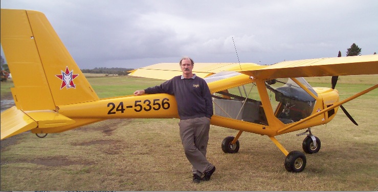

Downunder Posted May 25, 2015 Posted May 25, 2015 Nice photo. It that's the smaller fin, the big ones must look huge. I guess the tapered, narrow fuselage makes the vertical stabilizer look larger than it is. No, it is big....double the size of a few aircraft around.....As the stall is so low, it's really good to be able to maintain decent control at these low speeds. Same with the elevator. With a lightish pilot and minimal fuel, the stall can drop well down into the twenties (knots). Interesting you have electric trim Arthur. Didn't know it was available. I'm in the habit of using 1 stage flap on take off. A few different views around. All have valid points. I see it as one less thing to think about in a go-around situation. I do retract it pretty quickly but, at about 50kts...... And yellow is a good colour.....  1

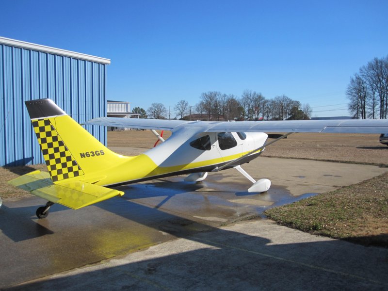

Guest SrPilot Posted May 25, 2015 Posted May 25, 2015 The GlaStar, an experimental homebuilt, also has a large vertical stabilizer and rudder. Makes it a rather stable aircraft and quite responsive if one has a spade on the aileron - only need one, not two. Neverthess, re stab size, everyone was always commenting on how big mine was. Â Â Â

pylon500 Posted May 26, 2015 Posted May 26, 2015 Interesting you have electric trim Arthur. Didn't know it was available. Of the four Foxbats I've flown, they've all had electric trim. I only know a manual trim is available from reading the assembly manual of the kit version. Sometimes think I would prefer a manual trim as the electric is quite slow, but at least I don't have to change hands with the stick mounted trim button. As for the big/small fin variants, the rudder is the same size on both, so it becomes a percentage area thing where the big fin has less rudder authority than the small fin. While I haven't spoken to Yuri, I assume the smaller fin was to get a better side slip capability, but it could also have been to get more rudder authority in crosswinds, less weather-cocking on the ground, or maybe just to save metal! Believe it or not, the British authorities, when approving the early model as a kit, felt that the aircraft was over sensitive in rudder, and mandated that they be fitted with an anti-servo tab on the rudder!! This caused at least one crash that I know of, and created a fatigue problem in a few others....? Best to leave them as Yuri designed them.  Â
