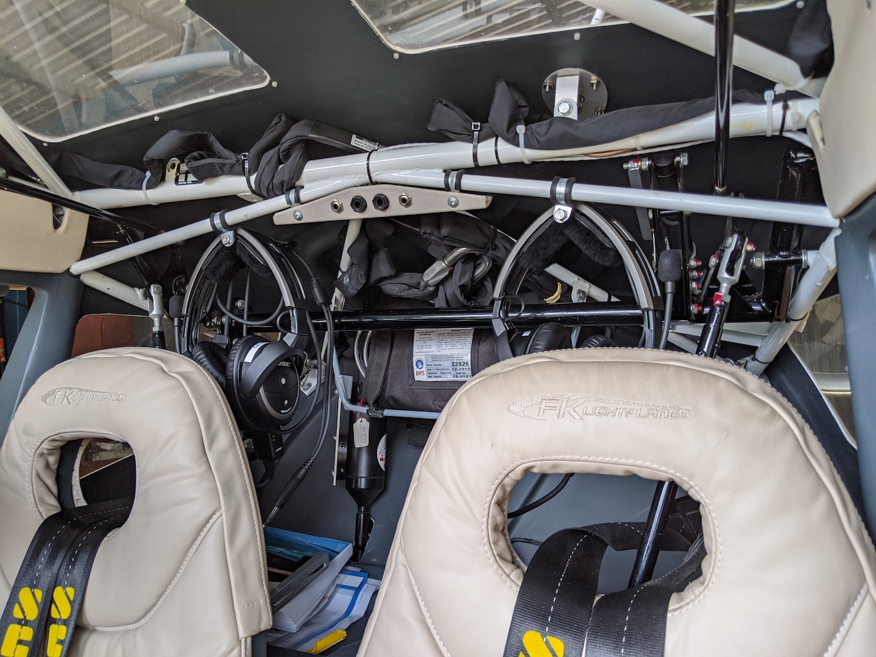

petercoota Posted May 3, 2020 Author Share Posted May 3, 2020 Finally got the job done. Biggest issue in an LSA cockpit is finding some room. I wanted a hanger to store the headsets when not in flight. When flying solo I'll still engage the unused headset with the unused seatbelt. Flyboy1960 gave me the idea originally, THANKS. I used a P clamp from Speciality Bearings Canberra & 10 x 70mm SS bolts & nyloc nuts from Bunnings. Shrink wrapped the assy with the shrink tube normally used for electrical work. I've put a nyloc nut on the end to stop the set slipping off, but I think this is overkill. Some pics attached, thanks for all the ideas 3 Link to comment Share on other sites More sharing options...
FlyBoy1960 Posted May 3, 2020 Share Posted May 3, 2020 There is a lot of "stuff" behind there ? Bars, parachute, rocket, bridles. A cover would be nice to tidy it all up with a big logo printed on it. Link to comment Share on other sites More sharing options...
