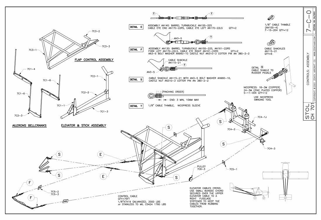

Deskpilot Posted November 2, 2020 Share Posted November 2, 2020 Can anyone provide me with a sketch or image for a single stick flaperon set up. TIA. Link to comment Share on other sites More sharing options...
IBob Posted November 2, 2020 Share Posted November 2, 2020 The standard Savannah has centre stick and flaperons. Is that what you were looking for? Link to comment Share on other sites More sharing options...
Marty_d Posted November 2, 2020 Share Posted November 2, 2020 http://www.zenithair.com/stolch701/data/7-c-0.gif CH701 is pretty much the same as Sav. As you can see from the drawing, the Y-stick is connected to a torque tube with fixed horn on the back. That horn has threaded rod running to the inner end of horns that centre pivot on the mixer. It doesn't show it in this picture, but the outside of those horns have a rod which is connected to a fixed horn on the flaperon. So sideways movement on the stick rotates the whole torque tube and pulls/pushes on the mixer horns to move the flaperons. Mixer is pivot mounted at the front so the flap handle can move the entire mixer forward or back, which lowers or raises the flaperons. Link to comment Share on other sites More sharing options...
