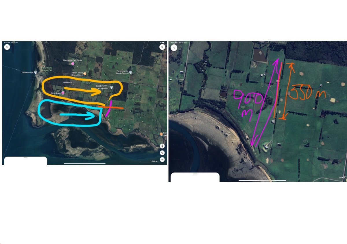

Other pics above  finishing up a runway extension. Not having easy access to road grader we are using the 8 ton excavator as small bulldozer. Bucket takes out hills and fills holes. The traversing backward and forward and angles really levels the ground. The tracks press the freshly cultivated soil down. Overall a win against the 6k it’d cost to bring the family road grader back down with barge and float costs.
Runway now finished and as soon as the grass grows it’ll be fly straight out of the 2nd hangar up the hill for northerly take off. 600m and that uphill is a huge help for landings from the south. I should have put the runway there in the first place. Realised the mistake when landing about a month back with a 20kn direct cross and battling in with the geese and the uphill downhill and 3 goes to land. Total runway length is now 1km if you don’t mind a dogleg from the south at 500m then it’s another 500m uphill to arrest excess energy,
Bonus I hadn’t realised with the extension is that instead of facing the full force of westerly/ north west winds the uphill section is protected by topography and trees.
Thinking I might now list it as an uncertified airfield. I’ll discuss pros and cons with people. With the extension take offs and landings can all be done to the south and not annoy neighbours. It’s also less challenging now. I got over having people in after watching a few very hairy landings. Particularly a jabiru that looked perilously close to dropping a wing on the ground at the apex of hill in a crosswind. Scared the bejezeesus out of me just watching.

True. But I’m very sure of what’s happening here. I’m living it. The  blue area has virtually no protection from westerlies. As you go up the hill it changes quite dramatically. The whole orange shaded area is low hills and trees.
Other bonus of the extension  is there is nearly a km to sort where the cape barren and water hens are to land before or after them. Useless buzzing them with low passes. They ignore the aircraft. I’ve been flying here long enough that a number of them will have been born in the runway area and grown up with the big noisy bird as normal. I’ve made landings where the pair ahead of me as I slow down don’t move at all. I have go around them. Makes juggling the idiosyncrasies of a tail wheel even more interesting.

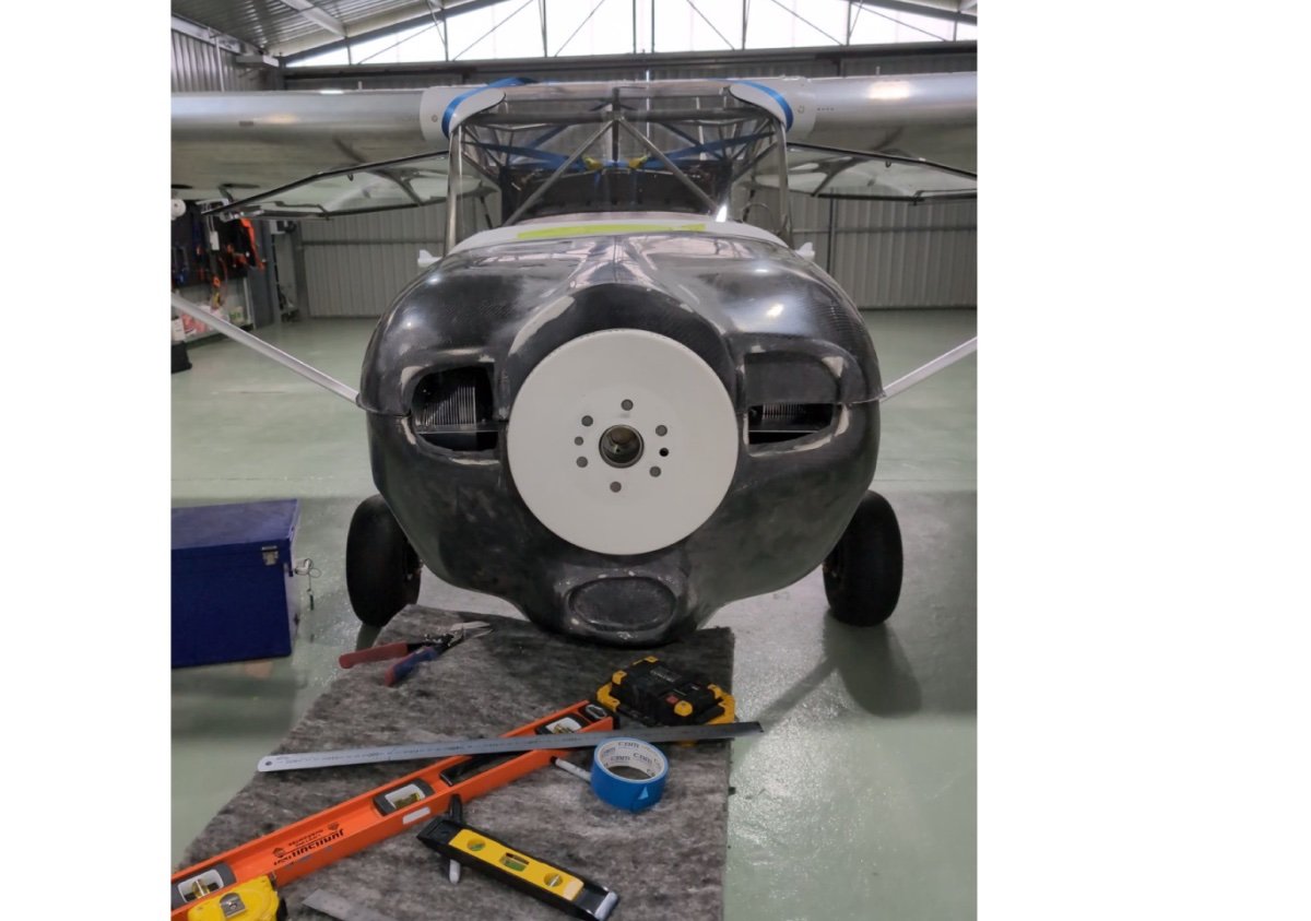

Given the amount of heat you’ll be managing with that big ULPower engine, have you considered adding the Coandra exit fairing and cowling lip that other S-21 (and RV) builders have resorted to, before your first flight?
Since the clecoes are still in your lower firewall, it might be easier to do before riveting and painting.
Wow, that’s a good idea! I know just enough to understand that it’s that exit air that’s most important if the inlets are sized okay. That and the air is ramped up on the inlet and not leaking anywhere/ everywhere.
I believe the plan is to do the minimal and then test. Pic here from today. We are choosing if the spinner area should be lowered or lower the top cowling and raise the inlets. The cowling provided from UL USA obviously needs a bit of massaging.

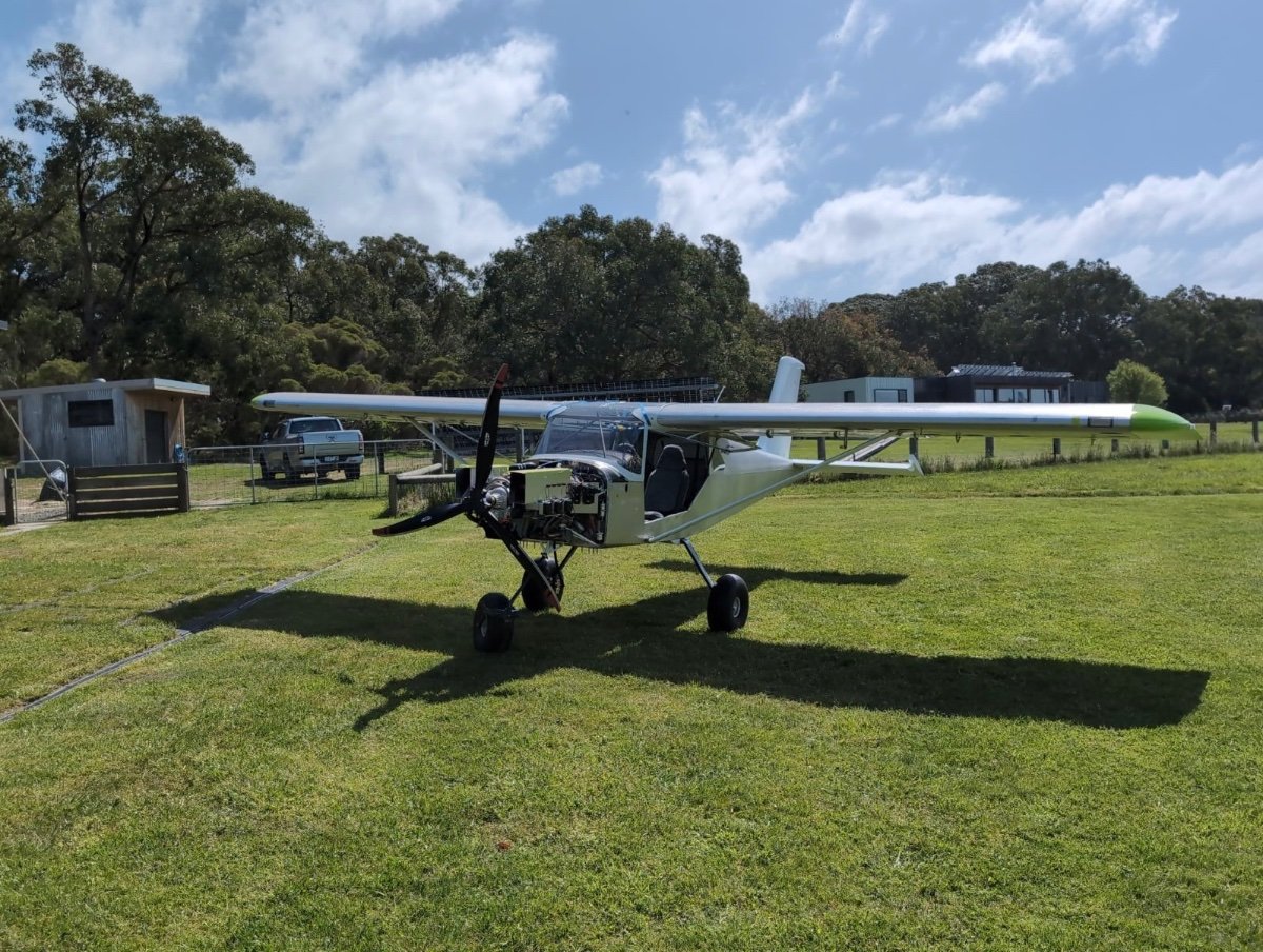

Aircraft 1
We hope to be flying today. Test pilot visiting and if all go we fly. We are higher temp on cylinders 3 and 4 on high rev taxi so this could influence our decision making.
Nic was very certain we wouldn’t have a vacuum explosion when vacuuming out the tanks with a little gas in the bottom. Thankfully he was correct. I must admit I was a little chicken and stayed back out of shrapnel range.

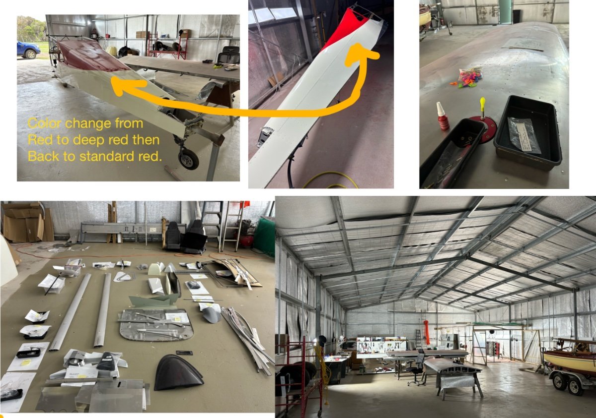

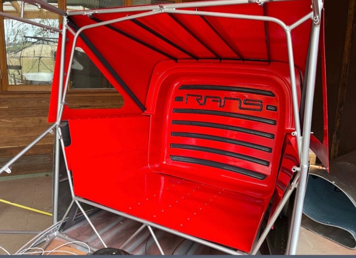

I had a moment where deep red seemed the modern option looking at the latest car colors. Returned to a more traditional fire engine red. Which red is better? I still don’t know 🙂
We are thinking of leaving the wings off aircraft 2 and maybe even the wheels to make interior/ avionics easier to work on. Sit the fuselage on a box about half what it’d be on wheels and no climbing over wheels or ducking under wing to work.

Should aircraft builders follow color fashion? I think it was peer group pressure driving down the road and seeing the dark reds one after another.
The decider was when I was reviewing old pics and came across this one. Contrast between the inner and outer wasn’t going to work well. Also, I’d put a fair bit of work into the interior paint. Blasting it deep red didn’t seem right.

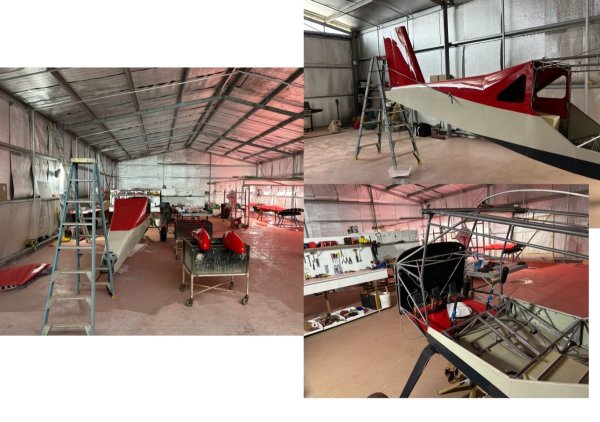

Wing painting today.

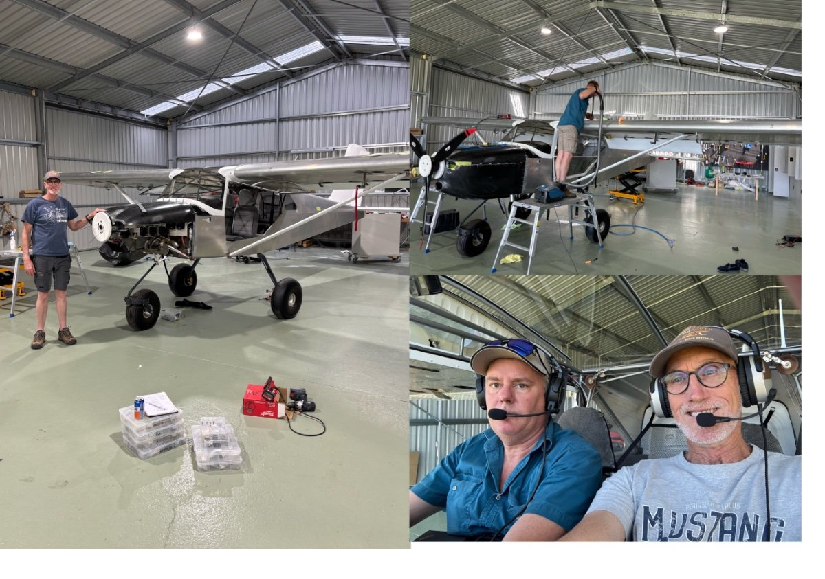

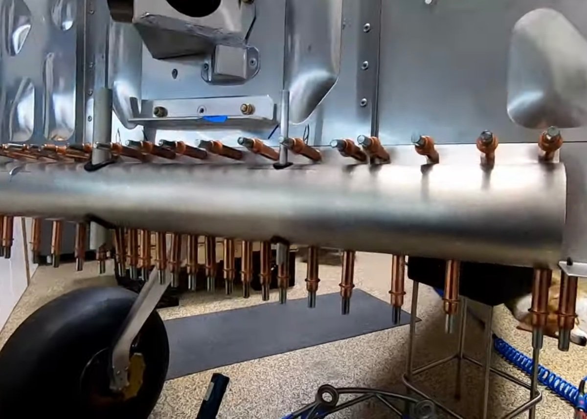

Aircraft 1
Pics below. Test pilot Ben checking detail throughout the aircraft before scheduling a test flight day. I thought it was the test flight day. Makes a whole lot of sense to spend a day thoroughly checking every aspect of the build before venturing into the air. We were lucky to get Ben as test pilot. He spends most of his time flying executive jets around the world.
Aircraft 2
It’s the first time for a year that I’ve been able to get stuck full time into the build. It’s a bit like your first day on a new job starting back in. I got off to a rocky start putting fuel tank holes in the wrong spot a few months back. If you don’t do any building you can’t make a mistake. But….slowly got back into it and it’s been very satisfying laying down paint that’s not orange peel. Used to be and the paint shop sold me a HPLV spray gun. What a difference. I apply the paint in 1/4 to 1/3rd runs that isn’t too thick. That way if it’s slightly under or over the paint blends in and it’s near enough to perfect.
Put the header tank in with triple and quadruple checks before drilling holes. The manual actually tells you to triple check. Don’t know what I was thinking when I drilled those fuel tank holes wrong. Probably over confident. Fixed that problem now!
I’m back to the rhythm I had a year ago. Enthusiastic and putting in 8-11  hour days not including time spent each day on YouTube’s and sitting watching tv while thumbing through Rans parts, text and figure manuals.
Nic and I are off to Parafield this weekend for an SAAA course in maintenance. Compulsory if you want to do your own annual etc. 8 participants and apart form the boring regulation stuff it should be fun with fellow builders. I then fly back to Melbourne and immediately board flight up to Taipei for 5 days.
‘Then back into build process only interrupted by hay baling. Nic will work with me on avionics. Expect to have avionics done and Titan engine all plumbed in by years end then maybe January finish up the skylight, windshield, doors and engine cowling.
We should be flying Nic’s really soon.

Aircraft 1 is still about to fly, maybe next week.
Aircraft 2 is starting to move along. Brake lines, header tank and fuel lines in. Controls mostly complete.
Painted most surfaces and tail feathers and engine possibly on next week.
