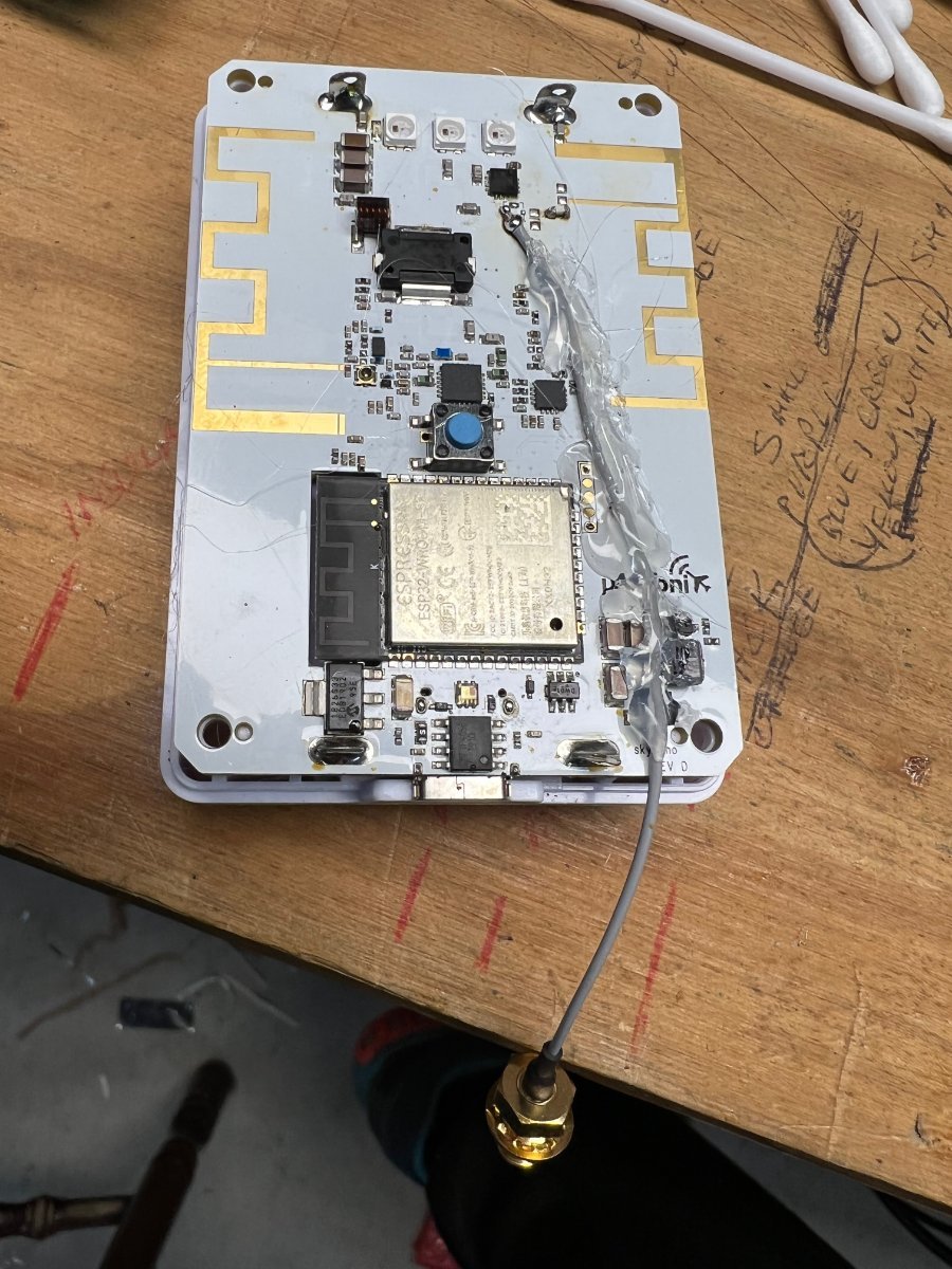

Kyle Communications Posted April 10, 2023 Share Posted April 10, 2023 52 minutes ago, Old Koreelah said: Maybe a silly question, but does anyone know if the transmissions from the SkyEcho2 are directional? I have nowhere on my panel to put this little unit, so intend to mount it on the side, near my shoulder. That means it’s side-on to oncoming traffic. Is that an issue? The smaller pcb track lines are the 1090 mhz for the ADSB..it is on the right side. Ideally you should have it on the windscreen facing forward but it depends of course what direction oncoming traffic is coming. So its much of a muchness. The main thing is to make sure it has clear view of the sky for the GPS signal and no obstructions..metal of course in its way Link to comment Share on other sites More sharing options...

RFguy Posted April 10, 2023 Share Posted April 10, 2023 they're a little directional, but up to 10nm shouldnt matter too much. not affected reliably measurably by poly screen plywood etc. and not even metal struts and thin members, since the RF tends to re radiate off those items. 1 Link to comment Share on other sites More sharing options...

RFguy Posted April 10, 2023 Share Posted April 10, 2023 (edited) experimenting with another (airborne) aircraft will simply multiply the two uncertainties from the two aircraft. You'd be better to park the 2nd aircraft , or set up the SkyEcho on a tripod, with tablet sitting on a seat underneath, and fly the 1st plane (device under test) in some direction (get some altitude to maintain line of site ) and once on station 10 to 15nm, where the pickups are becoming marginal, execute a shallow 15 deg max turn 360 deg and note the pickup variation with test aircraft heading. repeat 3 times to generate trend. Rotate test receiver 90 or 180 deg and do it again. Edited April 10, 2023 by RFguy Link to comment Share on other sites More sharing options...
