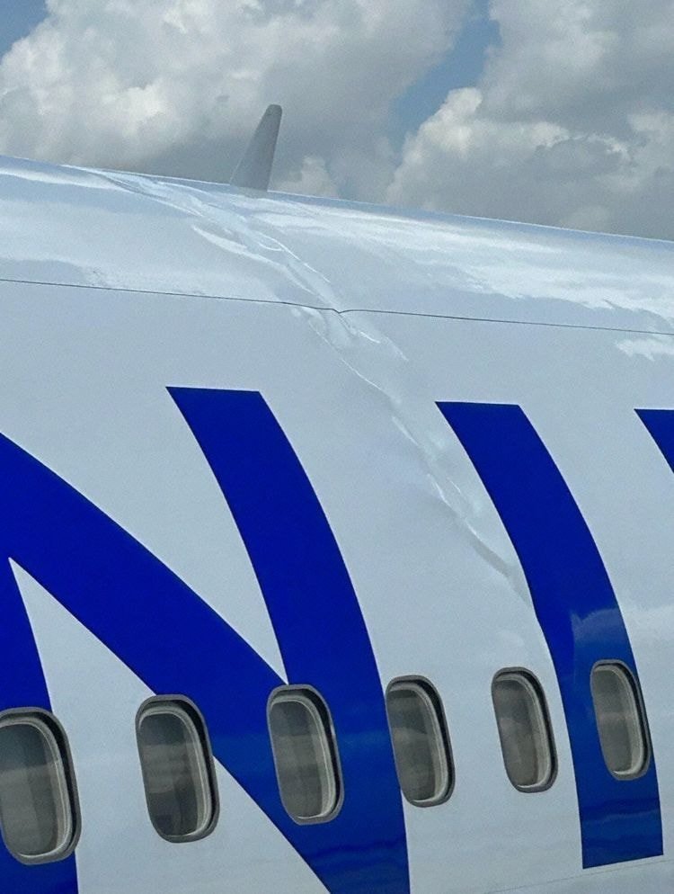

red750 Posted August 7, 2023 Share Posted August 7, 2023 This aircraft suffered a hard landing and may not fly again. Here's why. Link to comment Share on other sites More sharing options...
Old Koreelah Posted August 7, 2023 Share Posted August 7, 2023 Ouch! Link to comment Share on other sites More sharing options...
onetrack Posted August 7, 2023 Share Posted August 7, 2023 Oooh, that one won't buff out. Pretty old aircraft anyway, she was nearly due for the scrapheap. Link to comment Share on other sites More sharing options...
Jerry_Atrick Posted August 7, 2023 Share Posted August 7, 2023 Looks like the pilot wanted to make sure.. Had to be a darned hard landing to do that! Link to comment Share on other sites More sharing options...
facthunter Posted August 8, 2023 Share Posted August 8, 2023 That must have been a 'good' one. They usually break into 3 bits. Nev Link to comment Share on other sites More sharing options...
onetrack Posted August 8, 2023 Share Posted August 8, 2023 (edited) The 767's were weak in that region of the fuselage and after several early fuselage wrinkle events on 767's, Boeing undertook strengthening of the upper crown stringers in the fuselage, in production aircraft from January 1995. However, no retrofit of the fuselage strengthening was available - the strengthening obviously required structural changes that couldn't be carried out to earlier production aircraft. As this United 767 was 37 years old, it's obvious it's an early 767 (it's actually United's oldest aircraft) - and the 1995 strengthening couldn't be carried out on this aircraft. Boeing advice on fuselage damage - https://www.boeing.com/commercial/aeromagazine/aero_18/aero_18.pdf This is how easily the fuselage buckling can happen - ANA bent this 767 in 2012, and it was captured on camera. It appears the porpoising event was where the damage occurred. Edited August 8, 2023 by onetrack 1 Link to comment Share on other sites More sharing options...
