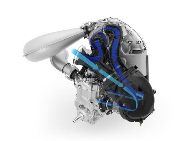

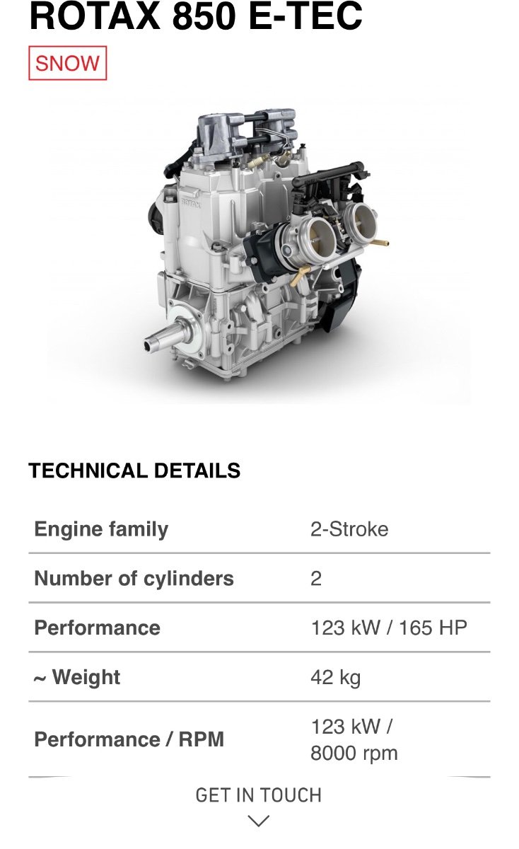

Thruster88 Posted August 25, 2023 Share Posted August 25, 2023 Would love to get my hands on an 850 etec for the thruster, would be epic. 1 Link to comment Share on other sites More sharing options...

facthunter Posted August 25, 2023 Share Posted August 25, 2023 2.5 times the current Power would be a change, but since they don't overspeed in a near-vertical dive, getting off the ground fast might be the most noticeable difference. It would be a change reducing the power so much once you levelled out. Nev 1 Link to comment Share on other sites More sharing options...

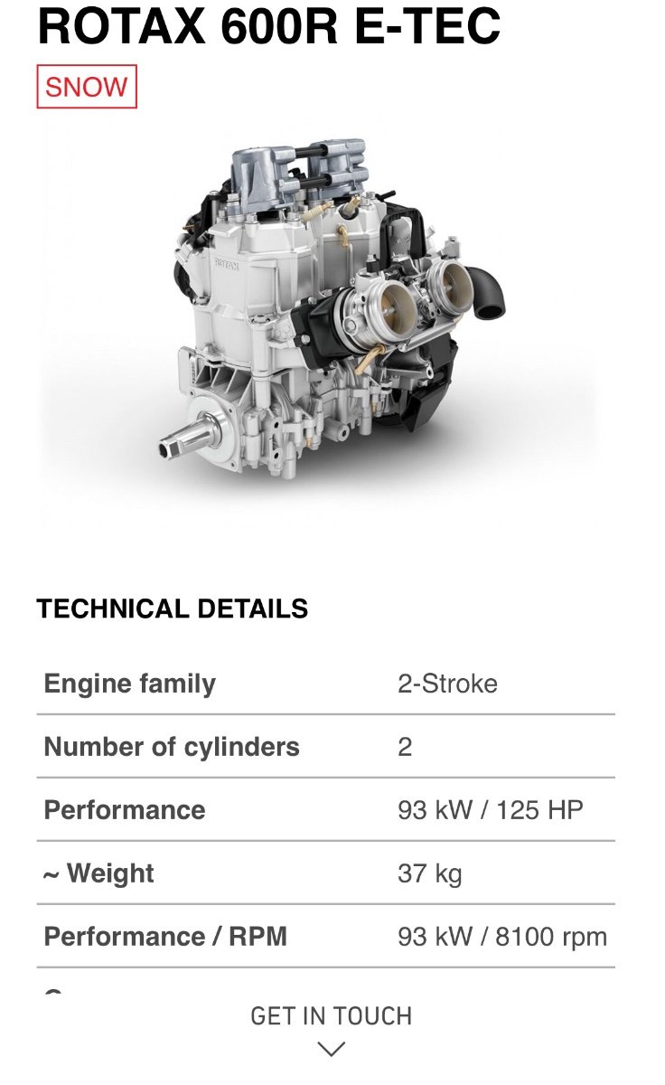

SAJ Posted August 25, 2023 Share Posted August 25, 2023 Even the 600 E-TEC would make my Thruster exciting. Betcha they wouldn't be cheap. 1 Link to comment Share on other sites More sharing options...

Thruster88 Posted August 25, 2023 Share Posted August 25, 2023 The Rotax E-tec 2 strokes are used in snowmobiles, they get close to 4 stroke fuel efficiency and electronic control means egt is correct so happy pistons. The is even a turbocharged version with 180 hp. 1 Link to comment Share on other sites More sharing options...
facthunter Posted August 26, 2023 Share Posted August 26, 2023 Vertical twin 2 strokes with the 180 crank have a Lot of balance problems and an 850 is a whopper size for that type of motor, Nev Link to comment Share on other sites More sharing options...
