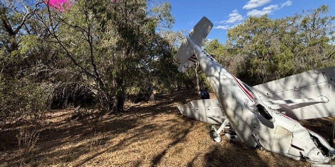

Rotorwork Posted April 18 Share Posted April 18 From ASN https://aviation-safety.net/wikibase/386671 The Legend 600 suffered damage from an unknown cause possibly a bird strike which fractured the vertical stabiliser resulting in loss of control. The pilot deployed the plane’s ballistic patachute to bring the plane down safely. The occupants were not injured but the plane suffered extensive damage contacting a tree on the landing. 3 Link to comment Share on other sites More sharing options...

Jabiru7252 Posted Saturday at 06:05 AM Share Posted Saturday at 06:05 AM Flaunting my ignorance here - why would fracturing the vertical stabilizer cause a loss of control? Might make things tricky in a cross wind landing but loss of control in flight? Link to comment Share on other sites More sharing options...
facthunter Posted Sunday at 02:04 AM Share Posted Sunday at 02:04 AM Depends on the keel surface and how the air flows around it. It's a weathercocking effect and I reckon most planes would be directionally uncontrollable. with adverse aileron effect. Nev 1 1 Link to comment Share on other sites More sharing options...
