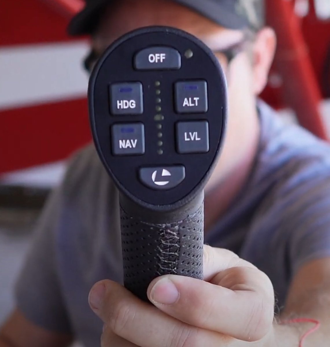

Moneybox Posted Sunday at 09:23 AM Posted Sunday at 09:23 AM I'd really like one of these from Levil.
