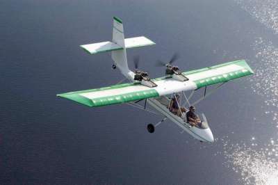

Admin Posted June 6, 2008 Share Posted June 6, 2008 This could be what a twin engine Drifter could look like Link to comment Share on other sites More sharing options...
drifter_driver Posted June 6, 2008 Share Posted June 6, 2008 thats leza lockwood aircam. incredible aircraft capable of taking off with one engine on full load. but very pricey(100+k) a bit out of range for your typical drifter pilots financially speaking. here's the link http://www.aircam.com/ Link to comment Share on other sites More sharing options...
Ultralights Posted June 6, 2008 Share Posted June 6, 2008 Yep, a twin engined drifter, or better known as a.... damn, i cant remeber what is was called now, but there is a blue one VH registered in NSW somewhere, well there was in Hoxton park a few yrs ago! edit, thats it, the Aircam! Link to comment Share on other sites More sharing options...
Barefootpilot Posted June 6, 2008 Share Posted June 6, 2008 I think someone must have been reading the same mag as I was the other day! Looks interesting - alot more aircraft than a Drifter. I believe it was built as a camera platform for a doco. The same company had used a drifter before but due to unforgiving terrain of the next movie Lockwood build a twin. $100k's for a twin? Not to bad pitty it would have to be GA! Link to comment Share on other sites More sharing options...
Ultralights Posted June 6, 2008 Share Posted June 6, 2008 100K for a twin is a bargain! what would you expect to pay for a GA twin these days? Link to comment Share on other sites More sharing options...

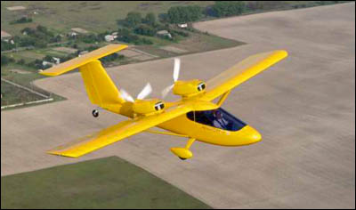

drifter_driver Posted June 6, 2008 Share Posted June 6, 2008 aeroprakt a-36 twin another similar and faster twin engine aircraft. aeroprakt A-36 Vulcan twin. cruises 120 kts http://www.aeroprakt.kiev.ua/eng_html/main.html Link to comment Share on other sites More sharing options...
Admin Posted June 6, 2008 Author Share Posted June 6, 2008 I think the main advantage of something like this is that for those in the GA arena that want to get some twin time in their logbook it would be a cheap way of doing it. Link to comment Share on other sites More sharing options...
