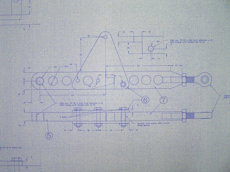

Hi Mark,
The plans are 'blueprints' with about 30 pages of different sizes. Very few notes but most are in English as well as Italian. Very little instruction - it is up to the builder to work out the sequence and method. There were a few mistakes but other builders have pointed them out for us. There is a manual with some construction and maintenance for the completed aircraft. We have been sent some pictures of aircraft under construction. We have not started - still thinking and looking at materials and suppliers.
Any more you want to know - ask and we'll see what we have.

The plans are not for the faint hearted. We decided not to build because the maximum take-off weight is lower than we wanted. In Australia retractable undercarriage can't go into the ultralight category so it requires a PPL to fly, which was another consideration.
You need to study the plans thoroughly. There is no instructions on where to start, the process to follow, or exact materials to use. A lot of it is left up to you, including selection and use of tools and working out how to achieve the end product. If you have experience building it will be easier. The finished aircraft as an impressive look. It is mainly wood and birch ply with a few parts in chrome-moly, flaps, ailerons and rudder are dacron covered. The usual engine is a VW 80HP, wooden propeller, 50 litres (in 2 tanks), dual controls, tandem seating.
Sue

Hi Beckd
I got the Whiskey IV plans out again. The canopy is 3mm plexiglass with a full sized template for the front curve (you have to work out the back and sides yourself). It is embedded in the fuse construction plans so you can't lay it out to cut. There are no suppliers listed so I guess if you can't do it yourself you do the measurements and take it to someone who can. There are 24 sheets in the Plans - eleven are 1:1 scale, the rest are 1:5, 1:10 or NS. Few dimensions; so you have to scale it for yourself or measure & calculate.
One of the sheets is "Construction Instructions" with a few drawings on good, difficult & passable ply joins & glue joints, a wing jig & table dimensions (5800 x 800mm) and the following text:
Construct a table to measurements indicated
Build the two fuselage sides and frames 1-2-3
Build the wing main spar caps shown full size on the assembly drawing
Build the ribs of the wing, vertical and horizontal tail
Build the ribs of rear spar - flaps and aileron spars and the tail spars
Assemble the fuselage
Assemble the tail surfaces
Assemble the wing
That's about as much instruction as you get, apart from notes on the plans eg "use only AN or MS hardware" "TIG weld only"
There are builders working from these plans, so if you decide to go ahead there are people who have gone before you and may have the answers.
Sue
