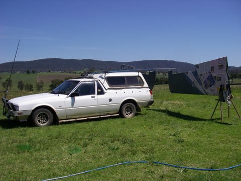

Green, in colour only Just shortly, I put lotsa green paint on. It sparkles I am green My sister got conned into helping mask off My ute was put to work as a painting stand (hung the wing from an aileron hinge) It looks good Actually, it looks like a rushed $300 paint job by an amatuer. A couple of spots where the tape has pulled the grey, will have to be brushed on. All is good. -

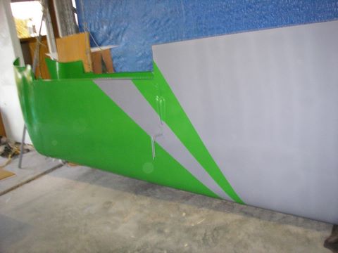

Putting the pain into painting Things are moving quickly, Sprayed some enamel on today (first colour of a 2 part scheme) Now I don't know how you learned to spray, but my first spraying of proper paint was lying on my back under the belly with inadequate space and lighting, a cheap spray gun, paint which was really designed to be brushed, so thinning was a bit choose your own adventure and was painting grey onto grey etch primer...................................... And it turned out alright. Notice 'alright', not 'good'. But hey, so far my bill for paint is about $350 and that includes sufficient paint of both colours, primer, thinners, and a spray gun. Not Kidding. Water trap and compressor belong to Lex, but I wasn't game to use his gun, since I would have to spend ages cleaning it. So not to worry. Has anyone else used HiChem etch primer on fabric? and has anyone else had problems with the primer not likeing the glue lines? Not too bad, but glad I didn't use expensive paint. The odds and sods get painted tomorrow, ready for the 2nd colour on Monday. Will put the wings on, and do it outside. Bring on the mettallic. PS I don't blame you, Disperse. But your turn will come, and remember: about 6 months with nowhere near adequate sleep. -

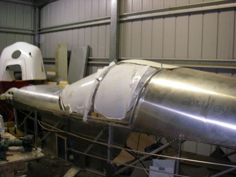

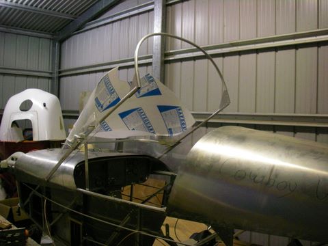

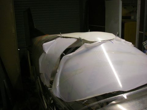

Canopy on It took me from midday until 2:40 next morning, and it still needs a bit of finishing, but I go a sure 'nuff canopy. The reason I worked so late is because I have it on good authority that Garry took three days for the Sierra canopy, Tim and Slarti took 6 days (but most likely got a lots better job which will be thrown out when the conversion to molded comes through). And to cap it off, when I spoke to Garry earlier that day, he said I wouldn't get it done. And I work very well indeed under competition. So there it is, not the world's best canopy, but hey, all it has to do is block the wind, and maybe rain. My trick to going so much faster is simply that, while at work on a reno, I pulled up a heap of cardboard lino underlay. Perfect template material. Sit it over, trim with scissors. Throw the first one away, fold next in half to get it symmetrical etc.etc. Then make it rough fit the front bow, cut out the real one with about 10mm margin of safety (is neccessary with the different properties of polycarbonate). Put real one over, bend front bow to fit (about 20 times, lots of censored comments there) all sitting fine, RIVET. Then the tophat. Then sides, more templates for sides. Actually, I got it that symmetrical, both sides are cut to the same template. And there you have it. Nowhere in that operation did I have anyone giving me a hand at all (who would at that time of night). Then I found out the problem. Having made it flatter, the front came further forward, this means it touches when it is opened too far. so full open is not very far. Not too worry: a: it doesn't affect flying b: the molded canopy is on the way c: it could be fixed with new pivot arms d: NO FAT PEOPLE ARE ALLOWED IN ANY CIRCUMSTANCE ANYWAY:laugh: So thats getting there At the moment, the undercarriage is off, and I am halfway through fabric covering the fuse. And doing the cowling simultaneously (with my other hand;)) Got some AVGAS and oil today, might get some action out of the motor soon. Sleep now:keen: -

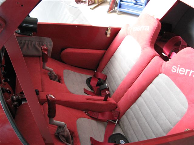

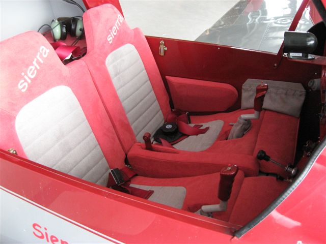

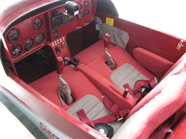

Flying The first Sierra is flying, and cruising at 130kts at 2750rpm. But it will get another prop which should make it better yet. Here are some more pictures, D*mn that is one sweet interior.
