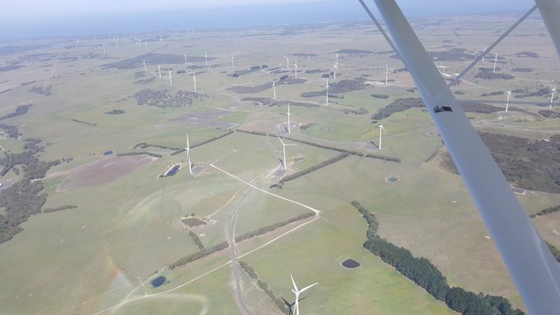

There’s a lovely cluster of windmill towers at Venus Bay Vic. just off the Bass Straight. I often plan a local flight past here, and along the fabulous coastline back to Phillip Island. I’ve never been able to figure out why the mandatory design standard doesn’t require storage batteries at the base of each tower, and a bank of solar panels down the north side of each tower!
