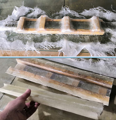

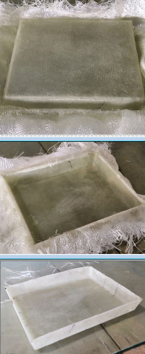

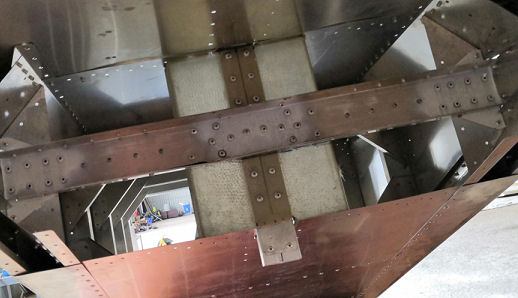

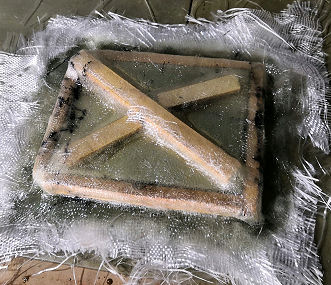

After a few days rest again I did some more. Good that I'm slowly getting back to strength, but **** my knees are still a bit weak after a year of laying and sitting around, oh well, just got to keep pushing ... I molded up my gusset/joining plate and pulled the part out this morning, now affectionately referred to as the 'ashtray' (thanks Marty) ... .. and this is what it does, joins the HS front spar to the upper and lower rear fuse sheets, and the mid-way post for the upper and lower VSs ... -

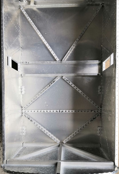

Floor is almost ready for a sheet of plywood... And just a quick vid for somebody else of the 'allen key' deburring tool for inside tubes ... -

Nah, gave it up in my late teens. It's a gusset/connector plate that ties the HS front spar, middle VS post and upper and lower rear fuselage sheets together. Simple, eh? -

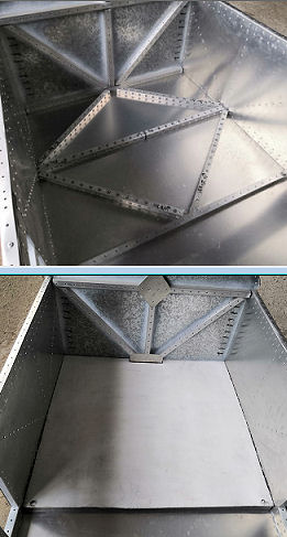

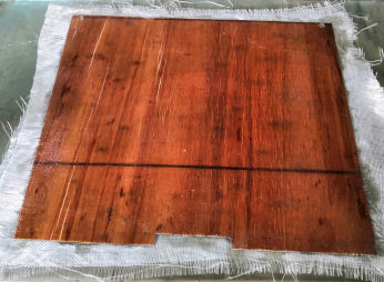

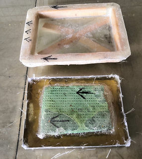

The front floor board supports are in... Pulled my (outer) mould off, it's fine, and using the same pattern for the inner mould by merely filling it up with resin and a bit of matting, with a chunk of foam to take up a lot of the volume. I can use the same pattern for the inner because it's a simple rectangle with all sides tapered, and the inner will simply wedge into the outer. Will test the theory tomorrow alt=:)https://www.homebuiltairplanes.com/forums/styles/default/xenforo/clear.png[/img] -

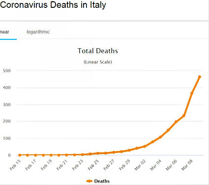

Well there's enough info out there that you should know. I suggest you have a look what's happened in Italy via these various charts, including recovery .. Italy Coronavirus: 9,172 Cases and 463 Deaths - Worldometer -

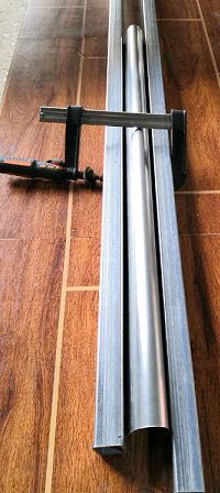

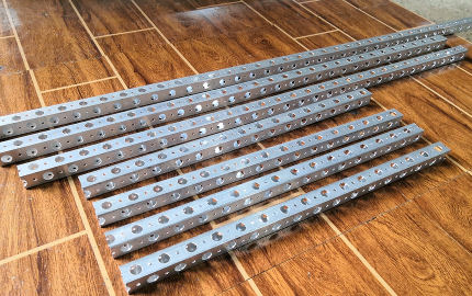

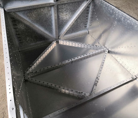

I decided I need a C Channel and another part easiest to be made in fiberglass, so moulded up a 50mm/2" steel tube and pulled a piece and handcrafted the other part which the mould will be ready tomorrow.. Preparing some Swiss-Cheesed floor runners, all press drilled, I don't mind it, but it's boring after the first hundred holes, so can't wait for my CNC Router to arrive soon .... -

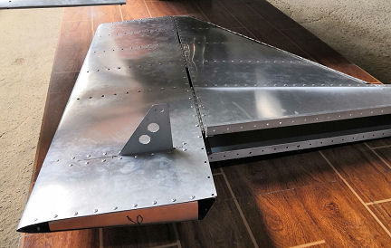

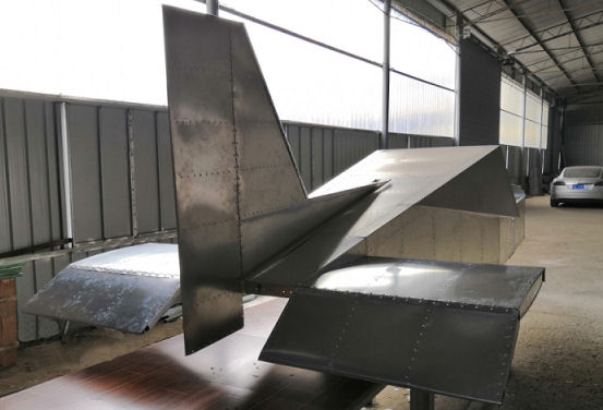

You mean the VS? If so there are 2 posts, one at the rear and one where the leading edge meets the fin, well there will be after i build them today, and you still won't be able to see them even when they are installed. As soon as I am finished this bowl of Kerrogs K-Nine Cereal, it's off to the factory to make them. -

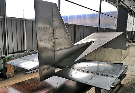

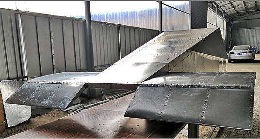

I had to have a few days rest, recovery after last years open heart still takes a bit out of me, but getting there, just slower than I would have liked. But anyway, enough of that, I don't want you guys to get all upset and misty eyed over me and start donating money, well ok, a little if you insist, I promise to not spend it on expensive whiskey - 12 year old will be just fine. Yesterday and today I played around with the VS and Rudder, measuring and figuring how to operate it. I ended up adding an extra rib next to the one at the edge of the tail, slotting the rudder, and slipping a lever arm through to be sandwiched between them, and riveted in place. Worked out quite nicely, though I will be changing the lever arm out for a different shape one. -

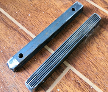

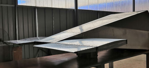

. It has been bought to my attention this morning that a couple of Members here have been sharing a story about Chinese cutting up humans, and canning them as 'Corned Beef" for shipment to African Countries. I have deeply investigated this today and want to offer assurances to those concerned that absolutely no children or dogs are being added. .... Quite proud of myself today, I arrived at the factory in the morning with not a clue how I was going to balance the Elevators, and by the end of not only figured it, but had 90% of it finished. I grabbed a 25mm (1") square tube, cut some 19mm (3/4") flat steel and slid them inside the tube, ... sat it on the Elevator and juggled the tube and the weights around a bit, until it balanced. Got to seek out a reasonable ratio of length and weights. The longer the lever, the less weight, the shorter the lever, the more weight required. At first I settled on this .. But it was a bit long, so I got it a bit shorter by adding a couple more strips of steel on the outside (better fastener perch anyway), and now the Elevators sit where they are supposed to. They actually center themselves because the weight is a little below the hinge point. I will tidy it all up and make some fiberglass covers at a later date, not important for the moment. . -

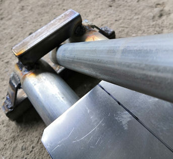

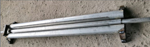

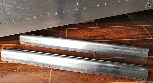

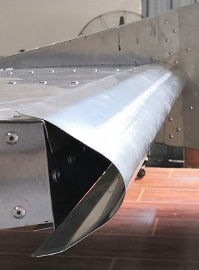

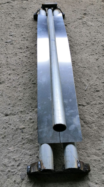

Anyway... This morning I did the other side Elevator leading edge, so here's the picture to replace the one I lost yesterday with the workpiece fully pushed into the jig .. This of course means no need for dancing Gay Spiderman (Sorry Kasper). And the end result, 2 leading edges for the Elevators. Here's a picture of a charming 1950s soviet era aircraft, thanks for the compliment .... -

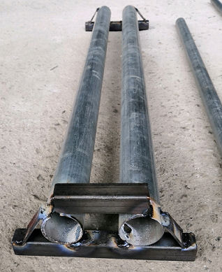

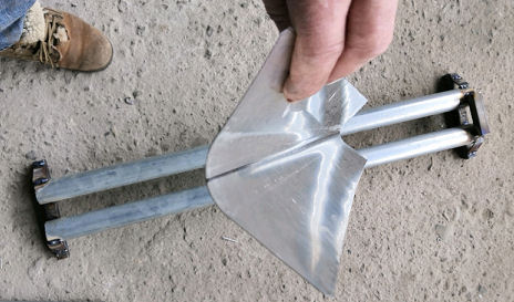

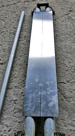

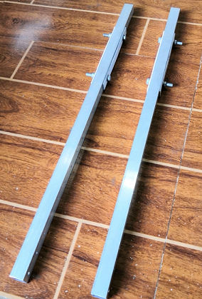

Today I made a quick rough as guts jig from some scrap laying around to help with some leading edges 2 pieces of 50mm/2" pipe, some 25mm/1" square and some gussets. On the right is a piece of 32mm/1.25" pipe. There's about a gap of 38mm/1.5" between the 50mm/2" pipes. Note the end close to camera has a bar across the top, I call it the end with the bar across the top. Note the other end does not have a bar across the top. I call it the end with no bar across the top so as to avoid confusion. I was considering to call this end Rupert, but finally decided on the former. Center your work over the pipes. Hook your 32mm/1.25" pipe (or smaller if you want sharper radius) under the bar. Lever the pipe down all the way through the gap, I put a 25mm/1" tube inside the end for leverage, and once down all the way through, I stick another in the other end as well to push that one all the way down. But you need to hold the first tube down - you may need another person to help depending on length of your workpiece. Note that the lever pipe has no name. I managed to lose the picture of the workpiece forced all the way down, so here's a Gay Spiderman dancing ... So when you remove it, it will springback a bit. You can get a bit more bend by laying a few sheets of newspaper or cloth to tighten the gap some. It's still a little big here. So to pinch it further, a couple of anything suitable, square tubes here, and clamp then together, removing and checking as you go. Make sure you tap the workpiece down with your hand s you go as it can pop up in one corner as you squeeze. You still here? What, you think there's more? What do you expect for nothing. -

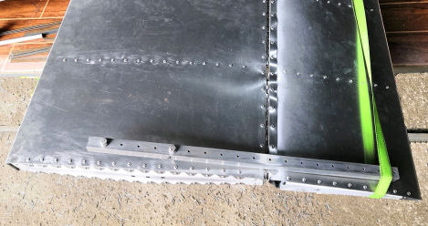

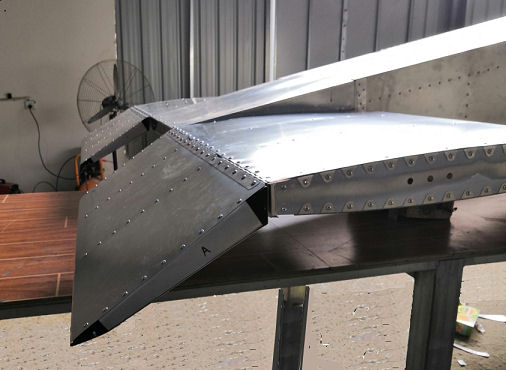

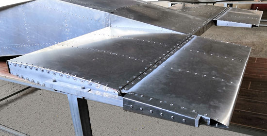

Not arrived yet, don't care what it looks like as long as it performs. Hmm, I've said that before after a few drinks ... More on the Elevators today, made the ribs up, and started adding the hinges .. . . -
