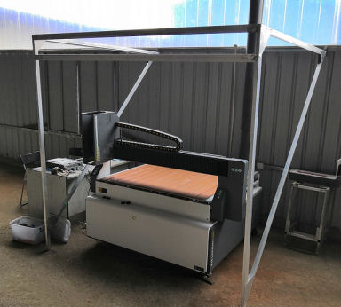

As a breaker of 4 tools over the last 2 days, and one serious crash when over running the Y axis (even bent the front facia plate), I can understand that. Mind you I was a bit pizzed that the machine didn't arrive calibrated, I sent it 1000mm up the Y axis but it only traveled 520mm, where I left it for a moment while I rang the company, they explained to me where to change the software calibration, traveled and measured the X axis which was now fine, then brain-dead me sent the Y back to zero by telling it to travel a -1000mm back to home ....... ..... but it was only 520mm from home .... -

YAY! My router arrived. Busy today making a little house for him and having a play with it. I would have thought the idiots would have done the calibration in the software supplied for and came with the actual machine, sigh .... By the end of the day I even got it to run a small 2D file, no tool of course, long way to go yet ... Still sorting through the various software out there too. until I find one I am comfortable with. -
