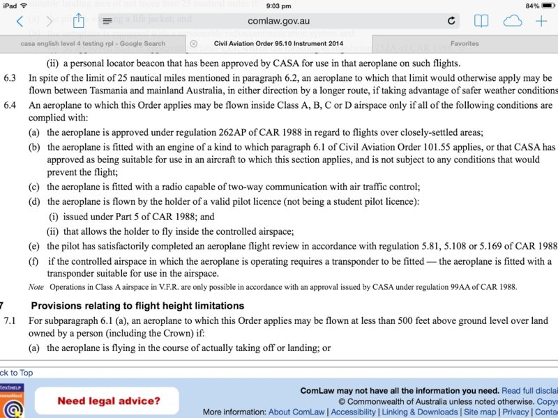

95.10 (b) the aeroplane must not be flown at a height of less than 500 feet above ground level unless 1 of the conditions set out in paragraph 6.2 is complied with; 6 Provisions relating to flight height limitations 6.2 For the purposes of subparagraph 5.1 (b), the conditions 1 of which must be complied with for an aeroplane to be flown at less than 500 feet above ground level are: (a) the aeroplane must be flying in the course of actually taking-off or landing; or (b) the aeroplane must be flying: (i) over land that is owned by, or under the control of, the pilot or of another person (including the Crown) who, or an agent or employee of whom, has given permission for the flight over the land at such a height; and (ii) at a distance of at least 100 metres horizontally from any person (other than any person associated with the operation of the aeroplane) and from any public road; or © the pilot of the aeroplane must be engaged in flying training and the aeroplane must be flying over a part of a flying training area over which CASA has, under subregulation 141 (1) of the Regulations, authorised low flying. So whats wrong with 501 foot? Technically Maybe there was a termite mound ten foot tall so he was 490 above terrain -

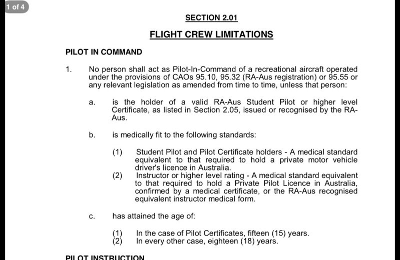

Please find and quote where it says that they can only exercise a priveledge of one licence at any given point in time
The way you are interpreting the law would also imply that a Pilot certificate holder who also holds a ppl cannot fly in controlled airspace. Because to do so they would be operating using their ppl priveleges and thus not under the ops manual allowed to do so...
Round sounds i disagree. The new regs entirely change the rules. an RAA aircraft is fit for both type and class An instructor with both RAa and GA instructor rating is not breaching any rule. And under the MOS and 61.245 an instructor neer only use an aircraft fit for type and class... Nothing precludes that. There is no actual cluase in MOS part 61 or 95.10 or 95.55 that says or implies a dual qualified instructor can only exercise one priveledge under RAA or GA.. Your assuming that your interpretation is correct...and i think your completely wrong. There is nothing that says a GA priveledge, endorsement or RPL flight test can not be conducted in an RAAus aircraft. It simply infers that a ga instructor without raa licence cannot fly the aircraft.... Please supply a quote of what actually states that one must wear one hat or the other while flyng.....
Your dead set right. Para 6.4 d 1 and e needs changing to include part 61 Unless there is something in the part 61 legislation that says it effectively replaces parts of the old legislation
If this is correct we need RAAus to change this asap or our aircraft fleet will be at a massive disadvantage for resale...and not able to be used for what it should be able to be used for...is anyone across whether they are doing so
Im pretty sure your wrong here a PPL has long been able to fly a 24 rego into CTA The PPLs in our club go through coffs all the time as do many others i know of...
