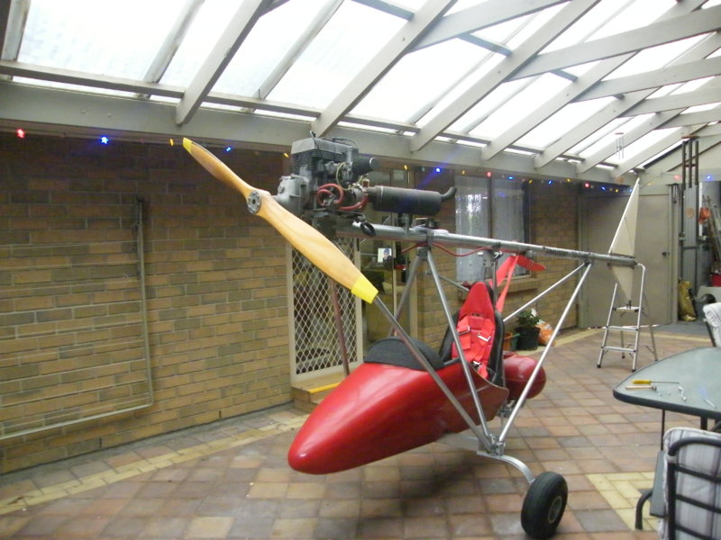

  5. Ah, now it's looking more like a hairy plane Only problem is, that muffler never came off the plane. The rear location bracket is way out of position. To make it fit I'll have to drill out the rivet on the boom and move the mounting bracket to fit the muffler. Still trying to source a 1 mtr square piece of poly-carbonate sheet at 1.5 mm thick. Local price has been quoted at $130. Bex tells me it's $13 in china, but how to transport it. I think I'll be going with the 1 mm stuff at about $40.

  10. Latest update and a question. Yesterday I put my plane into flying configuration (level) and roughly calibrated my fuel sight tube. Decanting the fuel (petrol only) turned out harder than I thought and I lost a few liters to the pergola floor. I won't be lighting a candle out there for a few days. My next job is to refit a control stick/column. Due to changes to the seat, I need to put in about a 2-2.5 inch offset to allow me to pull it fully rearwards without impinging on my stomach. The material to be bent is 22.5 diam x 1.5 wall thickness. Can anyone tell me how to bend it without splits? A local plumber says it can't be done without heat. FWIW, I'm redesigning my throttle control which will sit atop the control stick. My first effort had a weak spot and cracked when I tightened the mounting clamp. Also, I want to incorporate a PTT button. Later this week I will be fitting the engine to the air-frame and perhaps testing it with a prop fitted.

  22. OK, another day to try and start my recalcitrant 503 and video it. At the present time, I don't have a throttle cable so a piece of string suffices to lift the throttle slide assembly. Here goes. Sorry, video won't load but just to let you know, it ran after I enriched the mixture.
  23. OK, another day to try and start my recalcitrant 503 and video it. At the present time, I don't have a throttle cable so a piece of string suffices to lift the throttle slide assembly. Here goes. DSCF5412.AVI DSCF5412.AVI
