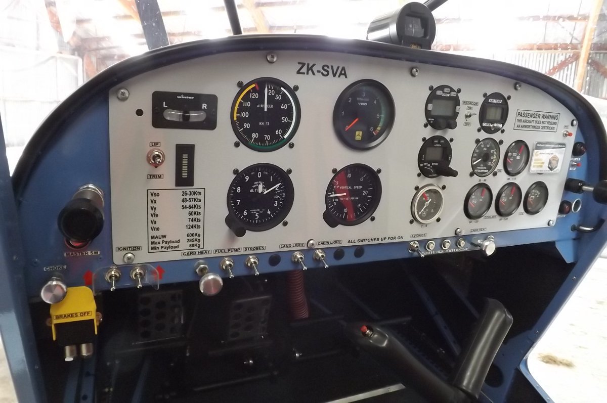

  1. Whatever floats your boat, Kyle. I would comment that the 912 ULS as fitted in the Savannah and with an appropriately pitched prop runs very nicely and does not suffer any high or marginal temperature problems: quite the opposite in our temperate climate, where we blank off part of the oil radiator for a good part of the year in order to see recommended oil temperatures. The Savannah kit includes a wiring harness and steam gauges that pick up the 2 head coolant temperatures (or CHTs in older engines) plus oil temp and pressure, which are fitted standard to the 912.

  6. FYI Marty, 2 possible shortcomings of the receiver tank alarm system: 1. In the kits it comes with an incandescent bulb indicator. We swap that for a flashing red LED, which we also mount on the LH side of the panel (where the standard indicator is on the RH side). 2. Unless you have a way to valve off the main tanks, you have no easy way of testing the level switch, which is a simple magnetically operated reed switch and can fail. We put in a 4 valve system for the 4 tanks, following Mark Kyle's early example, and this does allow easy routine testing of the entire alarm circuit.
  7. Surely, in light singles and microlights, a small receiver tank with level switch in the top is an excellent innovation? In the Zenith 701 and and the Savannah this is a 6L tank, kept flooded by the main tanks. At cruise with a 912, the low level alarm comes on 150secs after the main tank/s stop delivering, leaving the pilot with approx 20minutes of fuel to sort out the problem or find a suitable landing spot. It seems to me this addresses all sorts of scenarios, including momentary unporting, which have brought other aircraft down.

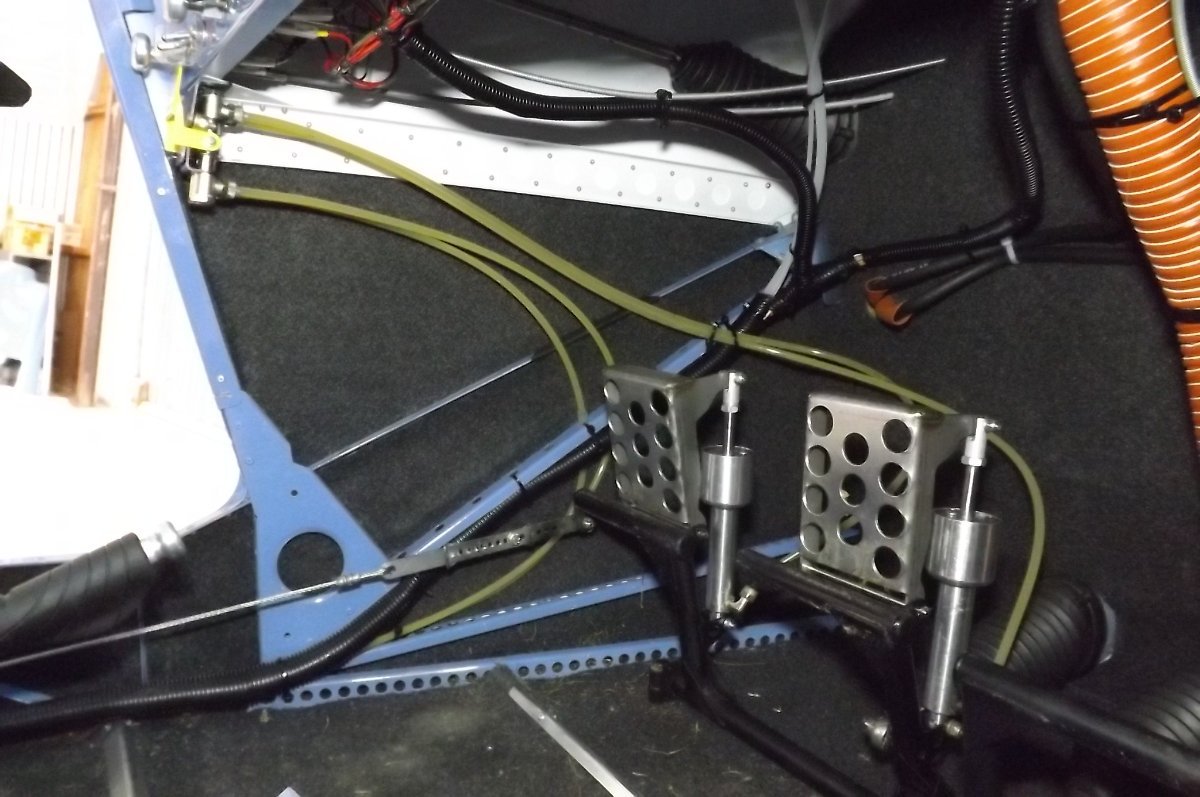

  8. Facthutnter, if BC0979 is referring to the standard Savannah park brake, it is simply a pair of ganged shutoff valves in circuit between the pedals and the wheels: the pilot closes the valves while standing on the brakes. In the Savannah, these valves are situated just under the LH end of the instrument panel. So the brake lines go up from pedals to valves, then back down to the wheels. However, this will not result in fluid flowing back down to the pedals, unless an air leak at the valves allows air in there to replace the falling fluid. And you are right, such a brake should not be relied on for any extended period. But it does allow time for the pilot to find a rock or chocks as required.

  10. PS: If you register your build with ICP, you get access to Maintenance Manual updates etc I reccomend it.
