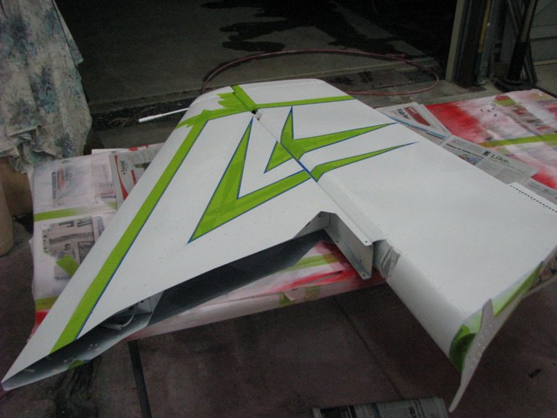

cscotthendry Posted April 10, 2013 Share Posted April 10, 2013 I wont tell you what my Sav cost me but it was a fair bit lower than 60k inc all avionics. I am surprised I would have thought the skyrangers were a lot cheaper Mark: Does the Sav come pre-painted, or did you arrange that locally, or do it yourself? I ask, because painting was one of the aspects of building that really daunted me. I wasn't confident of doing it properly and having it done professionally seemed like it could get very expensive. The absence of requirement for painting was one of the big attractors to the Nynja for me. Link to post Share on other sites
lark Posted April 11, 2013 Share Posted April 11, 2013 They are a nice looking a/c! 1 Link to post Share on other sites

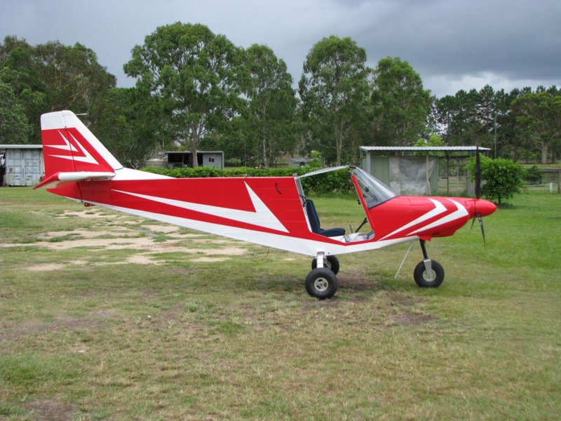

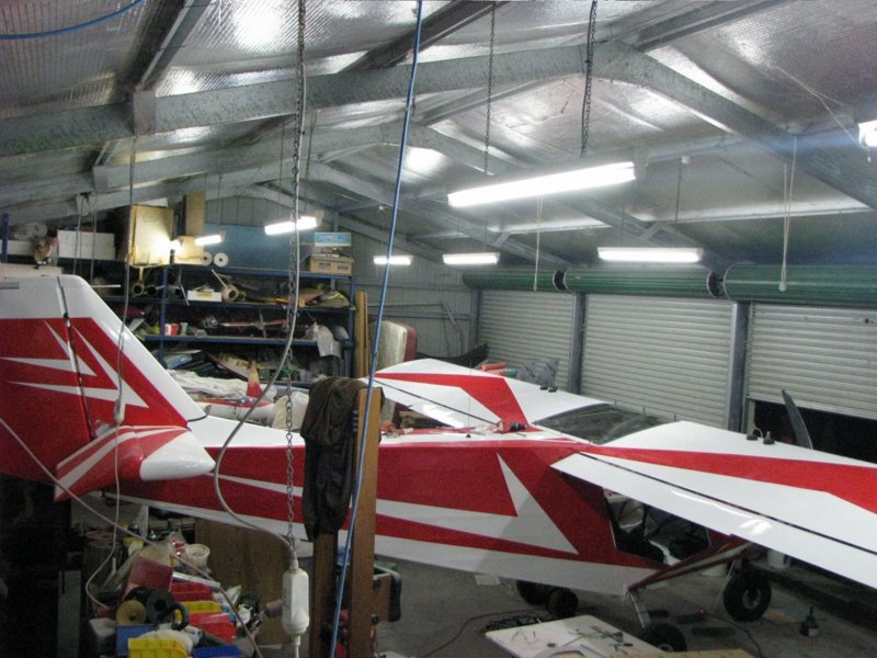

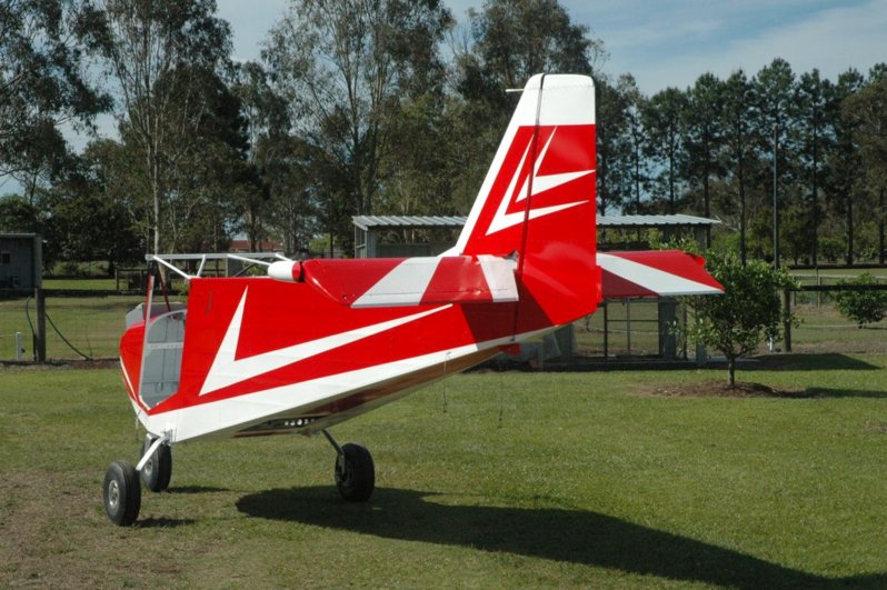

Kyle Communications Posted April 11, 2013 Share Posted April 11, 2013 Mark:Does the Sav come pre-painted, or did you arrange that locally, or do it yourself? I ask, because painting was one of the aspects of building that really daunted me. I wasn't confident of doing it properly and having it done professionally seemed like it could get very expensive. The absence of requirement for painting was one of the big attractors to the Nynja for me. Hi Scott The sav kit comes with every nut and bolt and rivet it comes with some "black goop" which gets brushed on where any two pieces of alu meet for corrosion protection it also comes with a complete set of analogue instruments even the battery. The only things you do not get with the kit is the radio and antenna and the painting. You even get the battery. I painted mine myself as I have a lot of experience with painting in another life...I used to spray paint cars at the ford assembly plant in Brisbane it was my first job out of school before I went off to be a sparky. I have always painted my own RC models etc and a few cars I have reborn over the years. I asked around for a pro paintjob on a sav or similar size aircraft and got prices from $6000 to $10000. I did mine myself Total cost of all the etch primer, undercoat and top colours all high quality paint was around $1000. I have all my own spray equipments etc here . Spray painting is not hard you could learn to do it in just an hour or so if someone shows you what to do. The technique for how to spray and the distance off the surface and the speed you travel the gun at of course there is paint consistency but again it is all pretty easy to get in your head. The biggest issue is the preparation of the surfaces that is what takes the time. That is the part that almost broke my spirit I spent so much time and effort scotchbriting every piece of aluminium and all the undercoat sanding was a huge task. My next aircraft will be somewhat different. I will not have the middle undercoat. You can get a etchprimer that is also a undercoat then just use a topcoat so it leaves out that middle sanding part which is the part that made my build the hardest. Painting a cloth covered aircraft would be quite easy as there really isn't too much sanding required and the colour of the cloth would mean you dont have to put too much paint on either to make sure you get the colour depth you can do a couple of nice light coats which of course you wont get any runs then. If you build another one Scott I can show you how to do it...it is very easy and takes a little practise thats all. Attached are some pics showing the progress.....it took about 3 months or so to finish all the painting that is what nearly broke me. If you have the spare cash well of course get a pro to do it but the major part of the money you pay him is for all the prep that must be done the paint and the actual painting is really only a very small part of the cost...it is all the sanding and prep and masking that takes up all the money Mark 1 2 Link to post Share on other sites
cscotthendry Posted April 11, 2013 Share Posted April 11, 2013 They are a nice looking a/c! And nice to fly too. Reasonably quick, but very forgiving in the landing. Hi Scott I painted mine myself as I have a lot of experience with painting in another life... Mark Mark: Yup, that's about how I thought the process would be. Daunting for me, to say the least. The attraction of the Nynja was threefold: One, that you can build one with common hand tools, Two that it is constructed with all straight AL tubing (ie no "special" parts) and three the fibreglass shell looks great right out of the box, just stick on the stripes and away you go. NO, repeat no painting required. Thx for the pics. Very interesting... 1 Link to post Share on other sites
lark Posted April 11, 2013 Share Posted April 11, 2013 I wont tell you what my Sav cost me but it was a fair bit lower than 60k inc all avionics. I am surprised I would have thought the skyrangers were a lot cheaper Sounds great value! Have always liked the looks of savs (never seen one in real life though). Have watched vids and they look a lot of fun. Closest a/c ive flown size wise is a c150. How do they compare handling wise to GA a/c or is there no real comparison? Link to post Share on other sites
Kyle Communications Posted April 11, 2013 Share Posted April 11, 2013 I would imagine the Sav handles similar to the Skyrangers the sav maybe a little more stol thats all. I used to fly a C172 also flew gliders for quite a few years and the Sav is the easiest aircraft I have ever flown they are very forgiving have a unbelievably controllable stall and recovery so much so it is freaky when compared to other aircraft I have flown. The Skyrangers from what I have read and seen I think I have looked at all of their videos seem to fly pretty much the same so either way it depends on what you want to get. Each has their own advantages. There are a lot of both Savs and Skyrangers in europe infact I would say they would be the 2 most popular homebuilts I think ICP have made well over 2000 Savs in the different forms and probably around the same for Skyranger series 1 1 Link to post Share on other sites

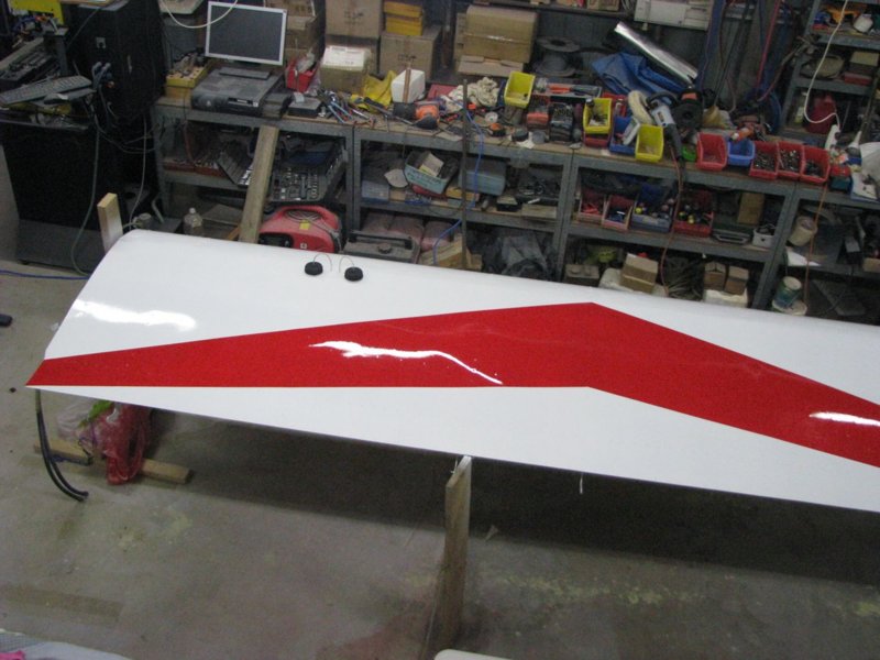

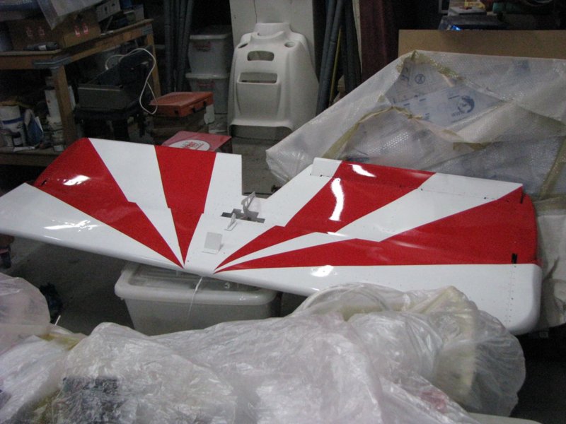

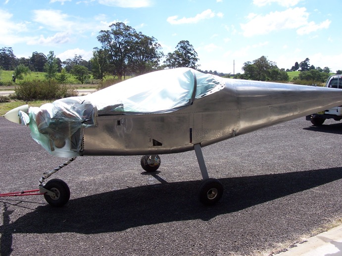

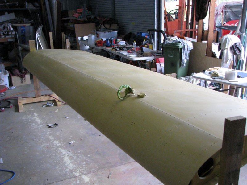

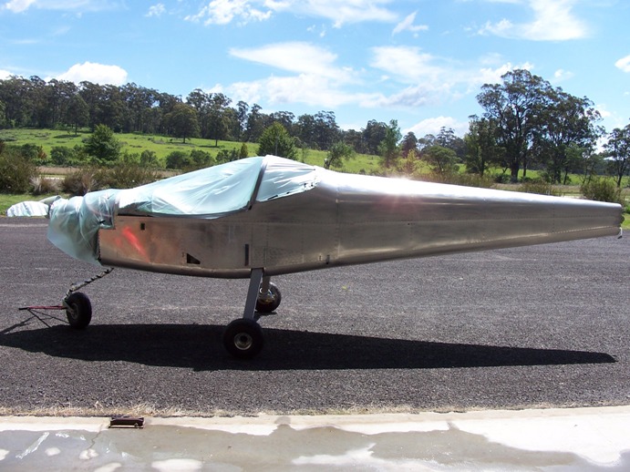

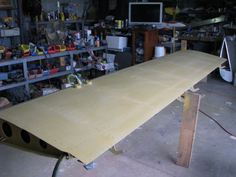

eightyknots Posted April 11, 2013 Share Posted April 11, 2013 That is the part that almost broke my spirit I spent so much time and effort scotchbriting every piece of aluminium and all the undercoat sanding was a huge task. My next aircraft will be somewhat different. I will not have the middle undercoat. You can get a etchprimer that is also a undercoat then just use a topcoat so it leaves out that middle sanding part which is the part that made my build the hardest. Hi Mark, I'm interested in that comment about leaving out the middle undercoat. This leads to a few questions: 1. Why did you decide to put the middle coat on in the first place? 2. Is anything compromised by leaving off the middle coat? 3. Overall, how much time would be saved by not applying the middle undercoat? 4. How much weight would be saved if this middle undercoat was not sprayed on? (this one might be hard to estimate) Link to post Share on other sites
XAIRVTW Posted April 11, 2013 Share Posted April 11, 2013 Hi Mark, I'm interested in that comment about leaving out the middle undercoat. This leads to a few questions:1. Why did you decide to put the middle coat on in the first place? 2. Is anything compromised by leaving off the middle coat? 3. Overall, how much time would be saved by not applying the middle undercoat? 4. How much weight would be saved if this middle undercoat was not sprayed on? (this one might be hard to estimate) Im painting an RV 12 at the moment I do this for a living. I use a product called Prekote this preps the surface you dont need to etch primer if you use Prekote. The catch is you have 24 hours to prime once you have used the prekote. So you only prep what you can prime within that time. Even though I do this for a living Im very happy to help anyone out with free advice. All the above parts have been prekoted & ready for primer. Its not hard just time consuming Preperation. 1 1 1 Link to post Share on other sites
Kyle Communications Posted April 11, 2013 Share Posted April 11, 2013 Hi Mark, I'm interested in that comment about leaving out the middle undercoat. This leads to a few questions:1. Why did you decide to put the middle coat on in the first place? 2. Is anything compromised by leaving off the middle coat? 3. Overall, how much time would be saved by not applying the middle undercoat? 4. How much weight would be saved if this middle undercoat was not sprayed on? (this one might be hard to estimate) 1: I used a paint system that air whitsunday use and they are in sea water all the time so I thought it would be the best 2: You need to use a undercoat if the top coat you are using requires it. This will be on the paint spec sheet 3: About 1 month at least, sanding that epoxy undercoat was a nightmare 4: I estimate I would save a lot. I left way too much undercoat still on the plane. The undercoat was really heavy it was wattyl PR250 maybe 5 to 8 kg My etch was Wattyl super etch the undercoat was wattyl PR250 and the top coat was Protec AU625 PPG do a easier system the undercoat is a etch and then just the tup coat 1 Link to post Share on other sites

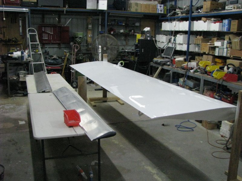

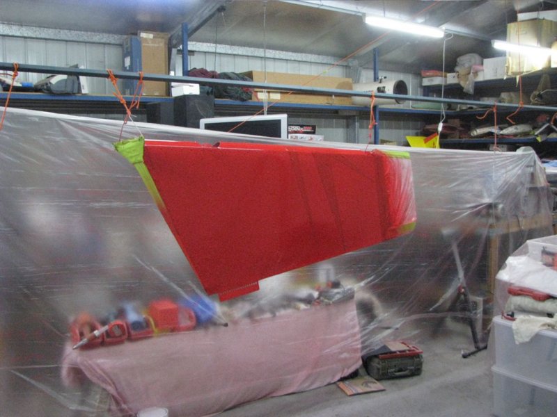

Kyle Communications Posted April 11, 2013 Share Posted April 11, 2013 Im painting an RV 12 at the moment I do this for a living. I use a product called Prekote this preps the surface you dont need to etch primer if you use Prekote. The catch is you have 24 hours to prime once you have used the prekote. So you only prep what you can prime within that time. Even though I do this for a living Im very happy to help anyone out with free advice. [ATTACH=full]21571[/ATTACH] [ATTACH=full]21572[/ATTACH] [ATTACH=full]21573[/ATTACH] [ATTACH=full]21574[/ATTACH]All the above parts have been prekoted & ready for primer. Its not hard just time consuming Preperation. So you use prekote then a undercoat and then a topcoat? so there is still a 3 coat system?....what about the PPG system only 2 coat system Link to post Share on other sites
cscotthendry Posted April 11, 2013 Share Posted April 11, 2013 Hi Mark, I'm interested in that comment about leaving out the middle undercoat. This leads to a few questions:1. Why did you decide to put the middle coat on in the first place? 2. Is anything compromised by leaving off the middle coat? 3. Overall, how much time would be saved by not applying the middle undercoat? 4. How much weight would be saved if this middle undercoat was not sprayed on? (this one might be hard to estimate) Ahh, this is starting toventure into thread hijack territory. Maybe a new thread is in order. 1 Link to post Share on other sites
Kyle Communications Posted April 11, 2013 Share Posted April 11, 2013 Very true Scott...sorry about that Link to post Share on other sites
cscotthendry Posted April 11, 2013 Share Posted April 11, 2013 Very true Scott...sorry about that Very interesting topic though. Link to post Share on other sites
XAIRVTW Posted April 11, 2013 Share Posted April 11, 2013 So you use prekote then a undercoat and then a topcoat? so there is still a 3 coat system?....what about the PPG system only 2 coat system Prekote is a liquid you use with scotch brite you then wash the part down with water dry then prime. If the aircraft is painted in HS it is only 2 coats, If it is painted in COB then it is 3 Link to post Share on other sites
