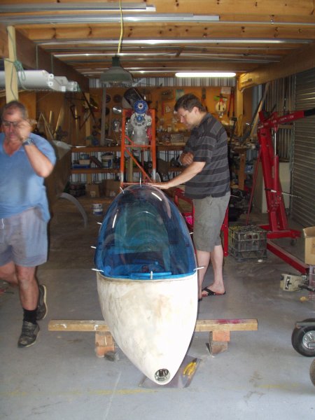

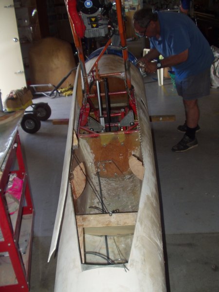

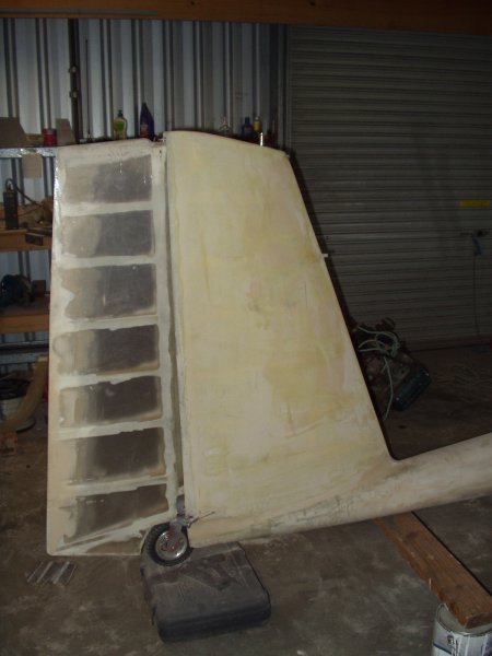

Garry Morgan Posted October 13, 2015 Author Share Posted October 13, 2015 Progress is the motor and doors are working, the electric U/C is now going well. The canopy was cut into the glass frame today the frame was a big job getting all the form work in place to lay it up. A few more weeks fine tuning parts to work better. Then the wings can be constructed. These will be the easier part of the build, I've found the building of the tail and fin foam sandwich construction easy going and the biggest problem with glass is the finishing. But with the 60ksqm foam which is very hard holds its shape, when the glass is layed over it using a straight edge to pull the resin over gives a good lay up and very flat. Just a layer of filler sanded off with a machine sander ( im getting to old for hand work) the finish was good enough for high fill . The idea is not to have much filler on the job as this shrinks at different rates and you lose the 4 thou roughness after a few months required for laminar flow. Most if not all parts have been made at least two - three times to make it all work some jobs have been done 20-30 times. By the time it goes to planes all will have been worked out to make everything fit and to be able to work around components. it is a very tight fit for all parts in the wing motor area. The tail has come out heavy but that is learning what is needed. 4 1 Link to comment Share on other sites More sharing options...

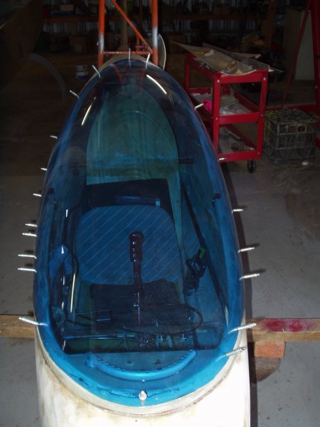

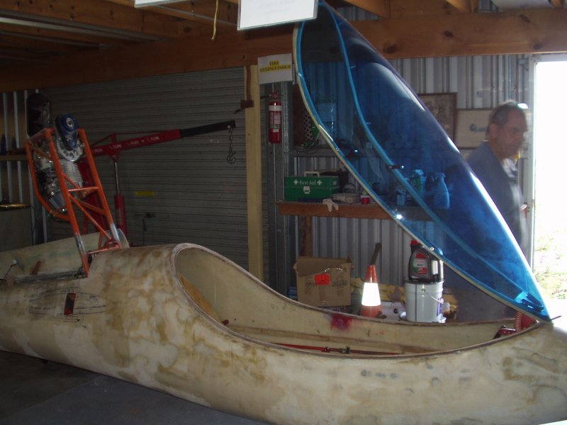

Garry Morgan Posted October 19, 2015 Author Share Posted October 19, 2015 Canopy fitted hinged, taken mold off canopy to mold window. many many small mods to make every thing work as it should. Most of the fuse is done . The fuel tank shape is very strange to fit around the BRS U/C and steel frame. Not to far to start the wings after testing the spar joint 75% out and outer section. 1 1 Link to comment Share on other sites More sharing options...
