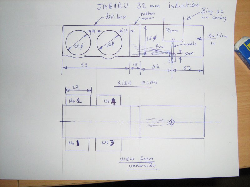

bexrbetter Posted April 17, 2016 Share Posted April 17, 2016 Today I took off the carby and had a look at things.The fuel comes in at 5mm from the throat bottom , which is only 88mm from the take-off to cylinder no.4 at the distribution box. You can see how tilting the top of the carby away from the hot cylinder brings the fuel plume closer to the take-off to the hot cylinder.I don't think the fuel has had time to mix uniformly with the airstream and no.4 is getting more air and less of the rich plume than is wanted, especially at full throttle. What about putting a small scoop out from the no.4 take-off to divert part of the fuel-rich plume into no.4? Think of the take-off hole to no.4 at the distribution box just downstream of the carby. Suppose a "finger" came out of this hole into the richer part of the airstream to divert some of this richer plume into no.4 Would this not richen no.4 at the expense of ( mainly) no.2? ( no.2 is the take-off downstream of no.4) I can't believe that I am the first to think of this... does anybody know of experiments along these lines? Yes Bruce, it's exactly how it works and is actually that logical and easy, i.e. fuel has a lot more weight and inertia than air wanting to travel straight when the air suddenly bends, eg; the air turns without the fuel (lean). These sorts of experiments to help deviate the heavier fuel's path will yield results and do mostly work in logic. Not experiments either, V8 production and aftermarket intake manifolds have been doing it forever, usually a small dam is put at the entrance of typically rich cylinder's runner, on the floor of the plenum and sometimes a trench leading into lean ones. Other more technical tricks are used also. Can you offer some drawings or good pictures of the intake manifold and layout? 1 Link to comment Share on other sites More sharing options...

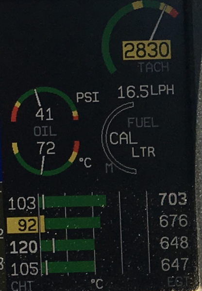

aj_richo Posted April 18, 2016 Share Posted April 18, 2016 I have an Aerocarb/Aeroinjector on my 2200 (2012 hydraulic lifter), which gives manual mixture control. Instrumentation is a Dynon 180 with 4 x EGT/CHT and fuel flow. I find the fuel distribution on mine at 2850/2900 RPM tends to run rich on 3 and 4, leaner on 1 and 2. Number 1 is the leanest. Maybe because of the longer intake tubes.. I dunno. #3 CHT is always the hottest. I should take some air from #2 and duct it across the engine to #3. I manage fuel flows using the mixture control, I expect to see 25Ltrs per hour on takeoff and EGTs below 700. If they creep over I tend to back the throttle off slightly. Cruise I will lean to around 15-16 litres per hour, any more and it will start to give little burps. EGTs #1 will be around 700-710C, #2 will be around 680C, 3 and 4 around 640C The early aerocarbs are a little rough with their manufacturing tolerances and RPM/mixture tends to wander a bit. This is a shot of my panel cruising at 3500' to Ehuca last Saturday. Fairly typical numbers, I think OAT was around 12C. Link to comment Share on other sites More sharing options...

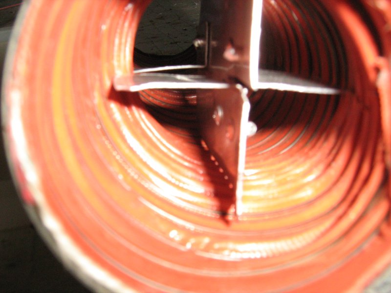

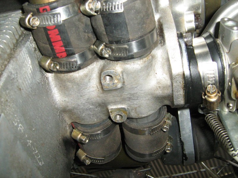

Bruce Tuncks Posted April 19, 2016 Author Share Posted April 19, 2016 Here's the setup. I guess it looks old-fashioned to guys with new planes. The first pic is the underside of the distribution box. The second pic is the crude and apparently quite ineffective flow straightener in the SCAT hose coming into the carby. The third pic is the ineffective "turbulator" wire in the carby outlet. The last pic is the internal dimensions of the inlet flow system. Link to comment Share on other sites More sharing options...
bexrbetter Posted April 19, 2016 Share Posted April 19, 2016 I would start some experiments with a bit of tube, cut on an angle, extended into the plenum to literally 'catch' some fuel. Link to comment Share on other sites More sharing options...

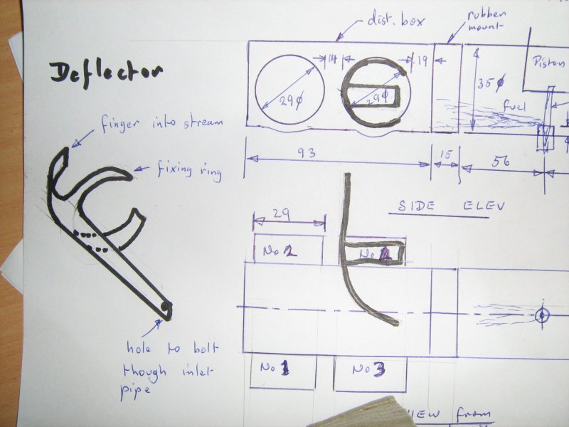

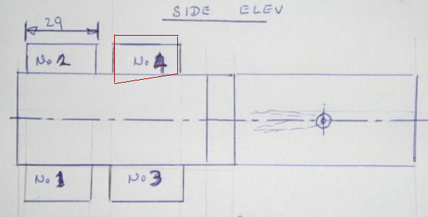

Bruce Tuncks Posted April 20, 2016 Author Share Posted April 20, 2016 Thanks Bex, I had something much more drastic in mind. Like a finger coming out of the no4 pipe right into the stream. After the things I've tried that did nothing, I thought it was time I did something too much. What do you think this would do? On the sketch, the long tail bit with the hole is to fix the thing where the bolt will not interfere with the rubber joiner bit. Link to comment Share on other sites More sharing options...
aj_richo Posted April 20, 2016 Share Posted April 20, 2016 Assuming you're making it out of metal, Id be worried about potential fatigue and sucking parts it into the cylinder.. 1 2 Link to comment Share on other sites More sharing options...
