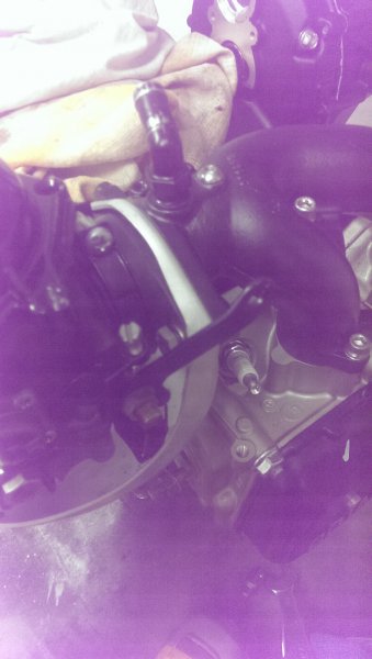

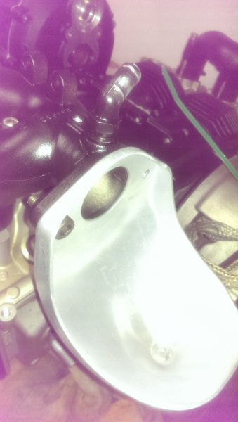

Lyndon Posted May 20, 2016 Author Share Posted May 20, 2016 I'm perplexed. It's a bucket and was expecting it to handle a failure of the needle and seat. This is of no use except the odd drop from a carburetor that is not in good order. It needs a 3/8 or 1/2 drain be of any use. Lucky if I have an 1/8. I will fit some drains that actually may work . Lyndon Link to comment Share on other sites More sharing options...
Lyndon Posted May 22, 2016 Author Share Posted May 22, 2016 I'm not quite sure. Manifold to rubber carb mount I had an o ring. Now I fit the trays. They use the o ring to the Manifold. The rubber carb mount now has no o ring or gasket. The manual shows a gasket but not needed for the uls. Thoughts please from someone who had first hand experience. Thanks Lyndon Link to comment Share on other sites More sharing options...
