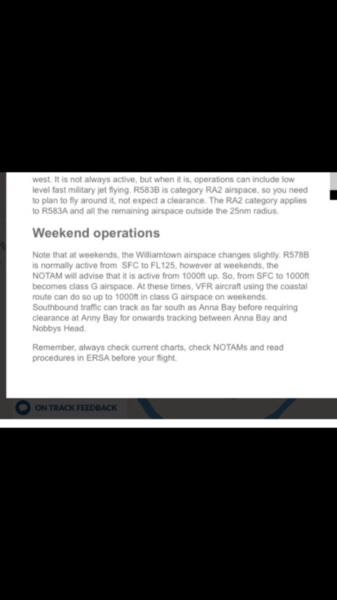

Roscoe Posted December 15, 2020 Share Posted December 15, 2020 Point taken Skippy, As Roundsounds said, Victor 1 is not hard, but can be challenging st 500ft in turbulent conditions! Here is another scenario.... Fly to Camden, land and refuel. The Controllers at Camden are very helpful and all you have to say is UNFAMILIAR with Camden and they will talk you in. Then, Camden to Prospect Resv (easy to find), across to Parramatta, again easy to find with its high rise buildings and Rosehill Racecourse, then up the lane to Patonga. There are very good briefing notes on navigating the Lane, and strobe lights at Pennant Hills to keep you on course. At weekends, you may find that Williamtown is released to 1000ft coastal, so you can remain in Class G along the beach. The Briefing Office and Notams will confirm this on the day. My offer to elaborate on the above remains if you wish. 2 Link to comment Share on other sites More sharing options...
Roscoe Posted December 15, 2020 Share Posted December 15, 2020 The pic below was taken from a Airservices or CASA Flying School wall chart a couple of years ago. Need to check if its still valid and applicable. As I said, read Notams and Contact Briefing Office on the day Link to comment Share on other sites More sharing options...

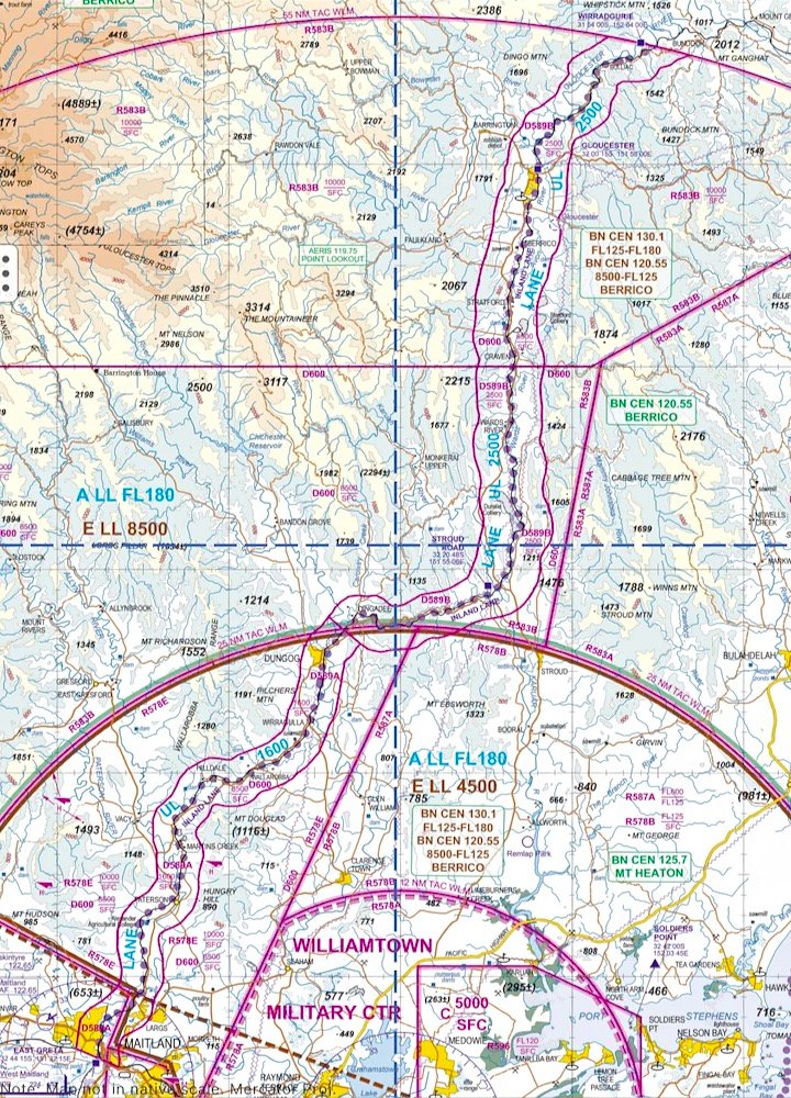

Garfly Posted December 16, 2020 Share Posted December 16, 2020 (edited) The back lane behind Willy is a pleasant and interesting trip on a nice day. Again, it is something you might want to do with an instructor first (round trip ex Taree or Cessnock or Maitland?) though it's not hard once you've done it. LL has now been raised to 2,500' (AMSL) north of Dungog. It takes you up a lovely valley with Gloucester at its top end. Edited December 16, 2020 by Garfly Link to comment Share on other sites More sharing options...
Ando Posted December 16, 2020 Share Posted December 16, 2020 1 hour ago, Rodj said: Thanks all! @Roscoe, your Camden scenario was the kind of thing I guess I had in mind and I wouldn't mind a chat when I get a chance to sit down with the chart in front of me. @KRviator that also makes lots of sense. I might try one each way. On the fuel scenario, flying from Moruya puts me at the limit of my theoretical (conservative) endurance reaching Camden Haven if I have my 45min + 15% reserve going the longer way around. In reality if I get to a decent altitude and can lean her out I might use a lot less, but I'm being cautious with my lack of experience. WRT Scone, I was just going off the current notam but you've filled that info out nicely KR. For a bit more background to my question and the discussion on my experience level: Canberra is pretty straight forward, but I've observed that the ERSA and other published info is one thing but the seemingly preferred or "normal" routes and procedures are another. at times. Flight plan and ring them up it will be ok Link to comment Share on other sites More sharing options...
skippydiesel Posted December 16, 2020 Share Posted December 16, 2020 3 hours ago, Garfly said: The back lane behind Willy is a pleasant and interesting trip on a nice day. Again, it is something you might want to do with an instructor first (round trip ex Taree or Cessnock or Maitland?) though it's not hard once you've done it. LL has now been raised to 2,500' (AMSL) north of Dungog. It takes you up a lovely valley with Gloucester at its top end. Only did it once - turbulence HORRIBLE combined with very narrow lane and high terrain - quite the work out. No plan to return any time in the future. 1 Link to comment Share on other sites More sharing options...
