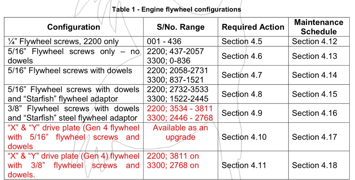

I should have worried about the flywheel bolts I now know.
 My Lithium turns the engine painfully slowly, then gradually speeds up as it warms. Gentle on the flywheel bolts.
Restarting when warm is not. Almost instantly fires, no doubt putting enormous loads on those bolts.
Mine has dowels, so I’m less stressed, but should soon check bolt tension.

BRUCE- BTW the engine in my aircraft
a 2010 J230D, was replaced in 2013 with the new last gen3 I have now (that I also rebuilt)
you know why they had to replace it - in the field, flying, the flywheel fell of in flight......
they landed on a road (they were flying along) out western QLD without issue.

It would have made considerable noise and probably vibration before that happened. Always investigate anything unusual. Engines never fix themselves. I've heard flywheels loose on cars and you can't miss it admitted they are heavier and more of a clunk  With the prop on one end and a flywheel on the other it's not an ideal set up .Nev
