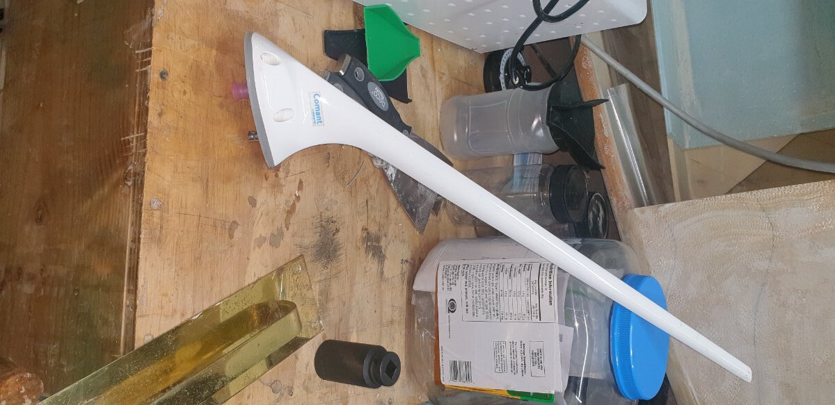

Hi Skippy I have a dual VHF/GPS antenna.  I bought it but it did not get into the air.  I upgraded to WAAS.  This is not a waas antenna. Let me know if you are interested.

Nice looking antenna - already have a Commant whip style , with 45 degree bend, for ground clearance (belly mount).
This is what the Dynon SV-GPS-250 & 2020 looks like; If there is no argument against, I will have it on my "glair shield" (top of instrument panel) along side my Garmin Glo Blue Tooth antenna for my Ipad/ OzRunways. I think it will get excellent reception in this location, reduces the amount of wire that will need to be secured and will make use of an existing access hole, that I have cut into the glair shield,  just for this sort of situation.
