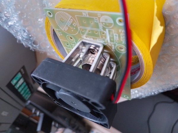

danny_galaga Posted February 11, 2023 Author Share Posted February 11, 2023 (edited) On 24/01/2023 at 10:41 AM, Kyle Communications said: If you look back quite a few years ago in my original savannah build blog you will see the multi outout one I made. it uses the LM338 its a great device so simple to use but heatsink is a big must. I first used tem some 20 years ago in glow plug drivers for RC aircraft. Set the voltage out and it would auto regulate the current for the glowplug...I made literally 50 for the guys in the model clubs. I keep LM338's always in the drawer at the workshopg Just put together the little kit, leaving out the bits I didn't think I needed (rectifier, voltage display etc) . Worked. Tried to put a load on it by connecting a USB powered desk lamp. Weird performance but I put it down to the fact I was getting a 12v supply from a 240v switch mode supply. Then I did something and I think I killed it. Are lm338 easy to kill? Edited February 11, 2023 by danny_galaga Link to comment Share on other sites More sharing options...

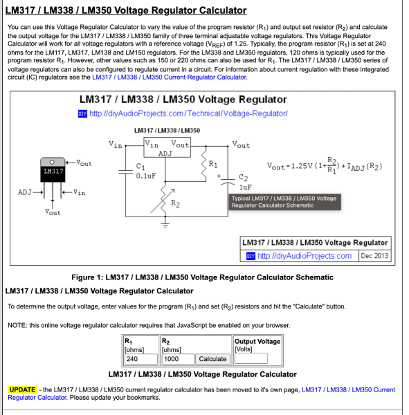

Kyle Communications Posted February 11, 2023 Share Posted February 11, 2023 The 338 is a pretty hardy device...from memory you need a capacitor and 2 resistors. or at least 1 resistor to set the output voltage. thats it but remember 12v in and 5V out you are dropping 7 V across the regulator. So using ohms law you want 2amps to charge your Ipad or whatever thats now 14Watt of wasted power all done in heat. if anything will kill the 338 is not enough heatsinking Oh the capacitor is very important. it stops self oscillation and maybe some lower value 10nf or 100nf ceramic bypass caps would be a good thing too Mark Link to comment Share on other sites More sharing options...
Kyle Communications Posted February 11, 2023 Share Posted February 11, 2023 Here is a circuit..this is all you need. Even powering from a SM supply wont be a issue Use a pot to set the volts then remove the pot and measure it and then put a fixed resistor of the same value in that spot..will be more stable Link to comment Share on other sites More sharing options...
danny_galaga Posted February 12, 2023 Author Share Posted February 12, 2023 (edited) Yep, already wired the supplied pot remotely with a view to measuring and replacing with a fixed value. Great minds eh 😃 Cooling will be fine. It's why I bought a kit. I looked at how to work out what sized heat sink I would need and the maths didn't look fun 😄 Note that there are more caps than needed. The kit covers a few bases, including an LCD voltage meter. I left out what I KNEW I didn't need, and left in what I wasn't sure about. The fan was powered by a lm7812 to give it a constant 12v . Since I'm only feeding it 12v I just left it out and bridged it. Fan wails like a banshee though, I'm sure it doesn't need to be THAT fast! So might put in a 1-5 ohm resistor to take the edge off it... Edited February 12, 2023 by danny_galaga 1 1 Link to comment Share on other sites More sharing options...

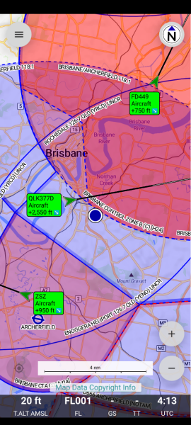

danny_galaga Posted February 13, 2023 Author Share Posted February 13, 2023 (edited) I ended up getting a Lenovo m8. Some of my geeky friends recommended it as really good value for money. And googling around, I found at least one pilot using one. And air Norway or something use fancier Lenovo's exclusively for their EFG 😃 I live somewhere between Archerfield and Brisbane, so that's been handy for testing! @coljones VID_20230212_222710.mp4 Edited February 13, 2023 by danny_galaga 1 1 Link to comment Share on other sites More sharing options...
