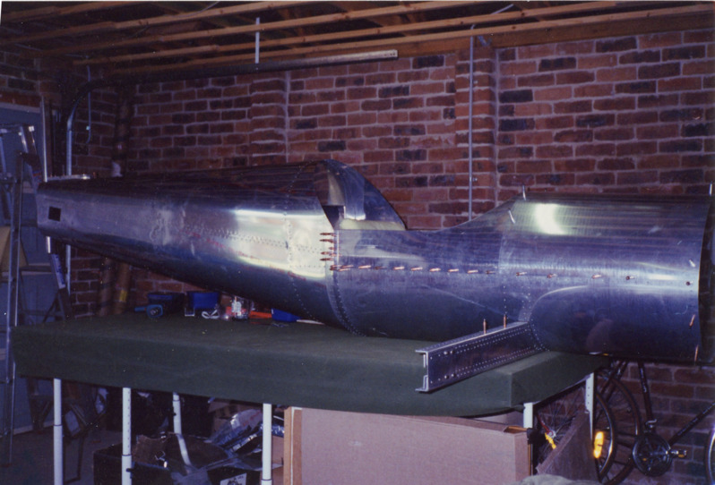

flyvulcan Posted July 1, 2012 Share Posted July 1, 2012 The Hummel construction technique is very easy, once you have the hang of basic metalworking. I have a set of HB plans and Teenie 2 plans that I used as a basis for a project I worked on a long time ago. I really enjoyed the build process. It was very simple. Mind you, at the start, I would look at a piece for a few hours to try to work out how to build it. After a while, I could look at a piece on my plans and straight away know how to do it. Here's a pic of my project: Cheers, Dave PS It never got finished as it was supposed to be a BF109 replica but after I got half way through the build, I decided that I wanted any replica that I built to look more accurate than the one that I was working on, so I ended up considering this project a learning experience in working with metal. Link to comment Share on other sites More sharing options...

flyvulcan Posted July 2, 2012 Share Posted July 2, 2012 Hi Phil, My BF109 was a totally new design that incorporated design features from both the HB and T2. I "designed" it myself. With the need for an interstate move at the time, I donated the airframe that I had completed to the local sport aircraft club in case any members wanted to finish it as a static display for kids (big and small) to sit in and make noises when the club held its' fly-ins. I don't actually know what came of it... I still have the HB and T2 plans. Cheers, Dave Link to comment Share on other sites More sharing options...

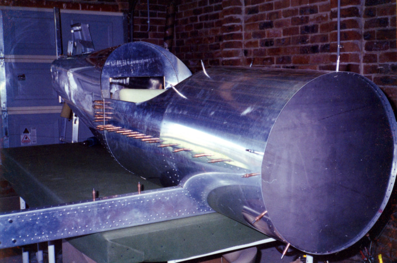

flyvulcan Posted July 2, 2012 Share Posted July 2, 2012 PS Here's another view of my project: I had completed the undercarriage, outer wing spars, rear spars, ribs, vertical stab ribs and skin so it was progressing quite well at the time... Cheers, Dave Link to comment Share on other sites More sharing options...
