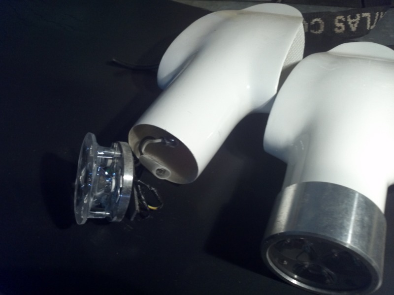

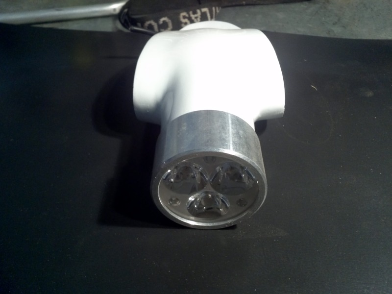

jetjr Posted September 13, 2012 Share Posted September 13, 2012 Heres what Ive built The guy sells a few different types, this is the only one which fits, certainly not water proof but pretty well drained. The fiddly part was that the alloy back plate had to be machined down so needed dissasembly and rewiring to do this Fits std light housing - NVFR type they are much larger I have not installed them yet and there could be RF problems Perhelion wig wag is slow left right type, can get with or without switch and easily wired for constant on if ever needed. Link to comment Share on other sites More sharing options...
