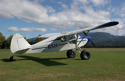

Do nothing to the paddock, just get one of these.
Kiwi.

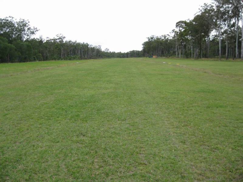

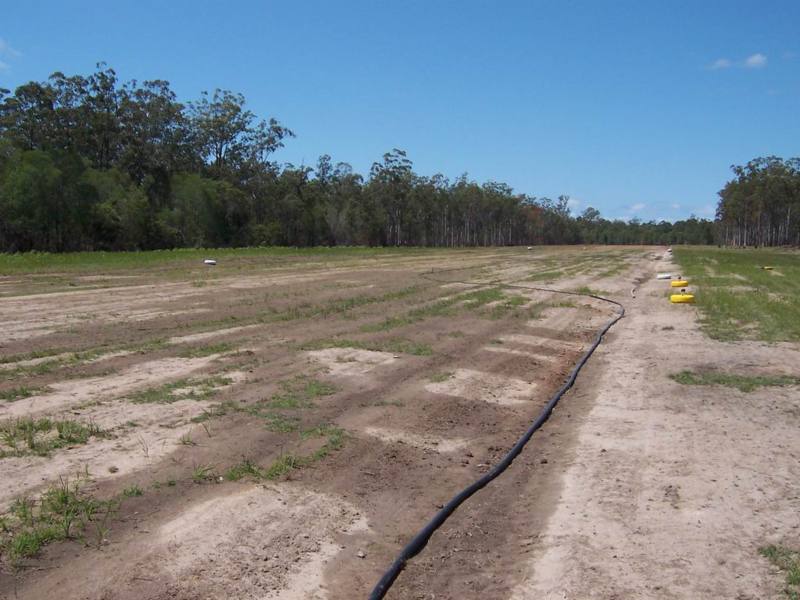

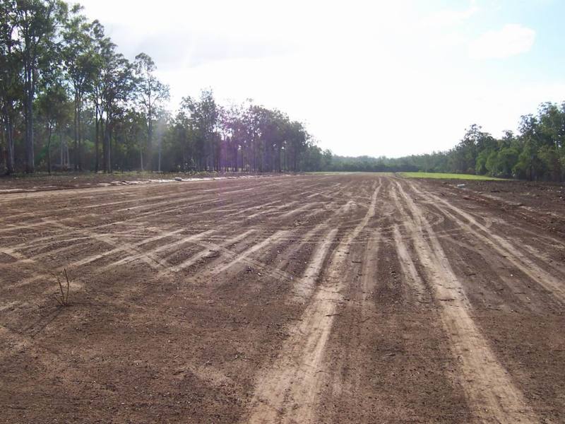

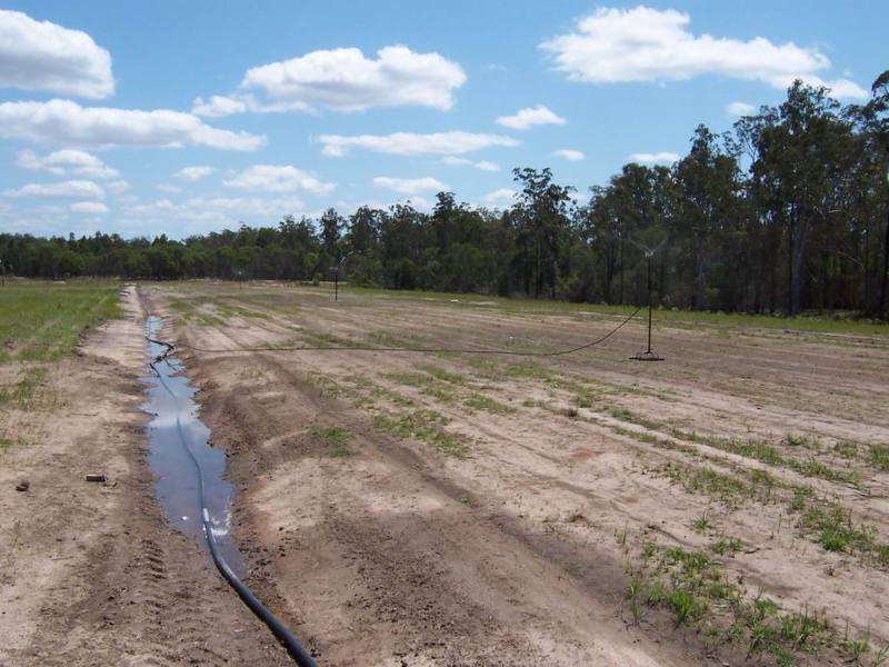

Definately the best to grade it with a slight fall off to the sides. Then tow a sheet of mesh behind a car to level and pick up any small sticks.
I then seeded mine with a 40 to 1 mixture of Siberian Millett and Couch seed.
  • Like 5
Definately the best to grade it with a slight fall off to the sides. Then tow a sheet of mesh behind a car to level and pick up any small sticks.I then seeded mine with a 40 to 1 mixture of Siberian Millett and Couch seed.
Very interesting flyhi, did you have to install any drainaige in the channels which were created on both sides ?
Very interesting flyhi, did you have to install any drainaige in the channels which were created on both sides ?.
No it just drains away naturally. I have taken off one morning after 50mm of rain overnight in a GA aircraft. (AA5B)

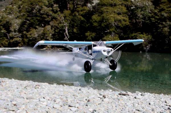

Flyhi, your strip is a credit to you, appreciate the pics, it seems that this is the way to go. I would like to put C172 tyres on the J however this is not possible under the rules, at least in Australia. If I can obtain the same result as Flyhi I will be more than happy.
