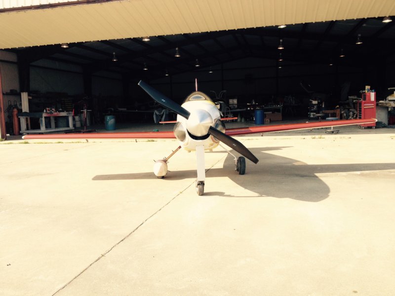

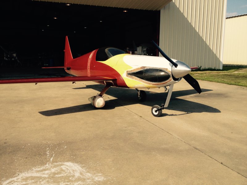

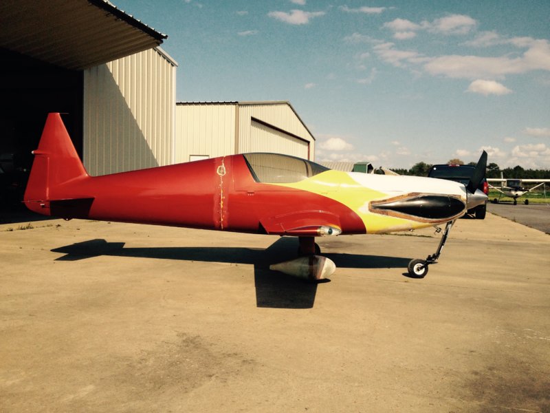

flyvulcan Posted June 18, 2015 Author Posted June 18, 2015 And here we are a few months later. Lanny has been busy sorting out the engine installation and a multitude of small issues that have needed to be resolved. Additional CHT probes have been installed, exhaust pipes have been fully wrapped in insulation, spray nozzles for the radiator have been installed, washers and bolts have been replaced, wiring has been redone, the engine indication system (EIS) has been set up and calibrated, brake components have been replaced, flight control runs have been checked, wheel pants have been fabricated and installed, fuel system and filters were checked, oil filters were checked, a full annual inspection has been completed... The list goes on but we are now very close to that first post-restoration/modification test flight. A few days ago, the aircraft weighing was conducted in anticipation of the flight. The aircraft was then taken out for additional low and high speed taxi runs down the runway and all appears to be in order. Weather permitting, we are hoping for the first test flight this coming weekend. After such a long preparation, we are hanging out to see what sort of performance we get from it with the Rotax in it. I shall report here once I have some numbers. I have to admit to thinking that this is a very good looking aircraft. When we get this one repainted after all the work that's been done on it, I'm sure it will receive admiring looks wherever it turns up (hopefully Oshkosh this year, that's now the target after missing Sun'n'fun). We hope to have a second and third original Bug flying a bit later this year and a fully new build, lighter weight full EFIS Bug towards the end of the year. 2 1
bexrbetter Posted June 18, 2015 Posted June 18, 2015 Looks great and will look even better with the shark teeth just begging to be done at the front, and stitches around the midriff join!
flyvulcan Posted June 18, 2015 Author Posted June 18, 2015 We'll be using the fixed pitch 62x92 Prince prop for initial test flying then probably try the Varia IFA option. It's a budget setup, simple and light. 1
