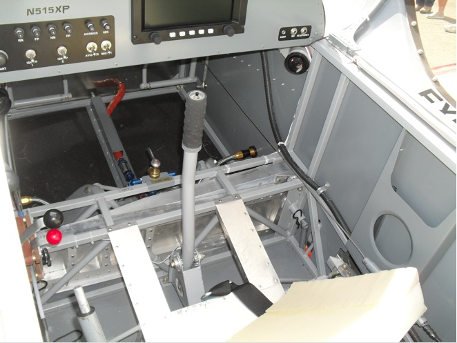

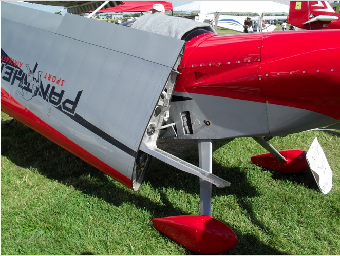

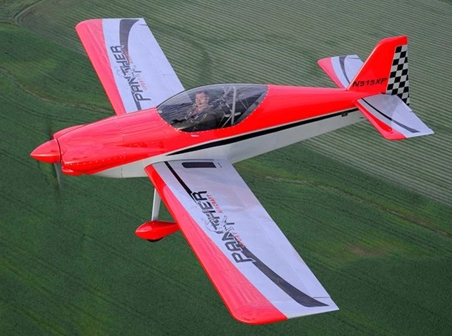

Actually if you're looking to build something in the RV3/4 type range, have a look at the Panther;
https://flywithspa.com/
Looks like an RV, but built simple like a Sonex.
Aerobatic (if VH), they were fairly cheap, don't know about now, and I think a two seat is in the works.
Has folding wings.
I was looking at one at Oshkosh'13, VERY interested...
This is the prototype;
912s, 914, 915?, Corvair, 0-200, 0-233, UL, plenty of choices...
