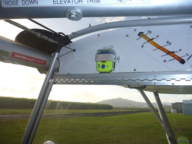

piecrust Posted June 15, 2016 Share Posted June 15, 2016 Kannad xs4 battery replacement $295.00 new model $295.00 no one in Australia can change the batteries. Going to go with gme Link to comment Share on other sites More sharing options...
piecrust Posted June 15, 2016 Share Posted June 15, 2016 Is anyone using this http://kti.com.au/safety-alert-plb/ Link to comment Share on other sites More sharing options...
M61A1 Posted June 15, 2016 Share Posted June 15, 2016 Is anyone using thisPLBs – kti Yep. see my previous posts. 1 Link to comment Share on other sites More sharing options...
piecrust Posted June 16, 2016 Share Posted June 16, 2016 Ordered one today 1 1 Link to comment Share on other sites More sharing options...
Blueadventures Posted June 30, 2016 Share Posted June 30, 2016 Ordered one today Agree. Got one also on Sunday. Road Tech Marine has them $20 off for $269 and battery good until 2027. Fitted it today. 1 Link to comment Share on other sites More sharing options...
