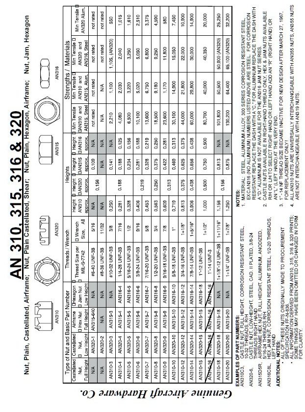

old man emu Posted April 13, 2023 Share Posted April 13, 2023 6 hours ago, Ian said: Not sure if it's been mentioned however one of the key benefits of wired or pinned crown nuts is that they can be verified as "locked". Far more difficult with Loctite or similar. To my mind, that is a secondary, but useful, effect of wiring or pinning a castellated nut. If you have a look where fasteners with a hole in the shank are used they do not usually perform a clamping function. They are usually used for keeping things in place where there is movement, like control surface hinges, or for keeping axle nuts firm against the wheel bearing, but not clamping it against the hub. So there is an allowance for the nut to move in and out for a fraction of the circumference of the shank and a cotter pin prevents the untorqued nut from unwinding itself. Its hard to get the correct torque on a nut while at the same time getting the hole in the shank to line up with a slot in the castellated nut. However, that doesn't apply to bolts with holes in the head of the bolt. These are used where two items are being clamped together and no movement is permitted between the two. In that case, the nut is torqued into place before the head of the bolt is lockwired in such a way as to prevent it unwinding from the nut. Sorry that these are sideways. I can't get them to stay rotated the correct way. 1 1 Link to comment Share on other sites More sharing options...
