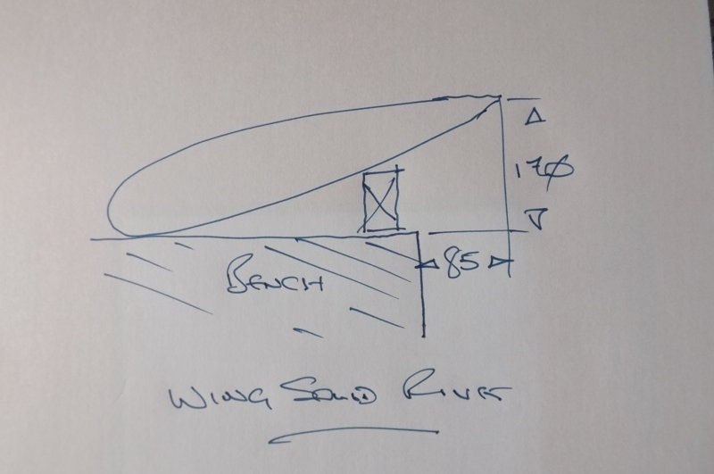

I used the squeeze one handed, with one handle also steadied and aligned against the bench edge. That left my other hand free to lightly pinch the trailing edge.
It was very quick once I got going, and very easy to replicate the same squeeze for each rivet.
On another build, I would try a slightly shorter rivet. The specified rivet is just a little long, presumably for the rudder.

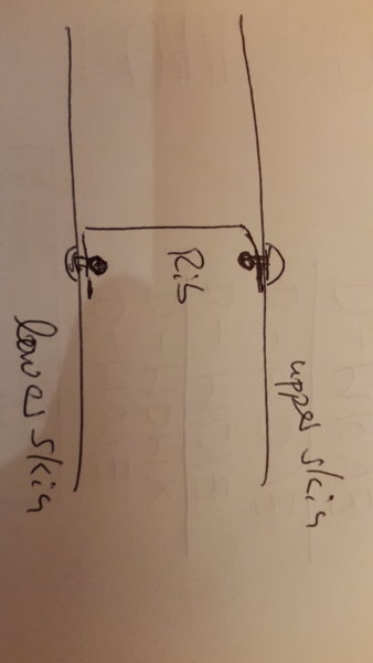

I chokked up my wing along the bench edge as shown in the sketch, so as to be able to rest one handle of the squeeze to the bench edge, with the tool correctly on the rivet head. (Okay, bad sketch, but you get the idea.)

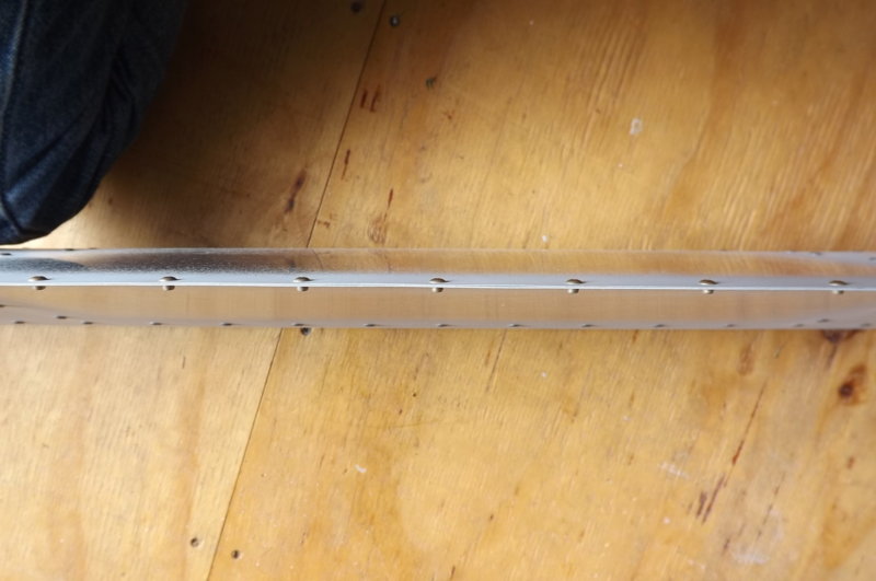

Thanks again for your Help. I'm sure the strongness of my riveting results would be o.k. like you all suggest. But I'm also affraid I might fail in the inspection.
So I ordered the right rivets AN470 AD-3-3 an a propper die.

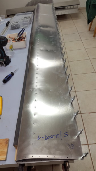

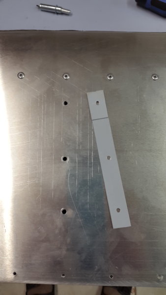

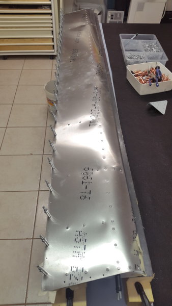

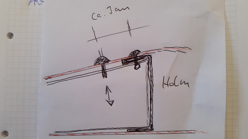

I'm still not satisfied with the upper, aft skin on the flapperons. There is a dent in the place where the first rivetafter the longeron is in the rib. The outline of the rib just don't takes the thickness off the longeron into account, like the ribs of e.g. the rudder does. How did you deal with this? When I see Bobs flapperons, the look nice!!!
The last rivet before the trailing edge in each rib is a problem fouling on the tail of the one coming from the opposite surface. The first gives no trouble, the second give great grief. With slight pressure on the rivet gun, the tail can be offset and straighten the gun as it fires. The standard rivet is really too long for this situation but a good result is achievable with some practice (read drill out the rejects).
No, I disagree. This two rivets have a nice (smart) offset to each other. Maybe this part has changed???
My problem with the upper skin seems to be just optics. Maybe I will try some scrap aluminium as a doubler for the ribs.

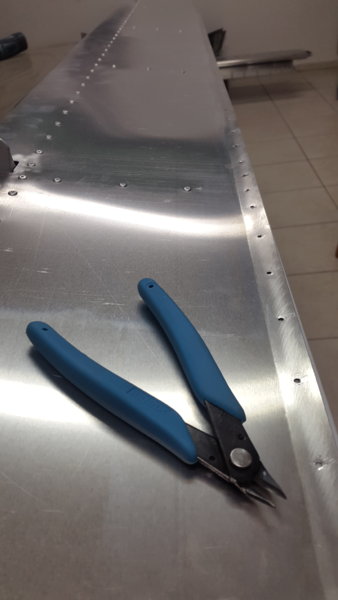

Yesterday I deriveted a flapperon. Very easy with this electronics pliers...
The aft ribs look pulled upward near the longeron. Seems something, with the thickness of the longeron, put in betwen could help.
I will try...
I am interested in those "electronics pliers" Major Tom. Am I correct to assume these were used to snip off one side or the other of the solid rivets? Did you have to modify them
I never was too happy with the trailing edge rivets on the wings, flaperons, rudder or trim tabs when I built my own Sav but after seeing what's possible with the right squeezer, the proper rivets and fitted rivet sets, (thank you IBob) I'm about ready to give it another go. The issue that's been keeping me at bay is how to remove the installed solid rivets without damaging the skins by grinding off the heads or elongating the holes with a skating drill bit.
Hi Dan,
it is something like this. There are many nice types and brands. You might want to round the tip a little, so you don't scratch the skin.
Then just cut of the rivet directly on the skin. The shophead gets of easily and 70% of the rivets fall / jump out instantly.
Xuron 170-II Micro-Shear Flush Cutter: Wire Cutters: Amazon.com: Industrial & Scientific
Just have redone one flapperon. Put a strip alu betwen skin and rib. The doubler is bent over, so the first hole after the longeron gets extra 0,8mm and the following two get 0,4mm. Result is better, but far from satisfiying.
