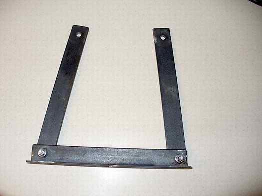

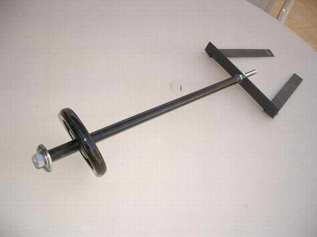

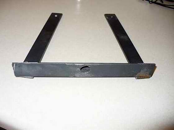

WestCoast Posted January 14, 2008 Author Share Posted January 14, 2008 My gearbox will be removed next Tuesday and sent to Bert Floods in Melbourne as Wal has the rebuild kits in stock. Here are some pictures of a home-made gearbox puller from the USA that I copied when I made mine. 2 x 1/8" x 1 1/4" x 10" flat steel stock 1 x 1/8" x 1 1/4" x 10" angle iron. Drill a hole in the end of the 2 flat stock pieces with a 5/16" bit (for the M8 mounting bolts on the gearbox). On the other end of the flat stock drill another hole for 3/8" bolt. On the angle iron drill a 3/8" hole on each end. You are going to mount the angle iron onto the two pieces of flat stock with a 3/8" bolt. Next drill a hole in the center of the angle iron to accept the end of a slide hammer or dent puller which ever term you like. Your new gearbox puller mounts to the gearbox at the ends of the flat stock with an m8 bolt. Buy two new m8 x 1.25 thread x 1 3/4" long bolts. When you mount this up to the gearbox use a 4-5 washers as stand offs between the gearbox housing and the flat stock steel. This allows it to easily clear the prop hub mount. Then attach the slide hammer and a pull or two later the gearbox is hopefully in your hands. ATTACH]4250[/ATTACH][ATTACH]4673.vB[/ATTACH] Link to comment Share on other sites More sharing options...

WestCoast Posted January 22, 2008 Author Share Posted January 22, 2008 Gearbox Removal [ATTACH]4706.vB[/ATTACH] Removed the gearbox today using a home-made 'puller' and slide hammer. (see pic) Worked just fine and did not take very long to complete. Managed to buy a 41mm long socket for $54 but the expensive bit was the Loctite ($76.00 for the flange sealant (518), thread retaining compound (648) and Loctite 'Chisel' cleaning fluid.) When packed it weighed in at 7.5 Kg and cost $71.20 to send to Victoria on a next day delivery basis. Link to comment Share on other sites More sharing options...
