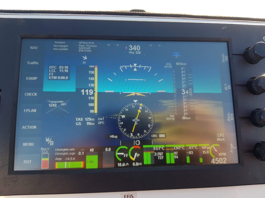

Brett Posted July 18, 2019 Share Posted July 18, 2019 I’ve read the Rotax manual and know the max temps and so on but I’m chasing actual in field CHT temps. At what point would you start to think the engine is getting on the warm side? I’ve just installed a 912 and only have 2.1 flight hours on the (second hand) engine. I’ve only ever flown Rotax’s before mainly in Tecnam’s where they run nice and cool. What temps do people usually see in flight and climb? Thanks ? Link to comment Share on other sites More sharing options...
M61A1 Posted July 18, 2019 Share Posted July 18, 2019 Mine sit around 100-110 in cruise. On a hot day on continuous climb the highest I’ve seen is 130. Zenith 601HD Link to comment Share on other sites More sharing options...
Brett Posted July 18, 2019 Author Share Posted July 18, 2019 Well that’s somewhat reassuring,,, I was thinking mine were overly high. Still very early days in my test flights though. Problem is if I ground run even for relatively short times it just continues to rise rather rapidly,,, in the air though temps come down. Link to comment Share on other sites More sharing options...

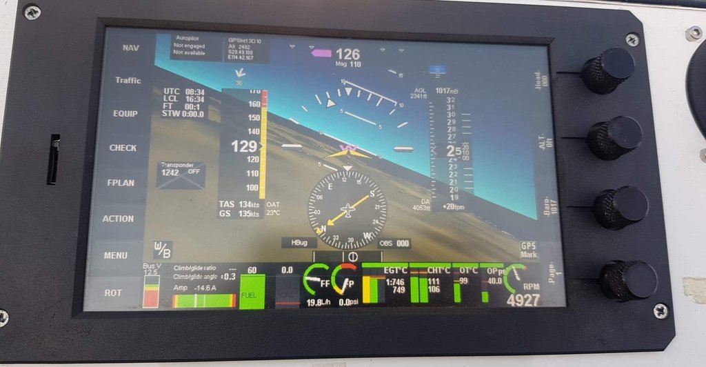

skippydiesel Posted July 19, 2019 Share Posted July 19, 2019 Hi Brett, I confess to being an "old fart" not used to interpreting electronic read outs so hopefully no offence will be taken. I know the Sonex has the reputation of being a "hot" little ship specially when motivated by a 912 (80-100 hp ??) but the numbers on the screen you have posted seem to be "all over the shop"; Air Speed 134 knots - okay if speedy reputation actually true. Fuel flow 19.8 lph - seems very high for rpm - I only get this sort of consumption in climb out and about 18 lph in high speed cruise @ 5400 rpm (ground adjustable prop set to advantage climb) 912 ULS RPM 4927 - seems low for the fuel burn, are you using a CS prop? "Problem is if I ground run even for relatively short times it just continues to rise rather rapidly,,, in the air though temps come down." - sounds like an insufficient air flow issue, probably related to the shape/proximity of the prop where its "sweeps" past the cowl inlets, not generating enough air flow - in the air, the forward movement generates enough air flow to keep engine cool. Link to comment Share on other sites More sharing options...
Brett Posted July 19, 2019 Author Share Posted July 19, 2019 Well picked up with the fuel flow per rpm ? -I have yet to fit a return flow sender so fuel flow is not reading correctly -The current (amp) sensor is also not fitted so defaults to that number. -Running the recommended Sensenich fixed pitched prop,, (has too much pitch) -Airspeed indicator was calibrated during my initial 40 hours test period and deemed to be within tolerances and also by flying the square and recording numbers and so on at all different heights etc etc. I have only just started to do the new testing required for phase 1 ,,, I will revisit it but as nothing has been changed in regard to instruments or airframe besides engine so I doubt it’s reading incorrectly. It’s definitely a bit faster with this engine over the Aerovee turbo but not by lots. What I’m mostly worried about is the temp rising when waiting on the hold point or something like that... I need some form of better airflow on the ground. This is why why we have the test period to get the bugs sorted. Link to comment Share on other sites More sharing options...

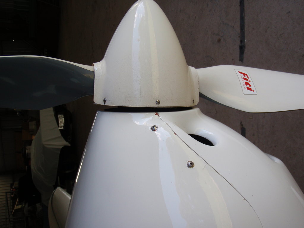

skippydiesel Posted July 19, 2019 Share Posted July 19, 2019 Ok I will,, I really wanted to keep it simple though. Fixed fitch and standard spinner to avoid unnecessary cowling work. There is a Fiti CS but my prop is a ground adjustable, which gives you the chance to "fine tune" the prop pitch to your application (its still a fixed pitch in flight) - there should be no change to spinner or cowling. Where the Fiti design differs from many other props seems to be in the "twist" and cord width (broad blade). This may just "pump" a bit more air through your cowling when on the ground. Link to comment Share on other sites More sharing options...

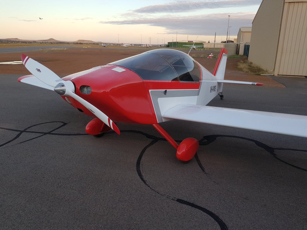

skippydiesel Posted July 19, 2019 Share Posted July 19, 2019 Just thought I might show you a pic of a similar aircraft to yours ATEC Solo, fitted with a 2 blade Fiti (I am the agent for ATEC but not Fiti) Link to comment Share on other sites More sharing options...

skippydiesel Posted July 19, 2019 Share Posted July 19, 2019 The Sensenich props are a similar profile to the prop you show there. http://www.sensenich.com/shop/aircraft/2-blade-rotax-ground-adjustable-propeller/ I dooont think so - check out the unmounted photos. Fiti 2 blades are particularly wide, especially near the root - can be seen well in the side shot of my cowling - hence my suggestion that they may be pumping a bit more air into the cowling openings when aircraft on the ground. Link to comment Share on other sites More sharing options...

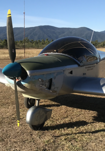

corvairkr Posted July 19, 2019 Share Posted July 19, 2019 G’day Brett, I’ll lay money on your problem being your ducting to your radiator not allowing enough airflow. i’ve recently had to mount my radiator vertically on the engine mount near the Firewall on my 601 HDS and had the same problem. I originally had a Plenum over the radiator fed by various inlets but eventually had to make a NACA duct feeding directly to the face of the radiator to allow effective ground cooling. It now runs waaay to cool but that’s a simple fix with some Aluminium tape. Jason 1 Link to comment Share on other sites More sharing options...
M61A1 Posted July 19, 2019 Share Posted July 19, 2019 I’ll lay money on your problem being your ducting to your radiator not allowing enough airflow Based on post #16 I would have to agree Jason. I put my radiator underneath and while my CHT is relatively high (100-110) my coolant temps never get above 80. My radiator inlet is quite small, but I worked on the 500% rule ( outlet should be 500% of inlet) I suspect my my CHT is as high as it is because the cowl doesn't allow enough air out. It is quite pressurised in flight and even on ground runs it will blow the inspection door open (at idle) if it isn't fastened. But my temps are well within limits so I haven't bothered to fiddle with it. In the pic below the whole rear of the cooling unit is gilled while the radiator lays almost flat. I like how yours is done, I considered doing it that way, but I didn't feel like doing any more work on the cowl. 1 Link to comment Share on other sites More sharing options...

M61A1 Posted July 20, 2019 Share Posted July 20, 2019 Looks the goods/ very pretty. Metal ?? The Fiti is composite. Skip, the Sensenich ground adjustable are hollow composite blades. It weights a little less than the Warp Drive I removed but most of the weight is in the hub, so it has much less inertia than the Warp Drive. I probably would have just bought a Bolly but this one came along at an affordable price. I replaced the Warp Drive after seeing some pics of a Sling in the desert with a departed blade and then finding out that this was more common than I'd like. 1 Link to comment Share on other sites More sharing options...
