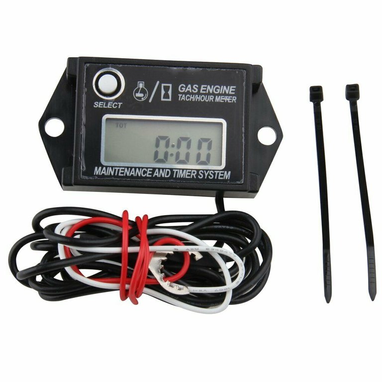

spacesailor Posted July 28, 2019 Share Posted July 28, 2019 Tiny Tacho Has a wire that is wrapped around the spark-plug lead. spacesailor 2 Link to comment Share on other sites More sharing options...

Downunder Posted July 29, 2019 Share Posted July 29, 2019 Tiny Tacho Has a wire that is wrapped around the spark-plug lead. spacesailor https://tinytach.com/gasoline-tinytach Aust dealer. ..... Flexible Drive Agencies Kensington, Victoria PHONE: 1300 36 37 35 Link to comment Share on other sites More sharing options...
spacesailor Posted July 29, 2019 Share Posted July 29, 2019 Tiny Tacho Has a wire that is wrapped around the spark-plug lead. spacesailor It also, Super light, Self-contained, easily fitted AND Cheap ! I should get a commission ?, OR A boot up the Khyber. For blatant Adds. spacesailor Link to comment Share on other sites More sharing options...

spacesailor Posted July 30, 2019 Share Posted July 30, 2019 Frank Thats a very expensive move !. Forget your existing tacho, & Put a "Tiny Tacho" In its place. So quick to achieve your goal. AND no headache either. Rotax is German, so check the German side of things. spacesailor Link to comment Share on other sites More sharing options...

Steve Donald Posted August 4, 2019 Share Posted August 4, 2019 Tiny tach is best and safer the old system used to stop the engine with a tack failure. Your question was replied there is no grey wire on that old 503 Link to comment Share on other sites More sharing options...
Deskpilot Posted August 5, 2019 Author Share Posted August 5, 2019 Thanks guys, I'll change to tach. Link to comment Share on other sites More sharing options...
