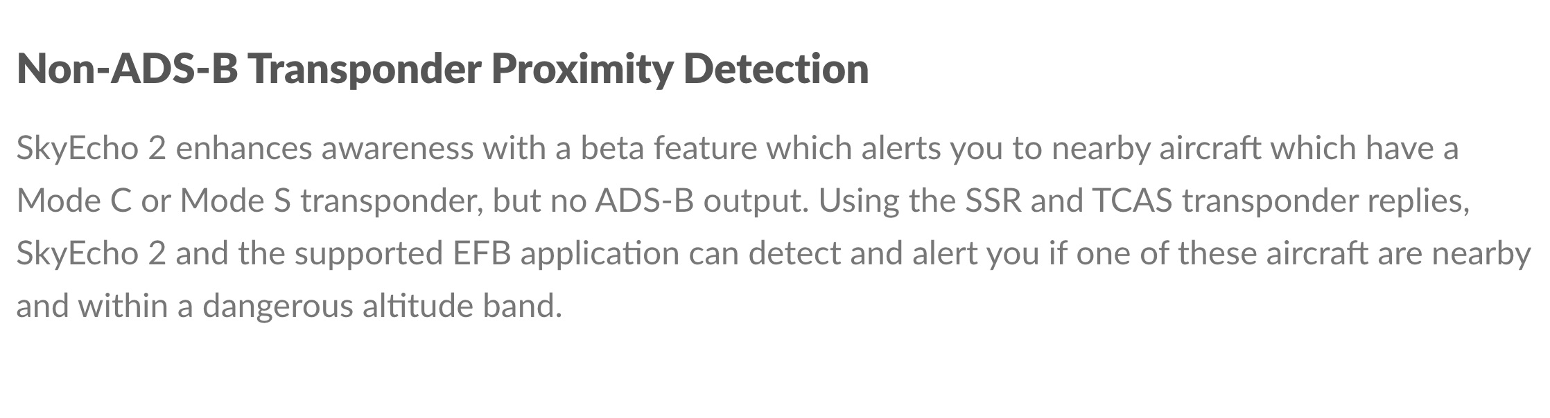

Garfly Posted July 28, 2020 Posted July 28, 2020 I've read that the SE2 will be seen by all newer TCAS displays (albeit without triggering Resolution Advisories). And there are various other cockpit displays that will display ADSB (SIL=1 or above) traffic. But what I'm still interested to know is just how many of the commercial aircraft that we're likely to share airspace with actually are so equipped. In any case, with a SE2 we should be able to see them and ATC might be in a position to spot impending conflicts. BTW, this is an interesting SkyEcho2 'beta feature' mentioned on the website below that I haven't seen discussed elsewhere. https://www.unmannedtechshop.co.uk/product/uavionix-skyecho-2-portable-ads-b-transceiver/ 1

Kyle Communications Posted July 28, 2020 Author Posted July 28, 2020 Garfly there is a Flarm receiver that can also pickup mode C transponders and actually place them in spacial presentation to you on the flarm units screen. Its expensive though about 3.5k aussie. It does ADSB etc as well and it does the Australian Flarm frequency set
Garfly Posted July 28, 2020 Posted July 28, 2020 Yeah, Mark, I'm not sure how important the Mode C feature is, anyway. And it may never apply in Oz, Its ADSB-OUT ability is what's great and new - at this price. But as to the placement, you'd want to be able to check the status lights wouldn't you? And to be able to turn it off in flight, sometimes? I think its portability is a big feature around which it is designed.

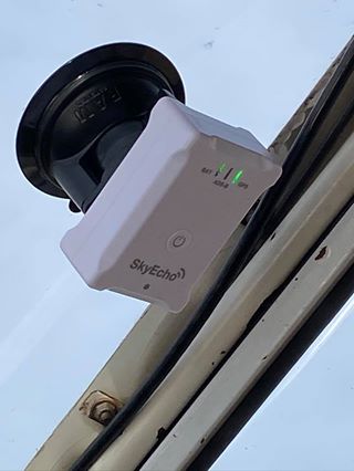

mkennard Posted July 29, 2020 Posted July 29, 2020 I placed mine on my rear window behind me. Might be better since I have a plastic plane but it showed up on AVPLAN no problem.
Kyle Communications Posted July 29, 2020 Author Posted July 29, 2020 Yes will be ok for a plastic fantastic but a all aluminium and steel cage is a whole different matter That external antenna mod is looking better and better I have to say the CASA rego office to get your hex number is on the ball....I got mine literally in 2 hours from the first email to them 1 1

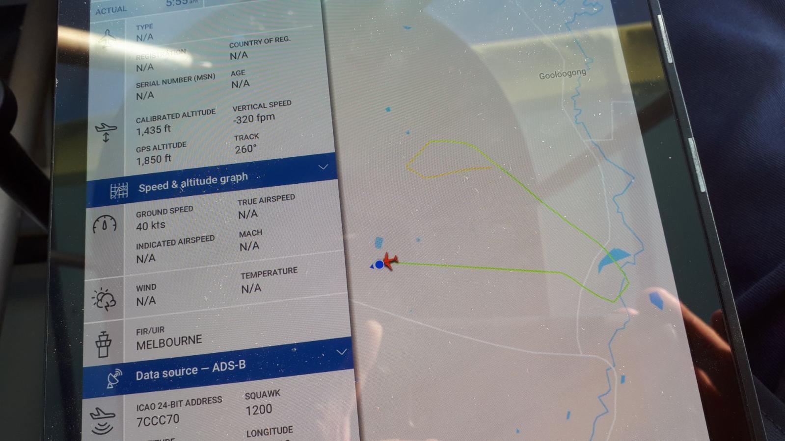

Thruster88 Posted July 30, 2020 Posted July 30, 2020 First fly with the SkyEcho2 in the Thruster. Appeared on fr24 while taking off, very impressed. The icon looks more like a jet than a Rxxxx aircraft, not sure how that works.
Garfly Posted July 30, 2020 Posted July 30, 2020 Thruster, I see it reads your ICAO address but what about your rego? I know that's just FR24 but I wonder if, say, a typically equipped Dash 8 or air ambulance could match up your paint with your radio calls.
Thruster88 Posted July 30, 2020 Posted July 30, 2020 (edited) Garfly said: Thruster, I see it reads your ICAO address but what about your rego? I know that's just FR24 but I wonder if, say, a typically equipped Dash 8 or air ambulance could match up your paint with your radio calls. Yes the rego in the required form Rxxxx was showing. As for radio on a flight like this I would not be making any calls, if we all did the airwaves would be jammed. Occasionally C130, toll rescue heli and other aircraft fly in "my" airspace, I can now see them and they can see me. Hopefully a lot of VFR aircraft get onboard with EC devices. Edited July 30, 2020 by Thruster88 2
Kyle Communications Posted July 30, 2020 Author Posted July 30, 2020 If you contact CASA I think it is the rego place and tell them its the wrong icon its a jet not a light aircraft
Kyle Communications Posted July 30, 2020 Author Posted July 30, 2020 Coming up straight away on FR24 means you must be close to one of the ADSB ground stations
Thruster88 Posted July 30, 2020 Posted July 30, 2020 Kyle Communications said: Coming up straight away on FR24 means you must be close to one of the ADSB ground stations Yes Mt Canobolas is 35nm away, can see it from the farm.
Kyle Communications Posted July 30, 2020 Author Posted July 30, 2020 Well that explains it....do you have a map of where all the ADSB reciever sites are?
Thruster88 Posted July 30, 2020 Posted July 30, 2020 Kyle Communications said: Well that explains it....do you have a map of where all the ADSB reciever sites are? https://www.airservicesaustralia.com/projects/ads-b/ads-b-coverage/ Scroll down to the bottom.
KRviator Posted July 30, 2020 Posted July 30, 2020 Kyle Communications said: If you contact CASA I think it is the rego place and tell them its the wrong icon its a jet not a light aircraftThe icons on FR24/FA bear no relation to what you transmit for ADS-B. The reason it shows as a Jet - the same as my RV-9A did - is because it cannot correlate the Rxxxx rego with a database containing the aircraft type, so it assumes a Jet. CAsA / ASA have nought to do with it. 1
