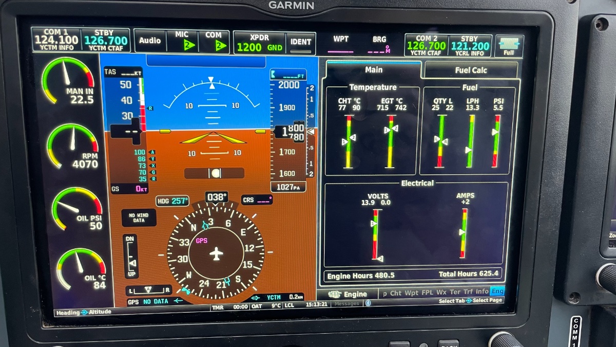

Ok. Some further info lads.
I have been flat out and so only just managed to get on to this now.
I still have the CHT issue. So I swapped the sensors and the problem remain unchanged.
Pulled the plugs and found passenger front (closest to prop) both top and bottom are black.  Rear passenger are a nice grey. Swapped plugs around and problem remained.
Did full leak downs. All perfect.
All cables are good.
The sensor on the side that has the black plugs is reading high temp.
Only other choice now is to check floats and sync carbs.
But it’s got me beat.
Any ideas?

Update - SOLVED.
So sometimes you can’t see the forest for the trees. The problem was staring me in the face and I could not see it.
I decided to just go back to basics and look at what in the system can cause a mixture issue. The very first thing that came to mind was the choke. So I tested between full choke and no choke and found that the choke was binding and not returning to min.
It would appear that the Lame that did the last 100 did not lubricate the throttle components.  I also found the idle mix screws to be way out.  Once I fixed that and lubricated all linkages, the problem is all but gone. The CHT are within 10c of each other.
I have now synced carbs and once the weather clears will test fly. 4000rpm runs shows no black plugs anymore.
one thing this taught me.  When I do my daily I always check throttle travel and choke engagement, but realised I never checked the chokes had returned to minimum. It’s now on the list.
Problem solved and lesson learned. Win win.
