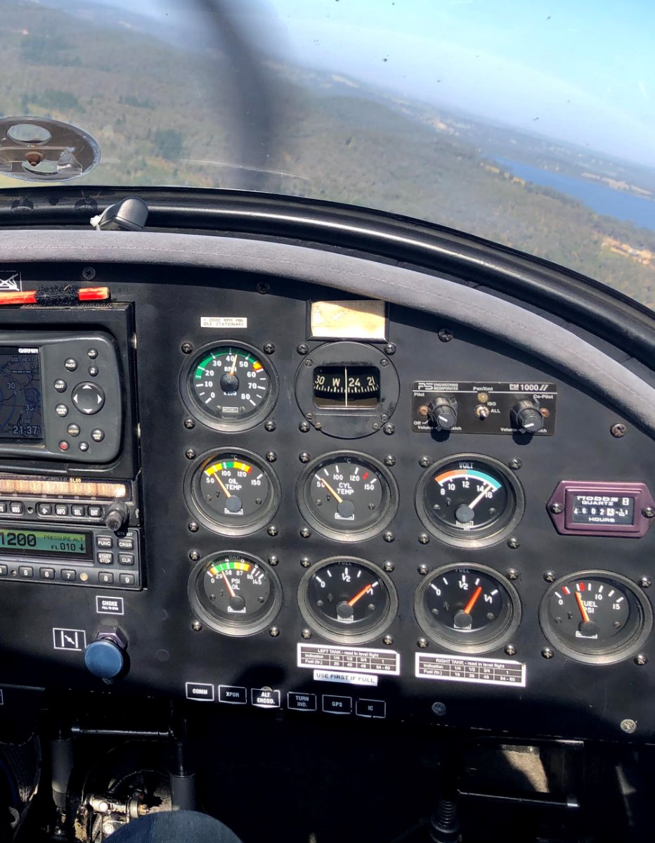

RossK Posted December 15, 2021 Share Posted December 15, 2021 Here's our panel mounted one, I have no idea of the make etc, looks like the Airpath. Seems to point north when i'm lined up on 36 at YLIL. Link to comment Share on other sites More sharing options...
skippydiesel Posted December 15, 2021 Author Share Posted December 15, 2021 Thanks RossK - How old ? and any complaints? and is it about 50mm? Link to comment Share on other sites More sharing options...

RossK Posted December 16, 2021 Share Posted December 16, 2021 (edited) 20 hours ago, skippydiesel said: Thanks RossK - How old ? and any complaints? and is it about 50mm? Skip, it's the 57mm one, unsure of manufacturer though. age, 14 years according to the maintenance logs - ie it's the original one fitted. I check it as part of my pre-flight routine during taxi and line up. Only used it once during flight to verify that the Aspen PFD was having a bad day, once. It confirmed that the Aspen was telling me lies. But I also have an Ipad, a Garmin 296 and my mobile in the plane, so plenty of redundancy. Edited December 16, 2021 by RossK 1 Link to comment Share on other sites More sharing options...
