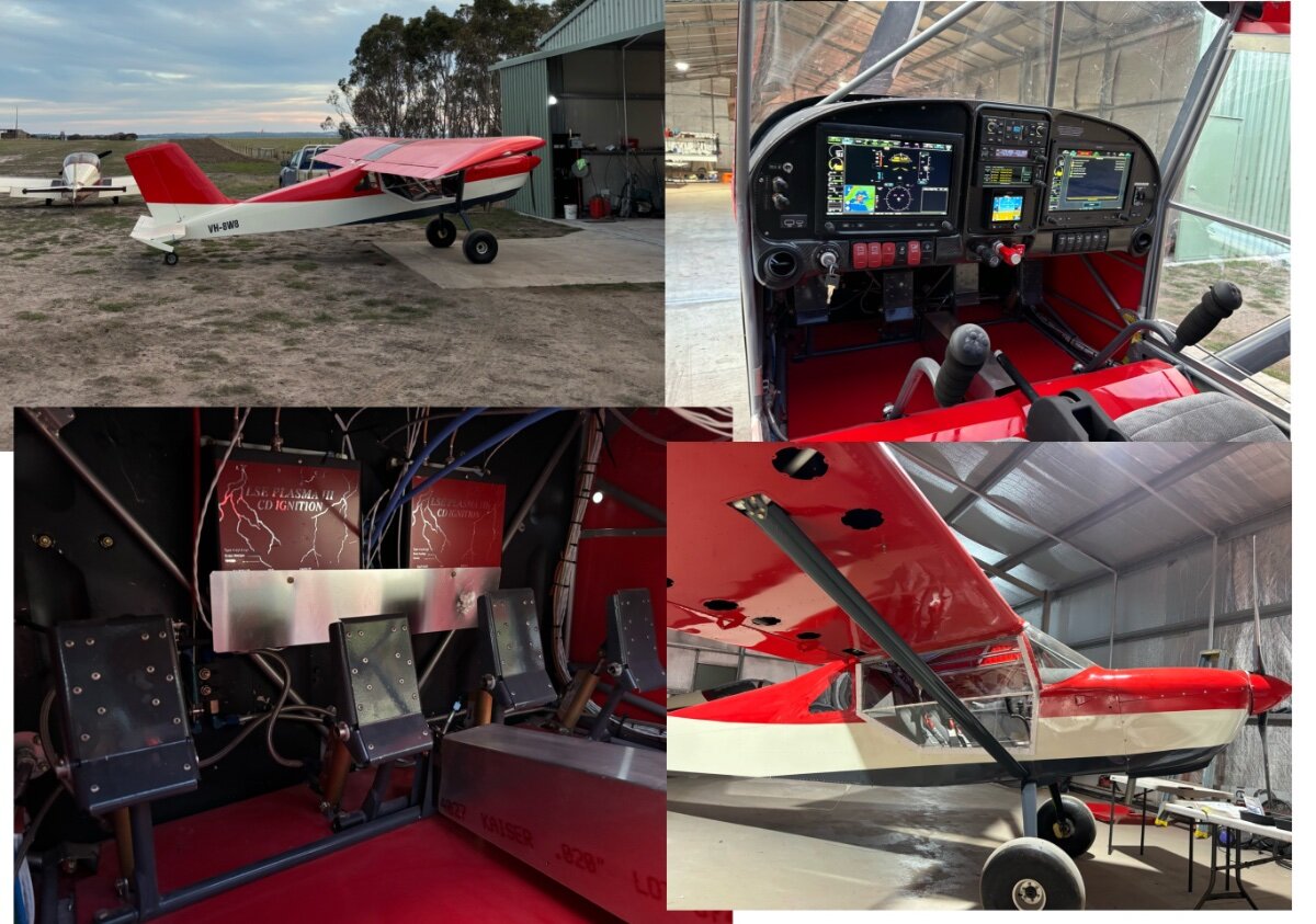

Aircraft 2.
We have motor and avionics sorted. Tomorrow is taxiiing and going through the avionics on the G3X such as checking radios, magnetometer etc. Big deal to close the boot cowl and limited access to the wiring. So, getting it as right as possible now is essential.
whirlwind prop is a drama. I’ll post about that once sorted. We’ve had some failures in S21’s related to the 3/8th bolts. It’s a bit like the Jabiru saga with 3/8th and upgrade to 7/16th. I’ll start with the 3/8ths and expect or hope for an upgrade kit with 7/16th prop lugs and bolts.
After boot cowl closed we are onto windscreen, sunroof and engine cowl. That’s it.
So… maybe 4-6 weeks to flying subject to paperwork.
5kw wind turbine to follow. Aircraft takes priority over the turbine patent.
Pic yesterday front and back and picking up Deb for a trip in the RV6. The cows hardly move for take offs and landings. Have to sort of land between them. Cow poop on the new aircraft will be annoying. But.. when going away such as trips back to USA I realise how damn good it is to have your own runway and just wheel it out and be in the air in a few minutes. Warm up is the slowest part of proceedings.
