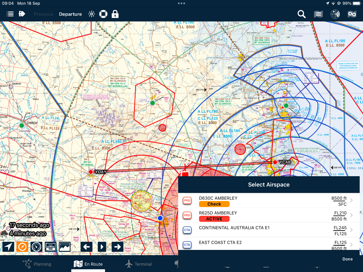

In the planning stage now. Probably Saturday dep.  BUT looking at the map around Brisbane, What a mess of Military and controlled airspace. How the hell does one find a way through that lot.  We're looking at a  route
Tooradin-Wang-Temora-Narromine-Dalby-Caboolture. Over two days weather permitting. Can anyone tell us the best route to negotiate Controlled and Military airspace on the last leg.
It isn’t as bad as it looks! http://aussieadsb.com/airspaces Just take the time to identify what is relevant and the lower altitude of each section of restricted area. Easier on weekends.
This is old but the general explanation may help http://redcliffeaeroclub.com.au/files/AMB12nov15.pdf
 More info here https://www.casa.gov.au/search-centre/stay-ontrack-flying-gold-coast-region/general-military-information#RAconditionalstatuslegend
Give RAAF a call at your planning stage, they will appreciate it https://www.airservicesaustralia.com/wp-content/uploads/VCA-Hotspot-Amberley-flyer.pdf

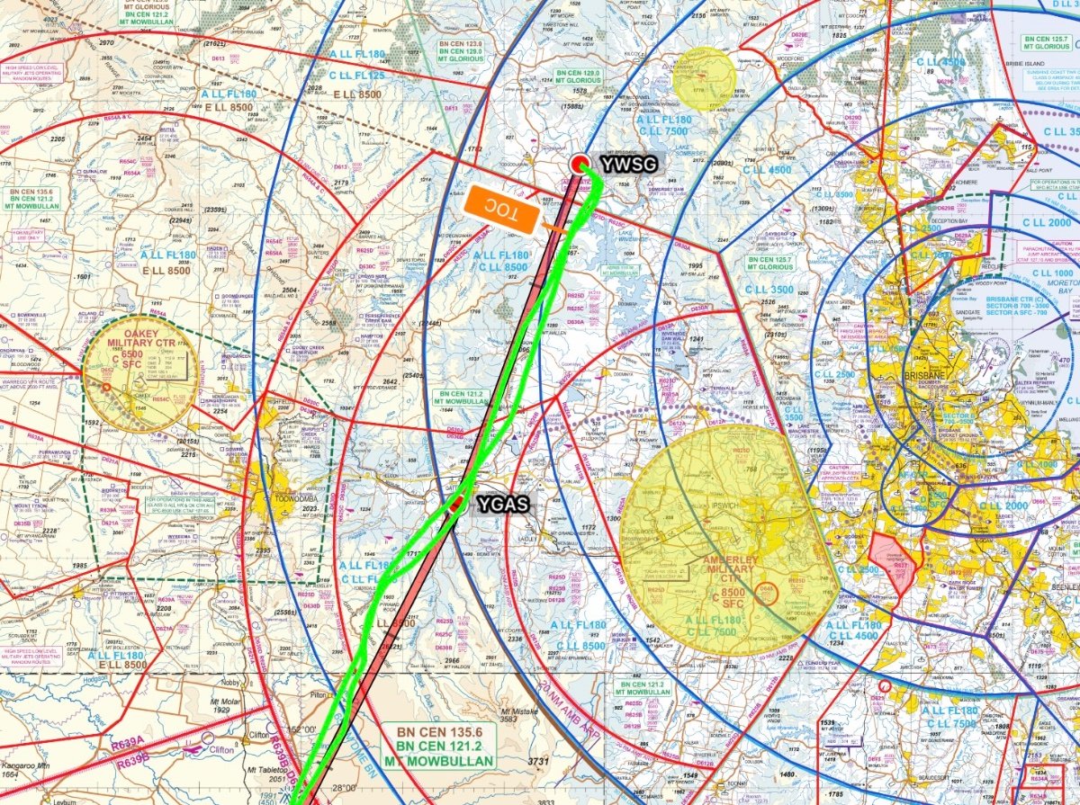

I recently flew Melbourne to Watts Bridge and return. That leg was Gunnedah to Watts Bridge, however on quite a few previous trips I have stopped at Moree.
Fairly straightforward from Watts Bridge part of the world to Caboolture however a busy area.
You’ll be fine at a weekend. The RAF never work weekends!
just talk to BN CN 121.2 when you depart Dalby (on the ground if you wish) - let them know your intentions and they will tell if you need to talk to Approach should the area be active. Stay on freq and they’ll guide you right up to Somerset Dam.
