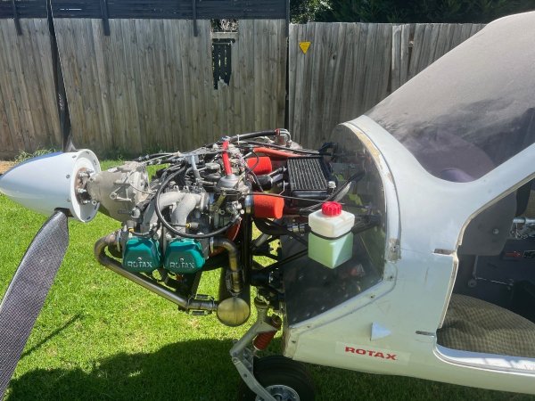

GolfWhiskeyHotel Posted March 23 Share Posted March 23 OK, so two years and $45000 later , We have a flying ( under a special temporary C of A. ) Rotax powered J160. Now approaching 40 hours of faultless operation. All within 50 miles of home! The aircraft is also deemed so unsafe as to not qualify for RAA insurance coverage , It was reported to me that " Examining Engineers" cant even be çertain that the thrust line is correct! (The elevator trim lever remains in the original position ) The aircraft is thus unregisterable under all present groups ( 24, 19 ect ) .... It appears that a major fault was not providing identities and details of similarly powered Jabirus. Plus wandering too far from the original spec. (Also a major sticking point. ) I did make appeals to people with Rotax/Jabs on here and other forums..... . But only a single photo or spec sheet was forthcoming. I had a couple of promises and some knockbacks. one positive result, not enough .... The RAA of course MUST know who built them and have photographic evidence. But they don't share. As things stand I CAN fly the Jab, within a 50 miles radius. Within a temp C of A ....But there are no circumstances or pathways to registration ATM. Thus flying further than I can see is not possible. To say I am disappointed would be the understatement of the century. at 77 years old 2 years is a big chunk. My immediate instinctive response is to burn the Jab and L2 cert. and walk away. It's unsaleable and I cant afford another. .... I am trying to find a positive. Not there yet..... Flying is still flying. The point of this all.? BEWARE OF MARAP. You can invest Lots Of Time and Money and have NO control. 1 Link to comment Share on other sites More sharing options...

skippydiesel Posted March 24 Share Posted March 24 GWH - You should be commended on such a nice neat/clean installation. 1 1 Link to comment Share on other sites More sharing options...

GolfWhiskeyHotel Posted March 24 Author Share Posted March 24 31 minutes ago, turboplanner said: The thrust lines can be measured on the finished aircraft using plumb bobs and datums. We did that when building the engine mount!...to no avail. If the thrust line was out more than a couple of mm's the trim would require alteration shirley, plus the prop shaft would rub on the cowl. Link to comment Share on other sites More sharing options...
