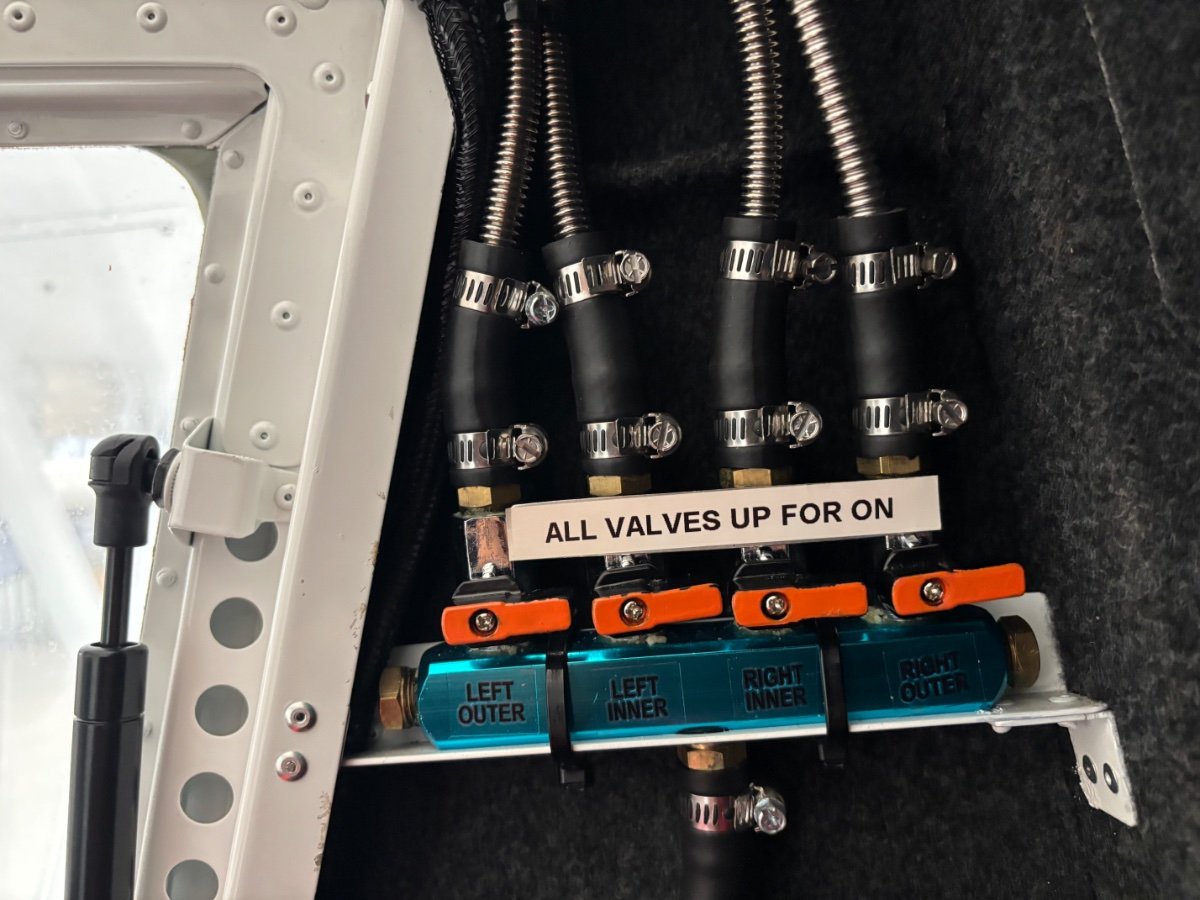

Marty_d Posted Tuesday at 07:55 PM Posted Tuesday at 07:55 PM Have a look at @Kyle Communications build logs, he did the four hose/tap into one manifold method and I believe he's very happy with it. 1

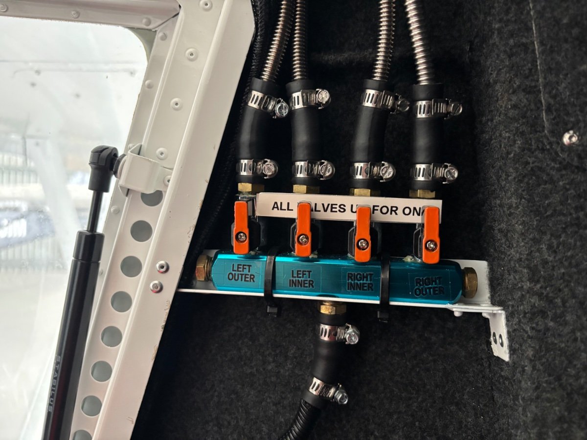

fallowdeer Posted Tuesday at 10:06 PM Posted Tuesday at 10:06 PM I pretty much copied Mark Kyle and IBob. . After 140 hours in nine months, I’m really liking the flexibility of having four individually valved tanks. 2

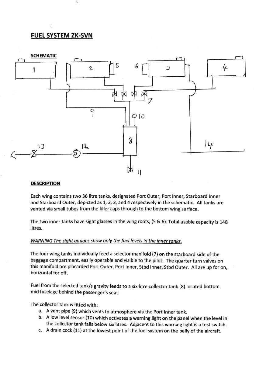

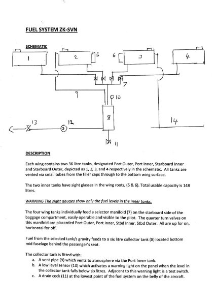

fallowdeer Posted Tuesday at 11:59 PM Posted Tuesday at 11:59 PM Hi James When my aircraft was inspected by the CAA they pored over the fuel system in great detail. As the POH and the build manual contained no information about a four tank system I had free rein on the design. As previously noted lots of pitfalls exist in the operation of a multi tank system so I had created the attached document and included it in the POH. This seemed to alleviate the regulator’s concerns. I frequently start up with all fuel valves off at the manifold looking for the low fuel light to come on after using about 100ml of fuel this testing the system as against the button on the panel which is only a bulb test. From experience in normal cruise I’m able to drain any tank completely with the exception of the R/H inner that the return goes to. 2

IBob Posted Wednesday at 11:49 PM Posted Wednesday at 11:49 PM (edited) While my knowledge of fuel systems is limited, it seems to me that the Savannah setup is very well thought out. And for an aircraft of it's size and type, the receiver tank is an integral part of that. It acts as a buffer, effectively guarding against fuel starvation due to momentary unporting of the tanks. And it gives many minutes of warning of fuel exhaustion. The only provisos there are that the level switch providing that warning can fail: that being the case, there is a real advantage to having valving from all wing tanks, so allowing routine ground testing of that switch. And the panel indicator can fail: there is a test button allowing routine testing of that, and in the interest of reliability the incandescent indicator supplied can be changed for a (flashing) LED indicator. Edited Wednesday at 11:55 PM by IBob 1

IBob Posted Thursday at 03:46 AM Posted Thursday at 03:46 AM If going to the 4 valve setup as described by fallowdeer above: The rationale for having all 4 valves on the RH fuse wall is to allow the PIC to easily see and reliably operate those valves at any time. However, this mean running the feeds from the LH tanks to the RH side of the fuselage. If doing this, ensure there are no undulations in those pipes, as any high spots may contain air, which the fuel must makes it's way past. My understanding is that most multi-tank setups may experience uneven feeding from L and R tanks, for a variety of reasons. I had uneven feeding until I removed undulations from those pipes. The result is still uneven, but now far less so. (I should add that at no point did uneven feeding affect engine performance.)
